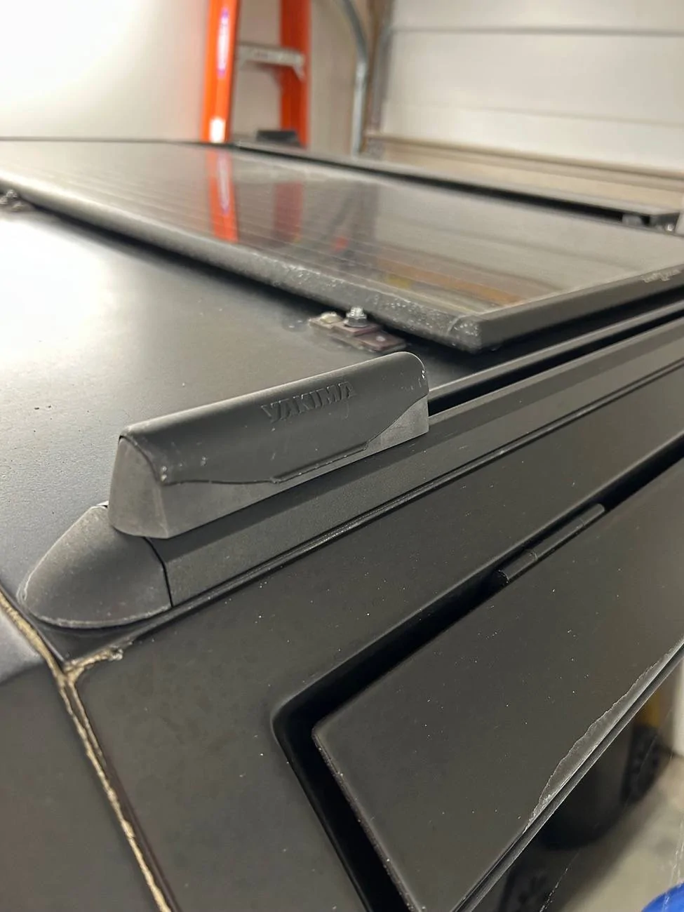

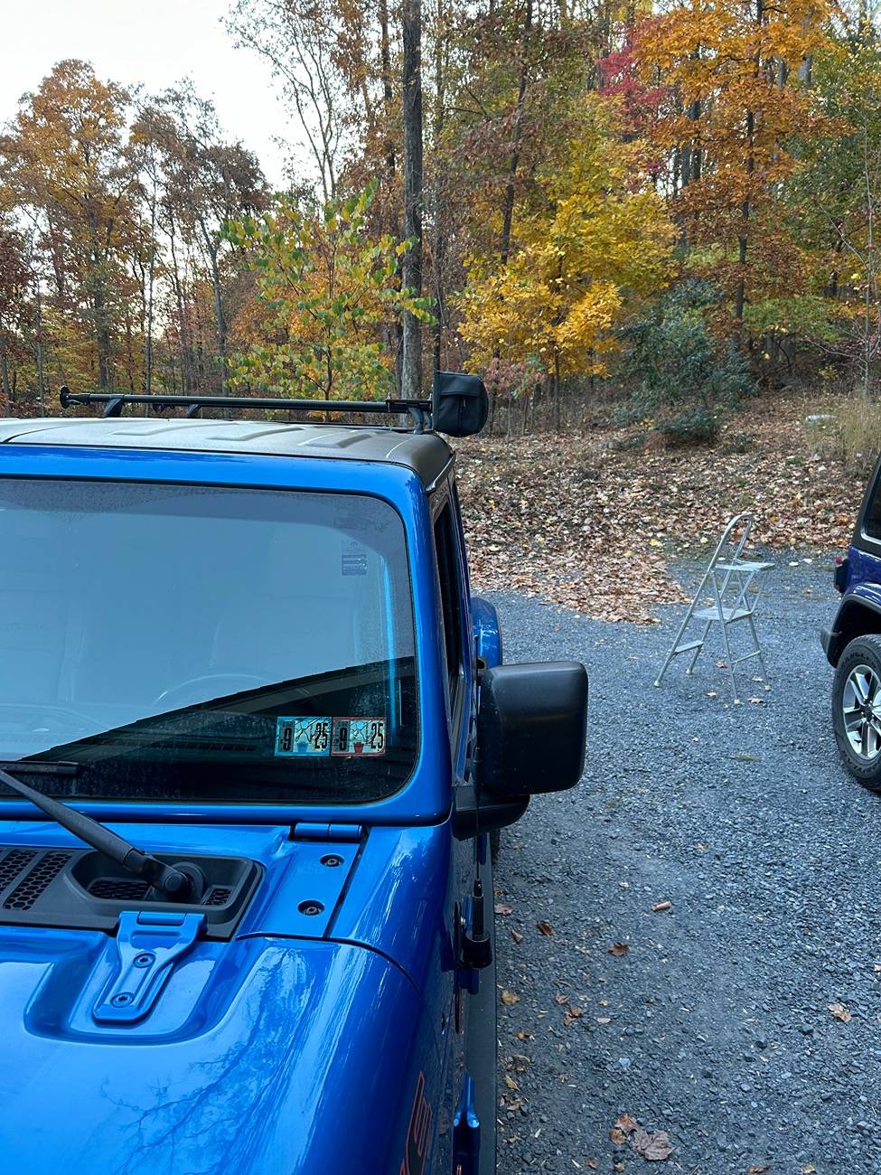

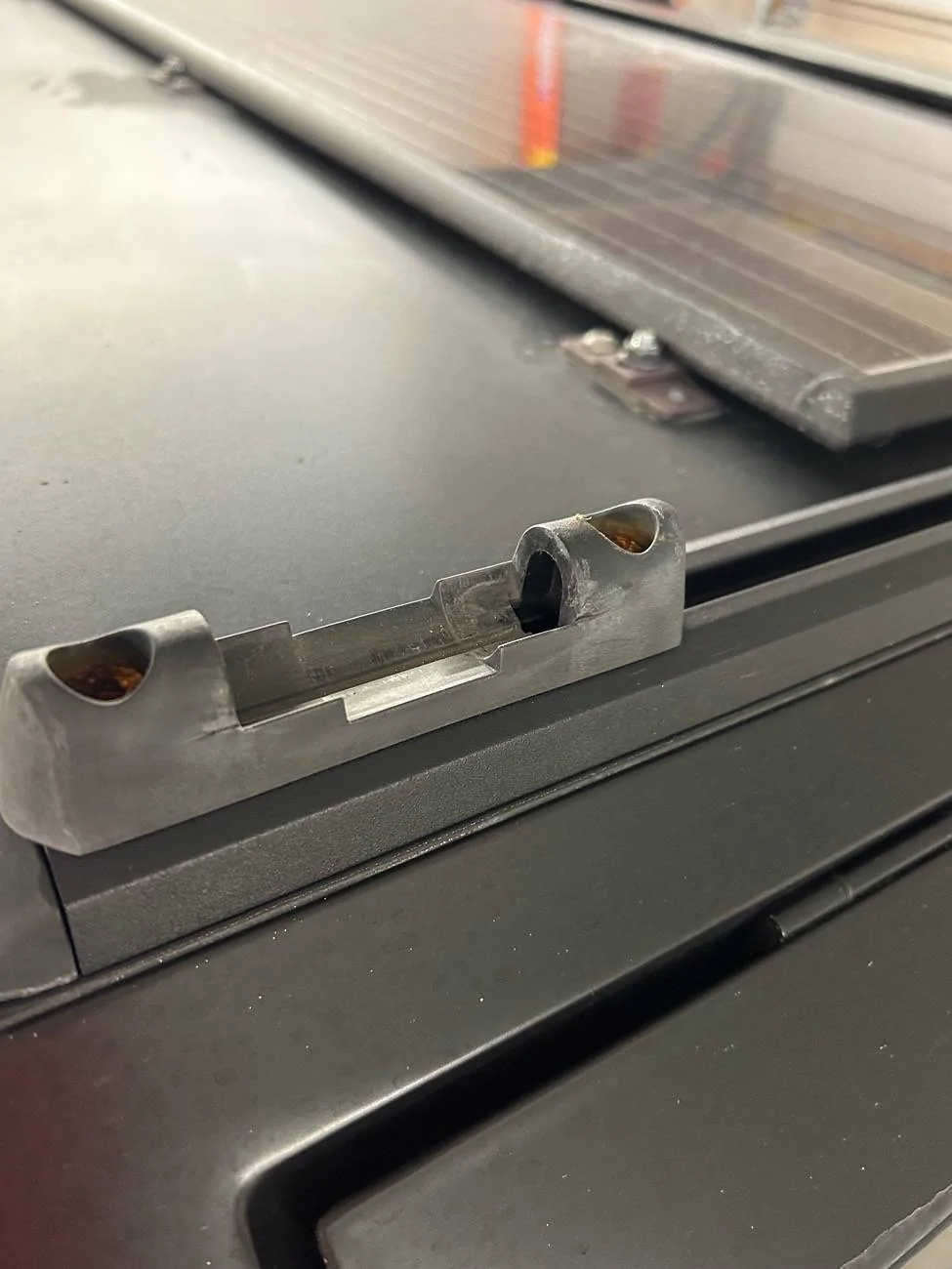

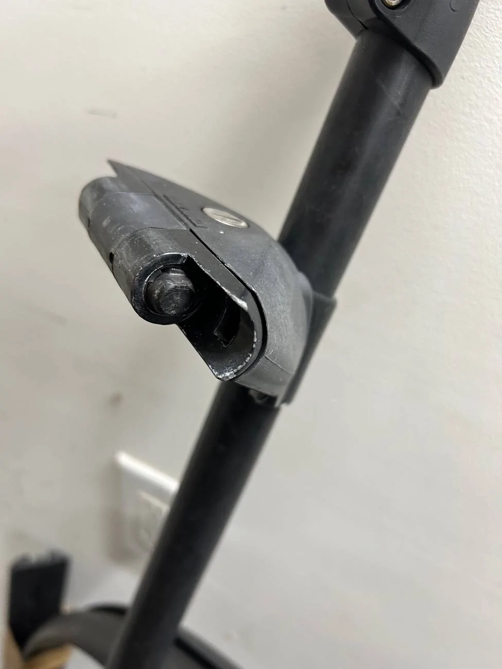

I have the smart cap and it is solid , I have carried two Native Propel kayaks at 34” wide at the same time , and have delivered a couple 13’ Native Kayaks in past. Only picture I have in phone of my Yakima round bars with removable control towers, on the passenger side the round thing on the end of the bar is a boat loader that is steel rod 36” long that helps load kayaks, I have two boat loaders so I can pull them out a bit to carry two large kayaks once in a while.
I love the round bars these started life with me on a 2013 Silverado and have been on a few trucks before glady. I myself would not put the weight of front of kayaks that have the wind lift on them on the Jeep hardtop. Also getting three or four bars to sit at same height is hard to do……Jack

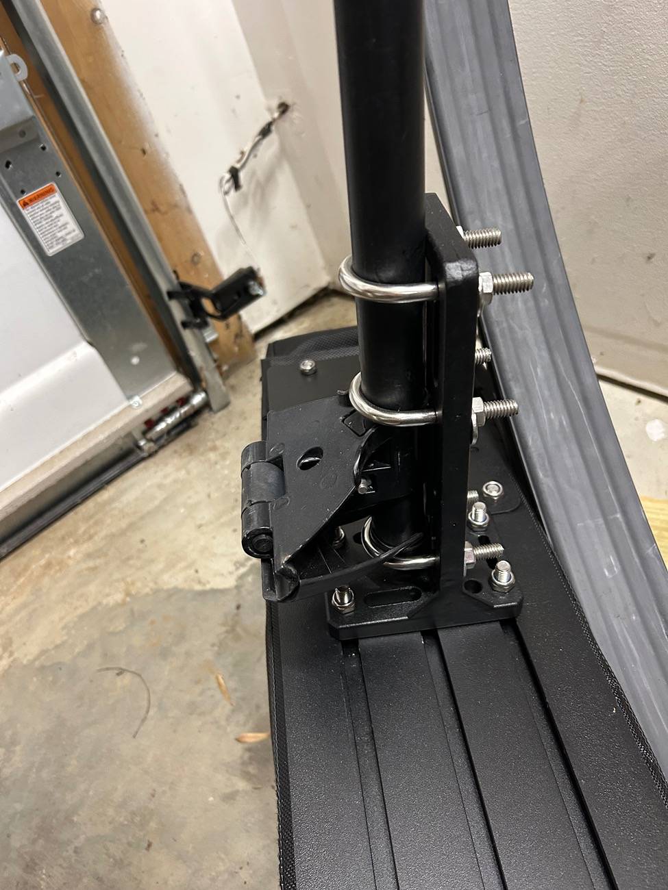

How are you attaching the round bars to the SmartCap?

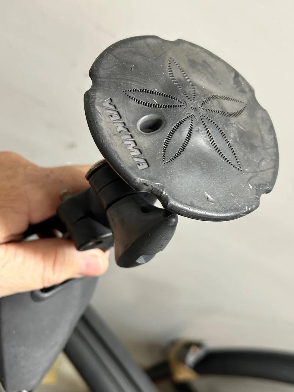

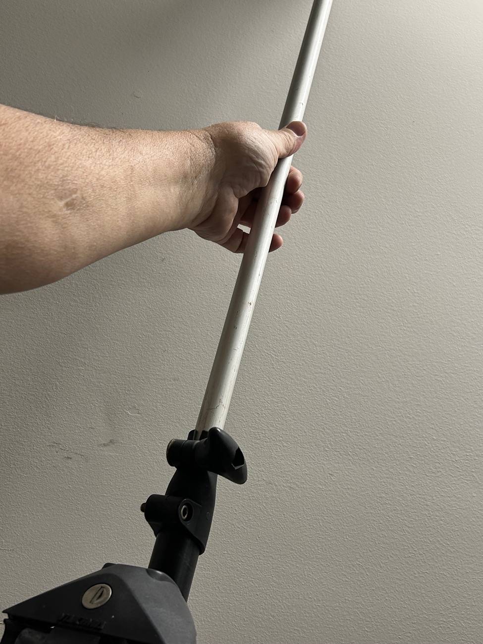

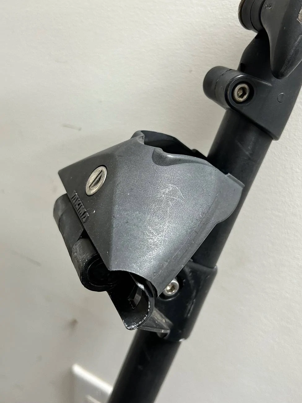

Couple pic, mount with cover for when not in use , boat loader is an amazing option, both for loading kayaks and for making my rack wider at times, also photo of my 270 awning mount on the round bars. I gave. It looked in a long time not sure if round bars, control towers and mounts are still avalible. They make a heavy duty bar but not sure which ones have boat loader. Loading a kayak with the boat loader is easy and we loaded two Native Propel 13’s up there already and they are around 95 pounds with wheel kits. In the past on my suburban these same exact bars had five 11 OK Tridents them with a center poke to stack them vertical. I have rod holders , bike holders and lumber braces. The one nice thing or bad thing with round bars is things can spin on them like my surf rod racks when driving long distance without rods I can tip them horizontal….Jack
