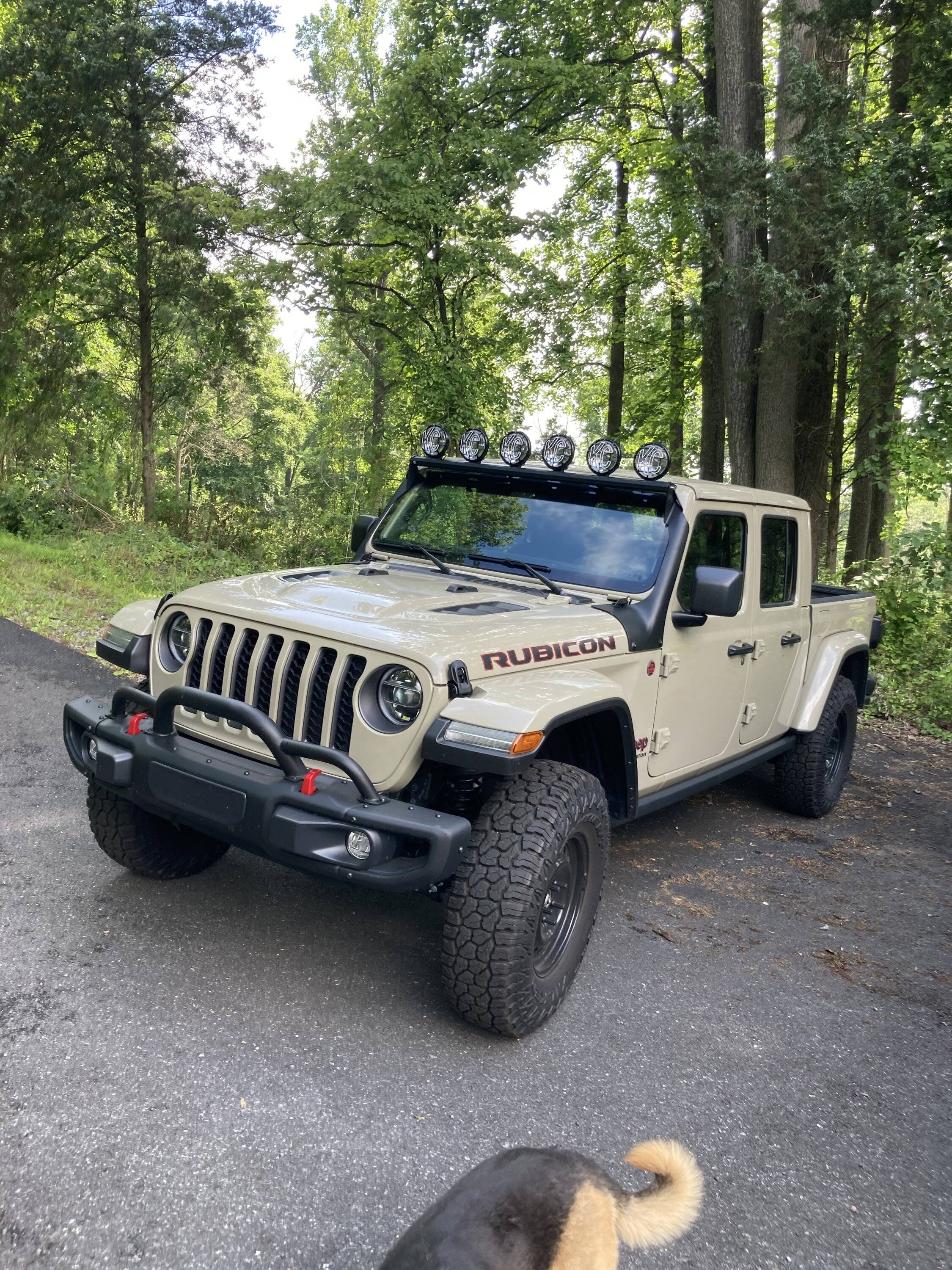

Ok so installed the light bar with 6 KC Apollo Pro Halogen lights, I have the tails at this point hanging to get some questions answered, i have the factory aux switches under the hood so I was thinking to wire all lights together than run one wire down to the aux switch wire but then I started thinking, the box states the lights are 100w with an 8.3 amp draw. So if I have 6 can I not wire them to one 40 amp switch? What would be the best type of connector in back of the light bar to connect all 12 wires and the 12 or 10 gauge down to the aux wires? Lastly is this too much light, I mean should I split up the outside lights etc.

8.3A x 6 = 51.6 amps. That's effectively 20% +/- more then that single switch is rated for. You're going to have to split the load over 2 switches, there's no real way around that. No need to burn your truck or wiring down for simplicity.
8.3 x 4 = 34.4amps - X O O O O X
8.3 x 2 = 17.2amps - O X X X X O
So my solution/recommendation is, the 4 middle lights on one switch and the 2 outbound lights on another switch; as displayed above.
