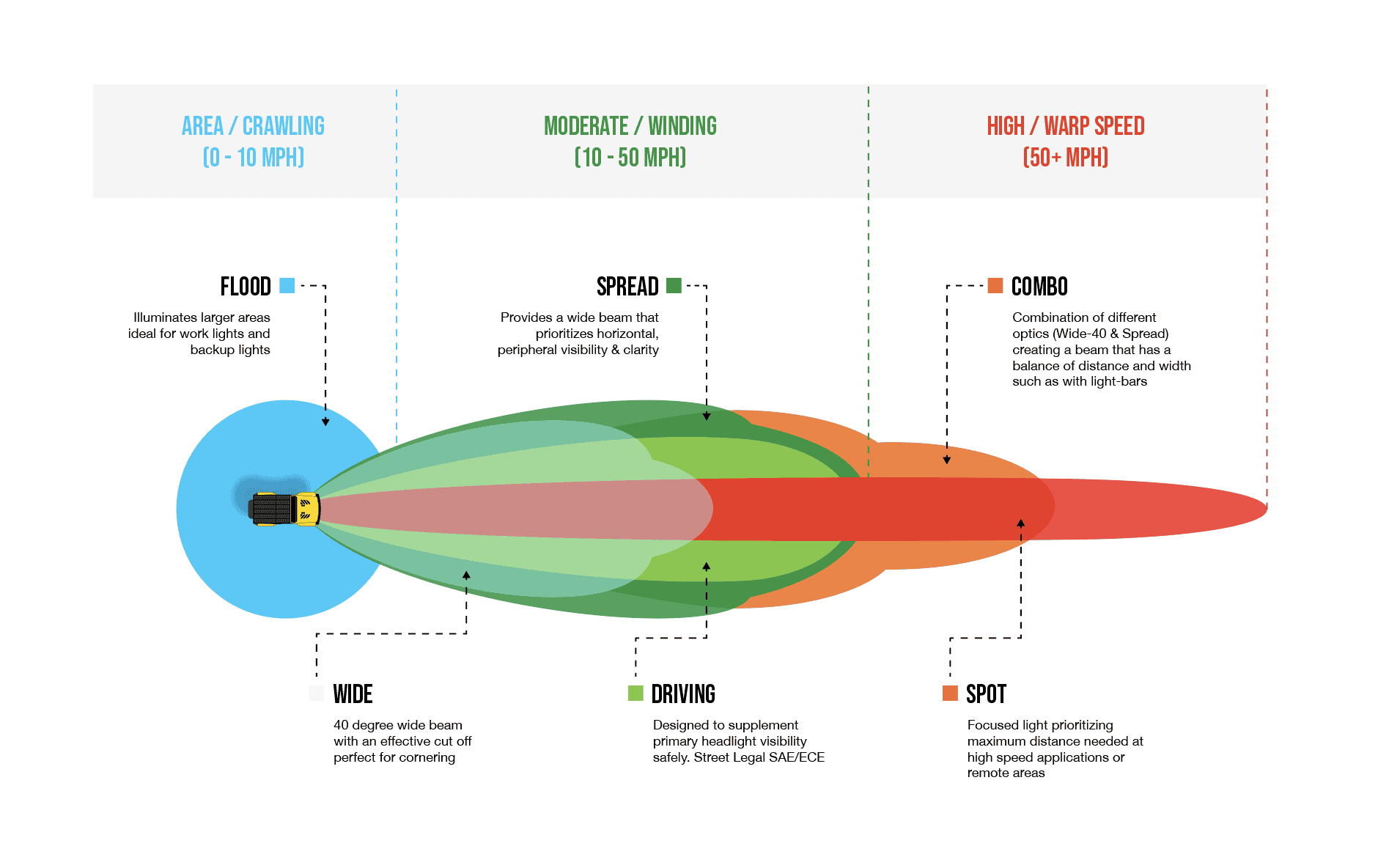

I put KCs on my A pillar with spot beams and I still get some hood flash
I also have a basic light bar on my front bumper with a combo spread/spot pattern and it honestly defeats the purpose of the spots. I add them for extra light when its really dark but at the end of the day I'd be fine with just the light bar
Next Jeep I will just do lights on the front bumper, and will do some kind of combo or driving light beam
If I was you, I'd start out with a pair of the Pro 6s you want in the Wide 40 pattern and if you want more light add another pair in the driving or spot pattern
This graphic is helpful from their site

Thanks. You guys have me thinking I should go back to original plan and put them on the bumper. Appreciate it.
