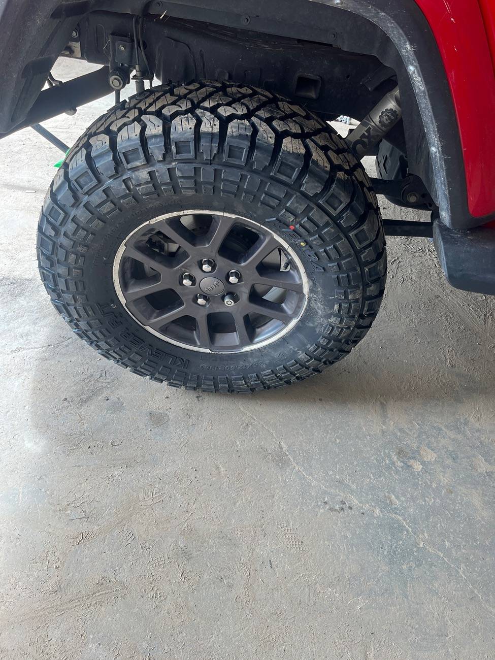

Hello! I have a 2020 Rubicon with about 38K miles. At 28K I had Kenda Klever R/T mounted and an alignment done. They are Lt 35 x 10.5. No lift on the truck. The front two tires are now almost entirely worn out - unevenly - mostly on the inside of each. The rears have almost no sign of wear. The alignment is still good and, according to the shop, all suspension components are good. Has anyone else experienced this and any ideas for avoiding it in the future?
Thanks!
James

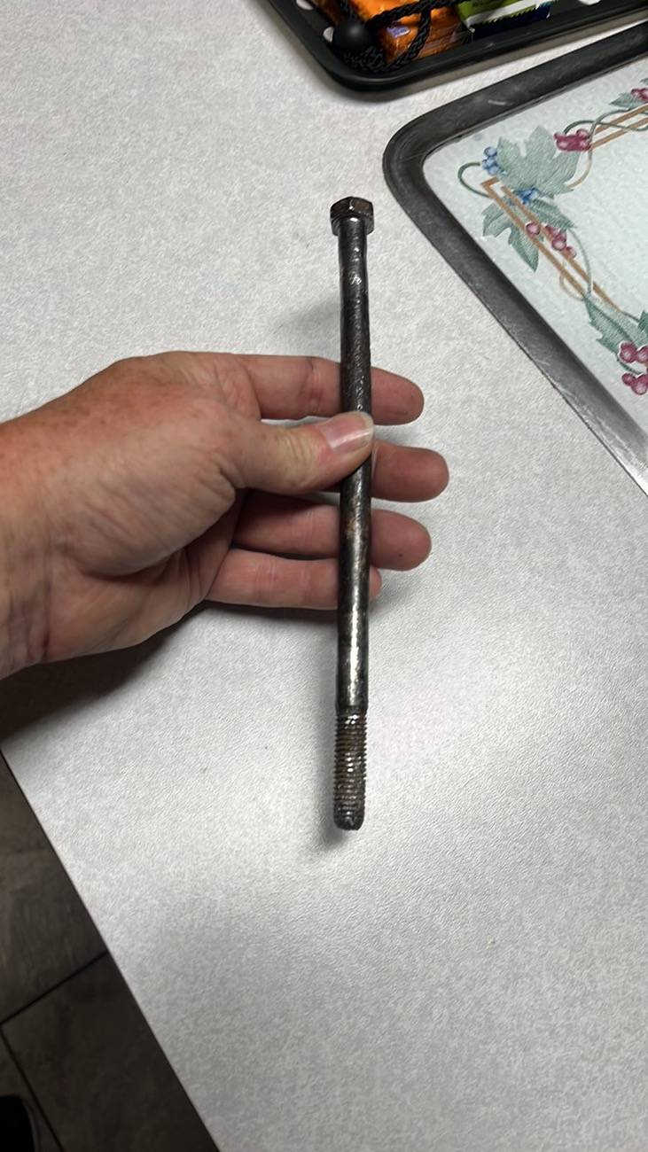

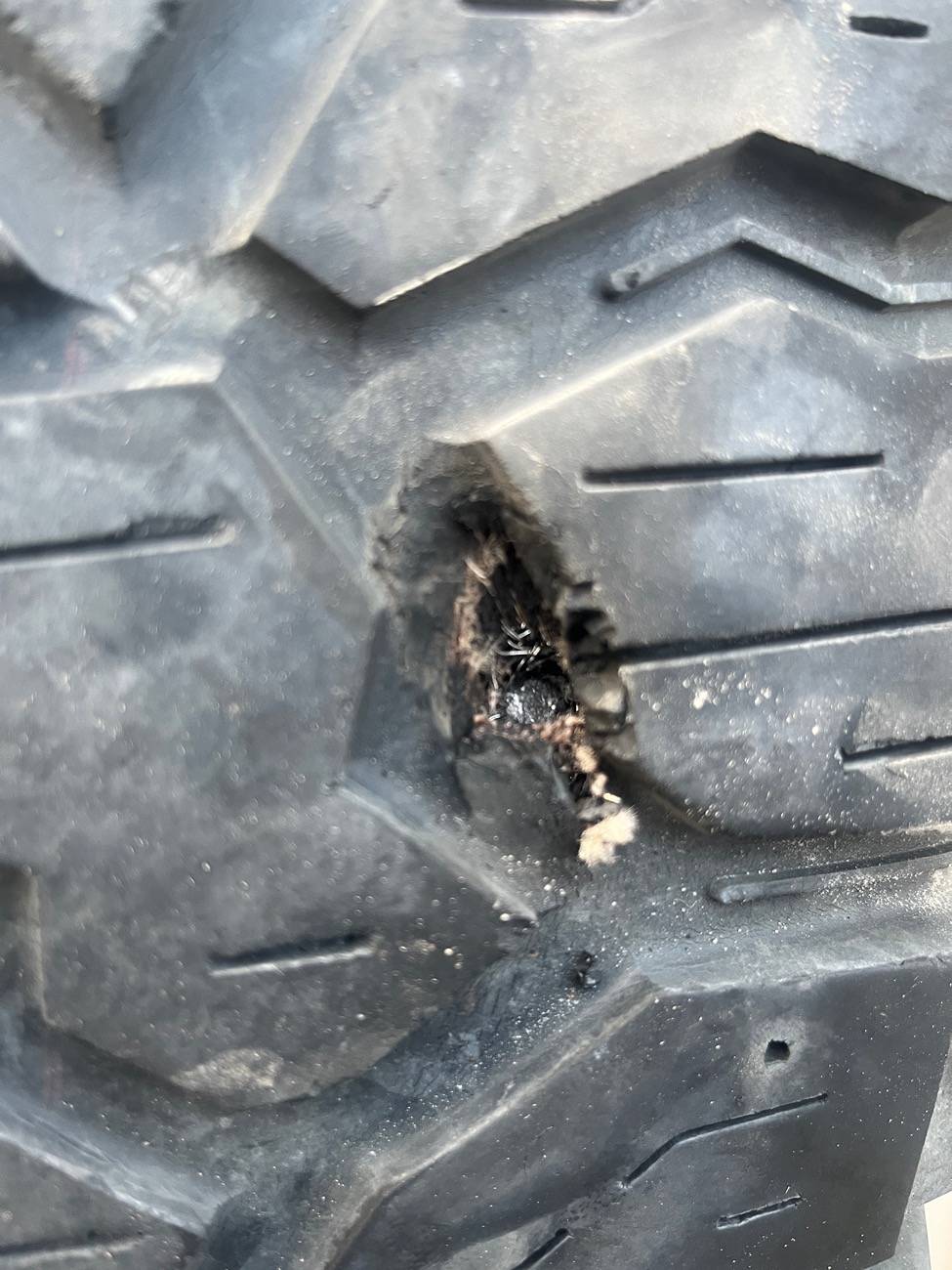

I had almost 60,000 miles on mine with no problems. Until I found this on the road. I did a tire rotation every oil change. Kenda R/T 35X 12.5. I bought the same again.
Jeep Gladiator Kenda Klever R/T Front - Extremely Premature Wear 1724859663205840
Jeep Gladiator Kenda Klever R/T Front - Extremely Premature Wear IMG_6848
Jeep Gladiator Kenda Klever R/T Front - Extremely Premature Wear IMG_6857
