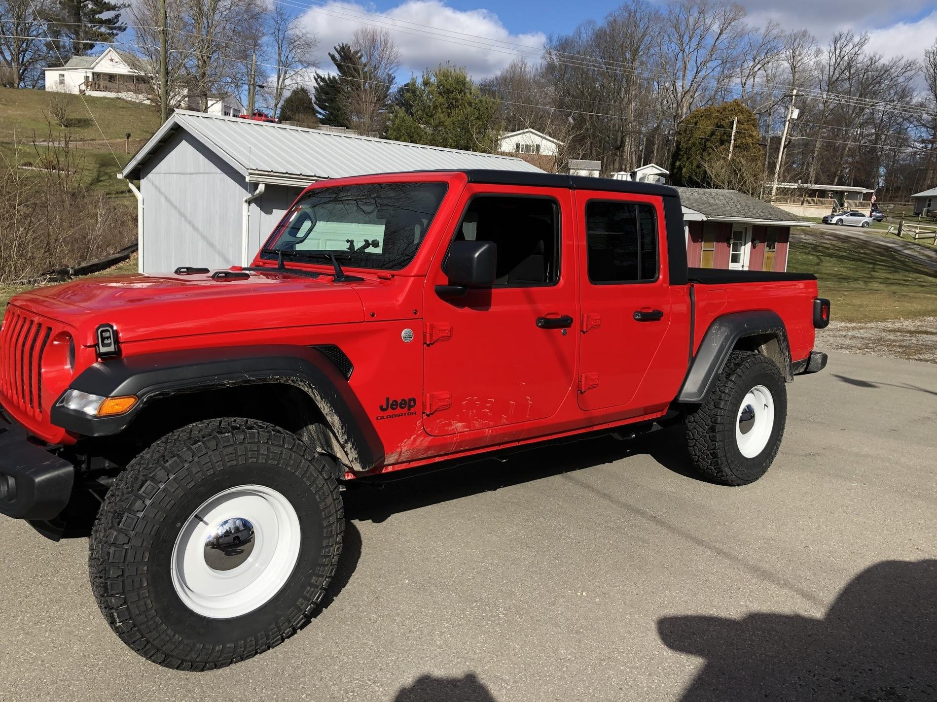

Just picked up a set for my Max Tow at Walmart for $283/tire.
Jeep Gladiator Kenda Klever R/T KR601 35x10.50R17 PXL_20260312_190322275.NIGHT~4
Jeep Gladiator Kenda Klever R/T KR601 35x10.50R17 PXL_20260312_212059902
Jeep Gladiator Kenda Klever R/T KR601 35x10.50R17 PXL_20260311_192302833.MP
