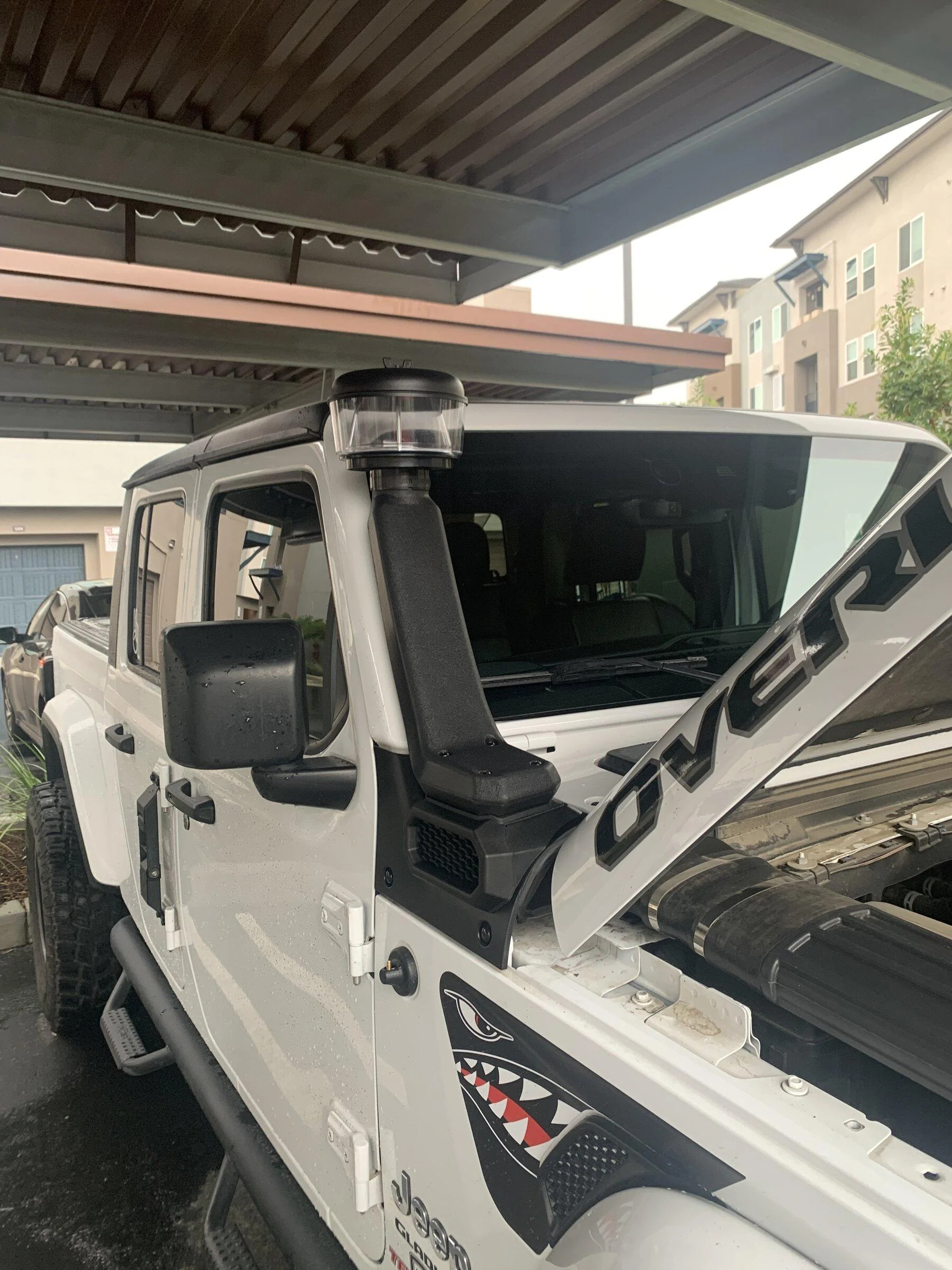

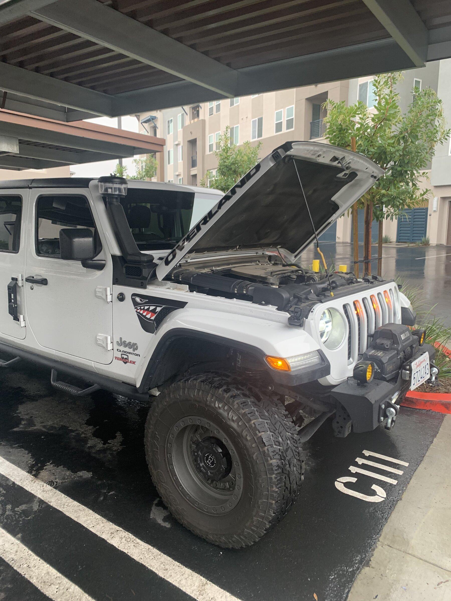

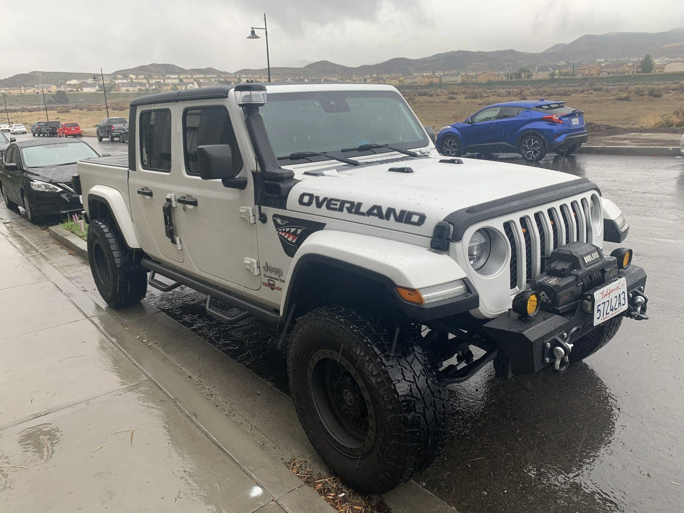

Installed one of these today. For $154.50 I figured why not. The fit and finish is commensurate to the reviews I’ve read for the RR.
Jeep Gladiator Knock-off Amfib Snorkel C20CAC2B-5098-416B-BD94-DD271829064A
One deterrent from looking into the install previously was the grille removal. With my winch butted up against it, that wasn’t an option. If you’re forceful enough, you can get the right angle to remove the radiator support with the grille on.
Jeep Gladiator Knock-off Amfib Snorkel 713940B1-AE55-42CC-9D6E-4DC93A415373
When I installed my switch relay box I purposely kept it off to the side where the normal mounting location is on the fender by the battery. I did this just in case I ever went the snorkel route.
Jeep Gladiator Knock-off Amfib Snorkel B7F7A781-566B-4AF9-BBCA-4A038C51DB91
All buttoned up.
Jeep Gladiator Knock-off Amfib Snorkel FB97C42C-A493-4C29-974C-93613989470C
Jeep Gladiator Knock-off Amfib Snorkel 4C14B1E6-A9A5-4025-8883-D451D5BCF810
