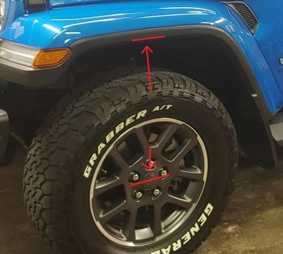

Here's what I did to determine how I wanted things to sit/look -
I measured like I always do - from the center of the wheel to the lip of the fender flare and made note of that measurement.
I then placed a floor jack under my front receiver (you can use a wood block under the bumper, but the idea is to raise only the front end of the truck, not by the front axle)
I manipulated the jack height until I got the look I wanted, then measured between center of the wheel and fender flare lip again.
This way you can sort of "stage" it - get the look you want and then figure out how much spacer lift it will take to do it.

That's a smart move, pretty well calls out how much spacer you need. I'll try that. Thanks
