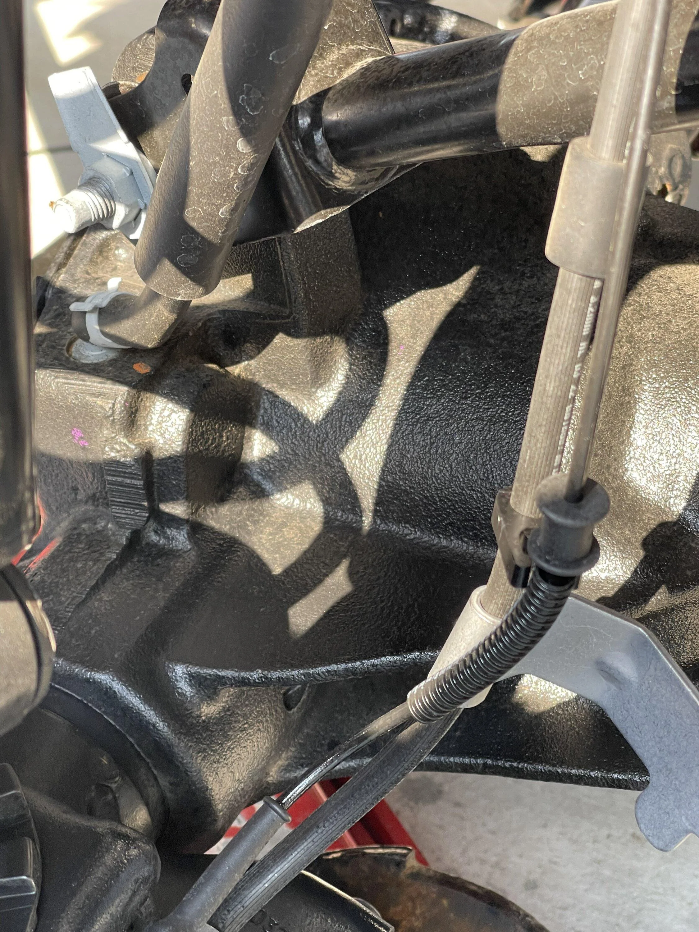

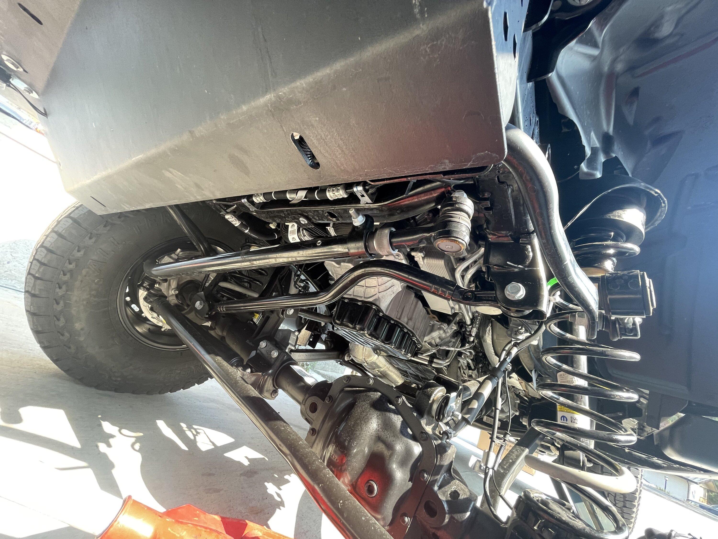

Jack the Jeep up by the frame enough to lift the tire off the ground. - this is important because performing this in the driveway you will need to droop the axle to remove the spring, do not jack the Jeep by the axle at this time. So, once the jeep is high enough to remove the tire- secure with a jack stand.
Remove the tire (one tire…)

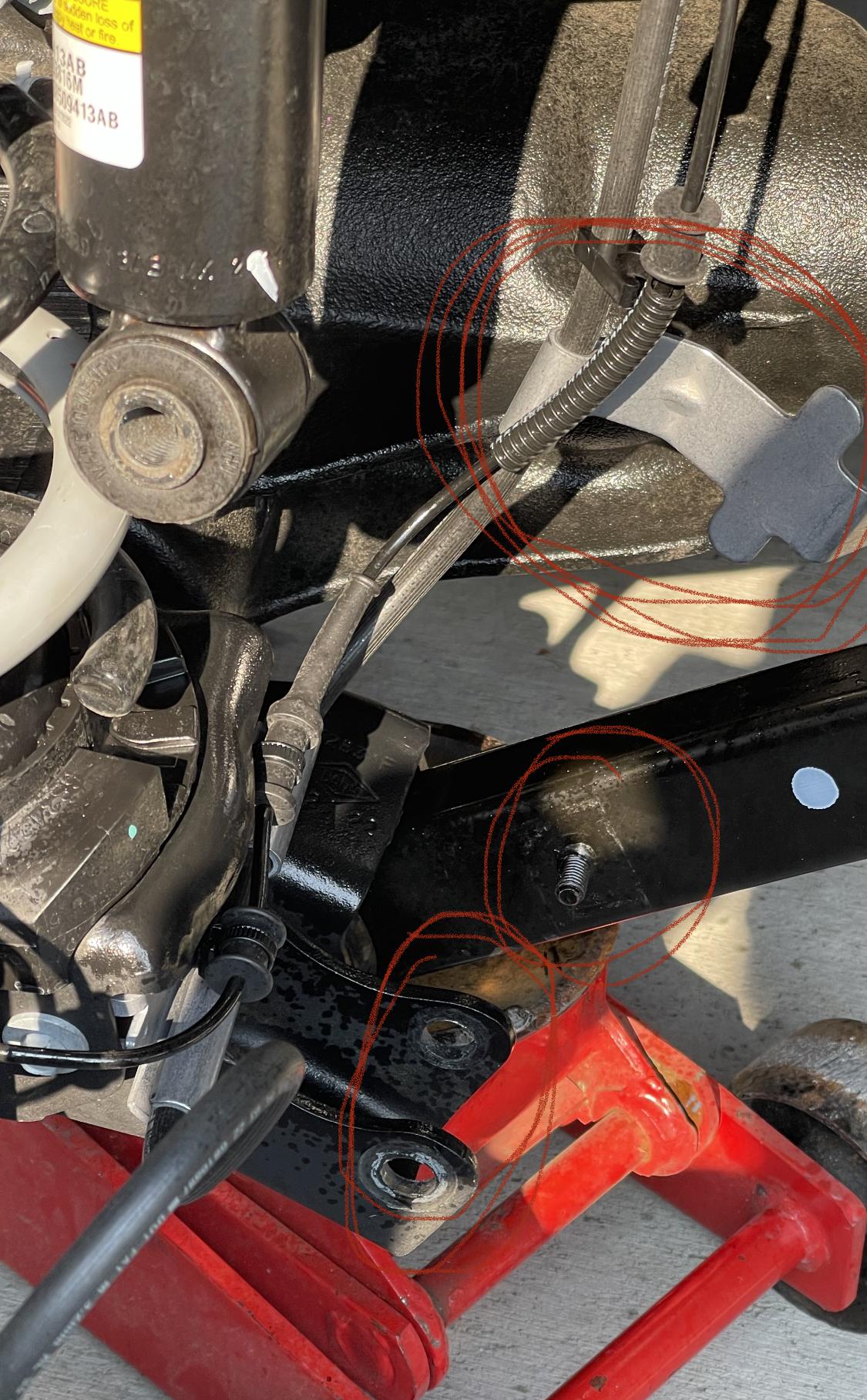

Place jack under the axle on the removed tire side. Jack the axle up- a couple pumps, looking to remove tension on the shock and sway bar.

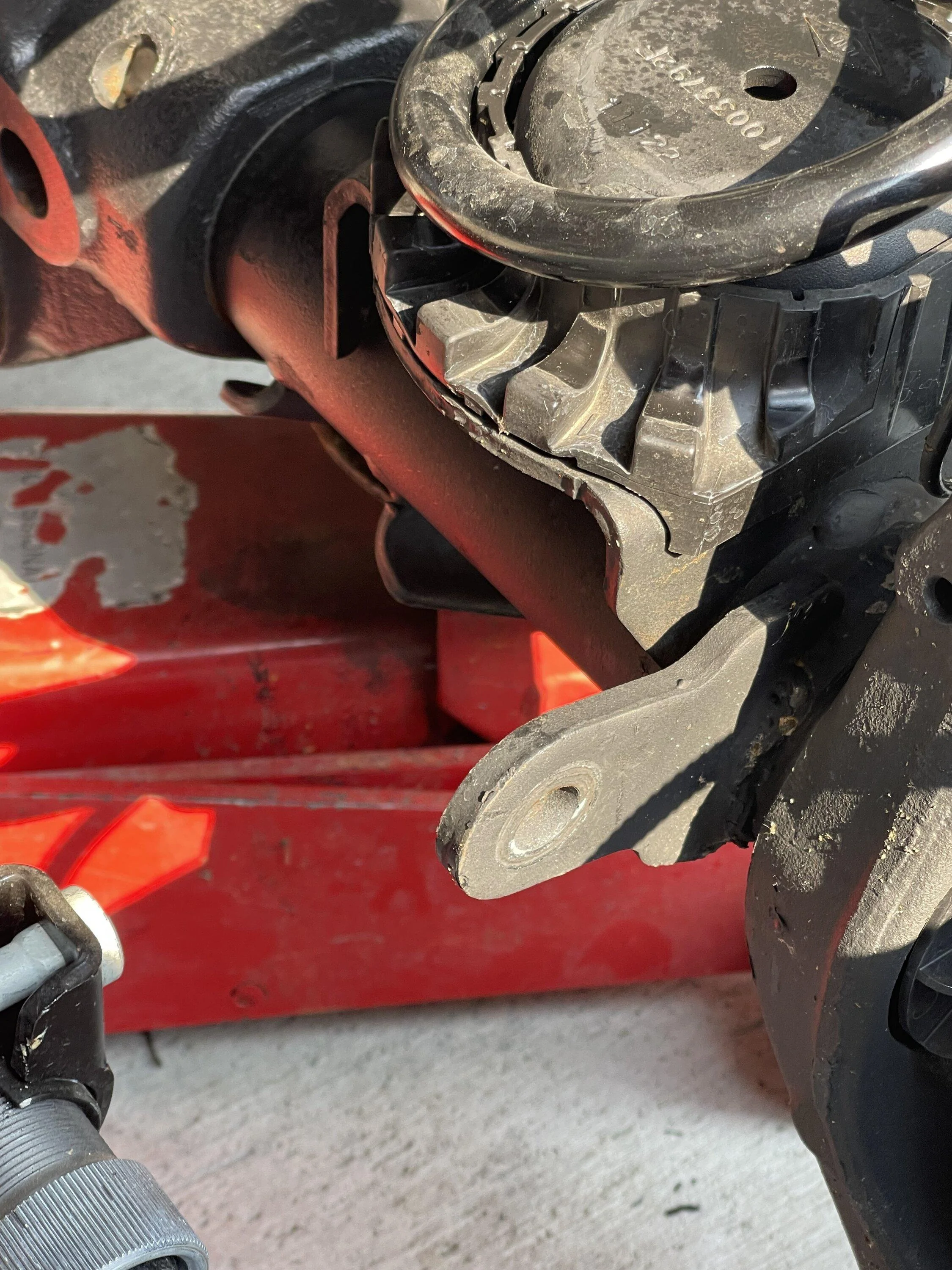

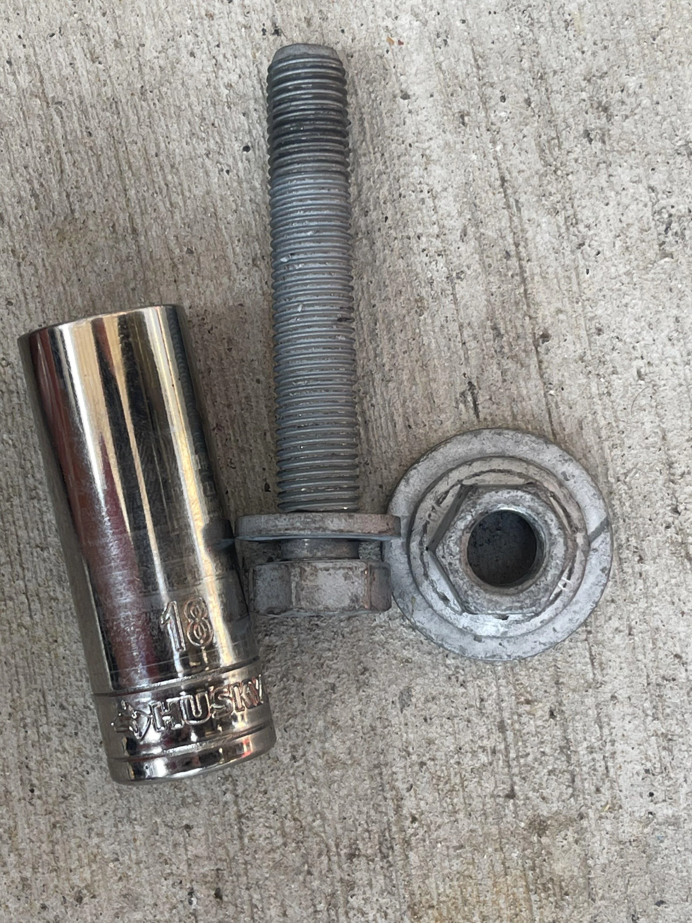

Remove sway bar end link bolt from axle bracket using an 18mm socket and wrench. Pivot sway bar end link away from axle.

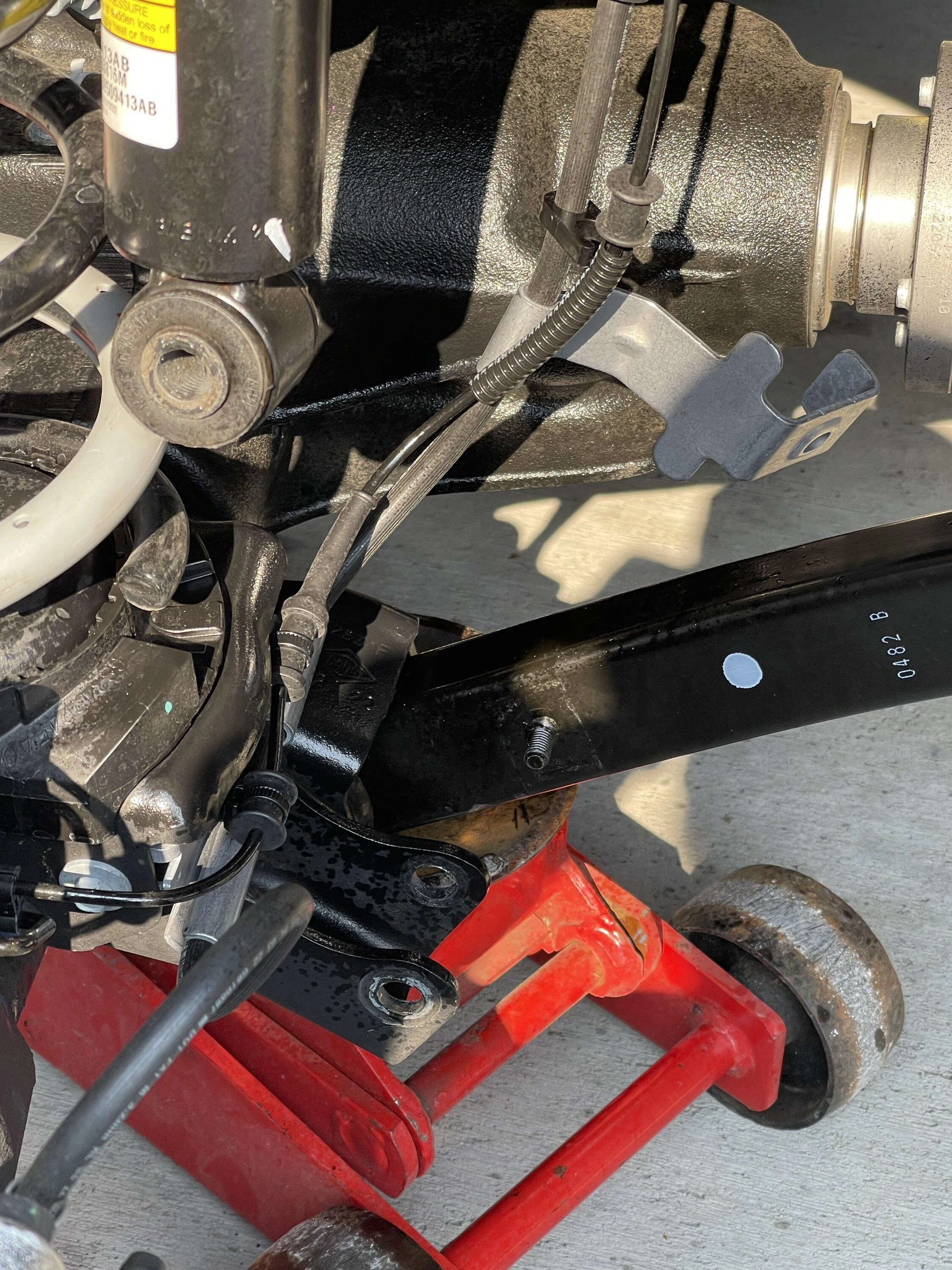

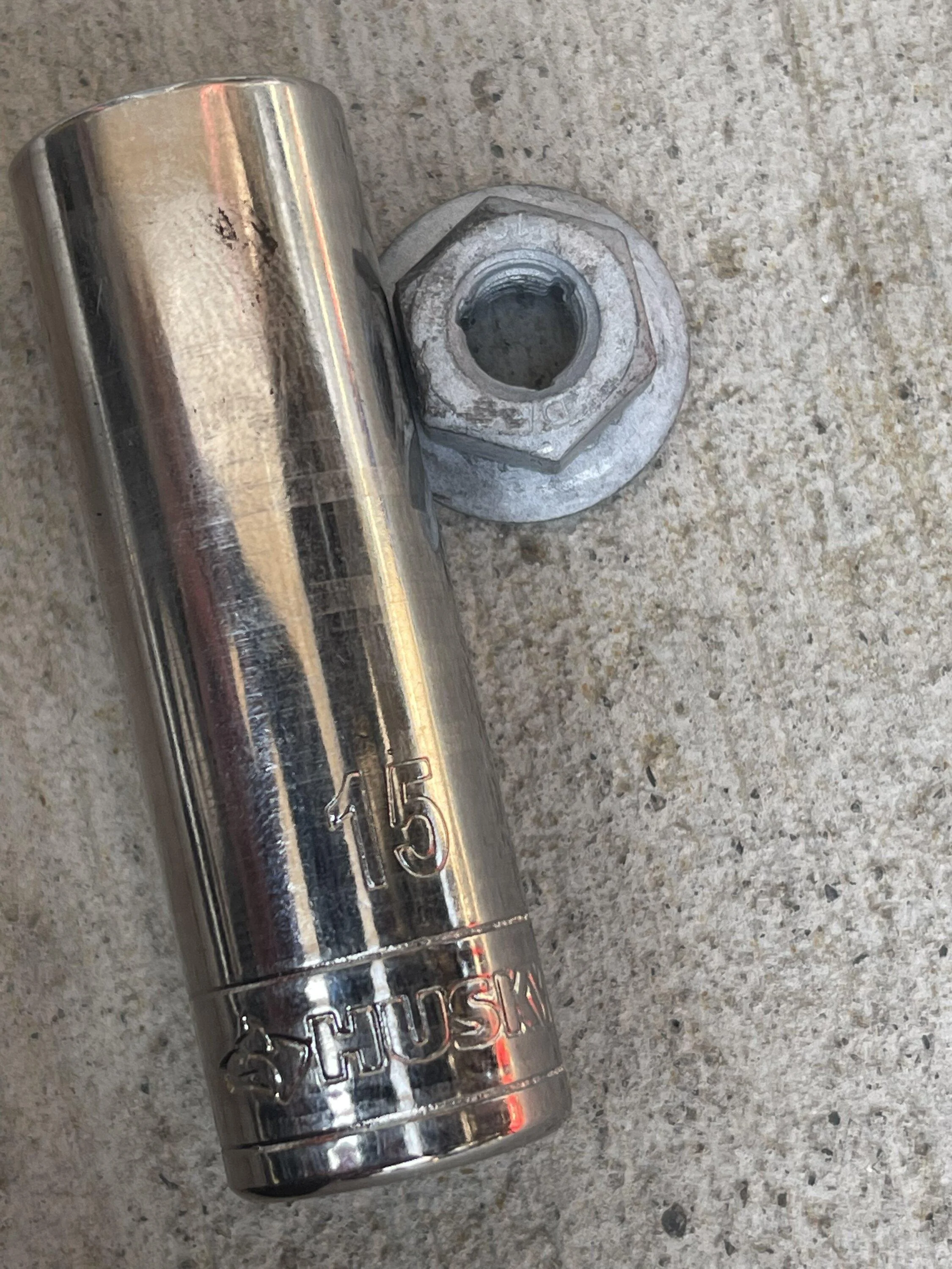

remove 15mm brake line bracket from control arm, and remove bracket (allow to sit freely above control arm and disconnected from welded bolt)
Remove 18mm lower shock bolt using a wrench and socket. Once removed pull shock from mount and allow to sit freely.
Lower jack supporting the axle slowly - ensure careful attention is made to brake line, differential breather hose, and fad/locker wires.
lower until spring can be worked free.

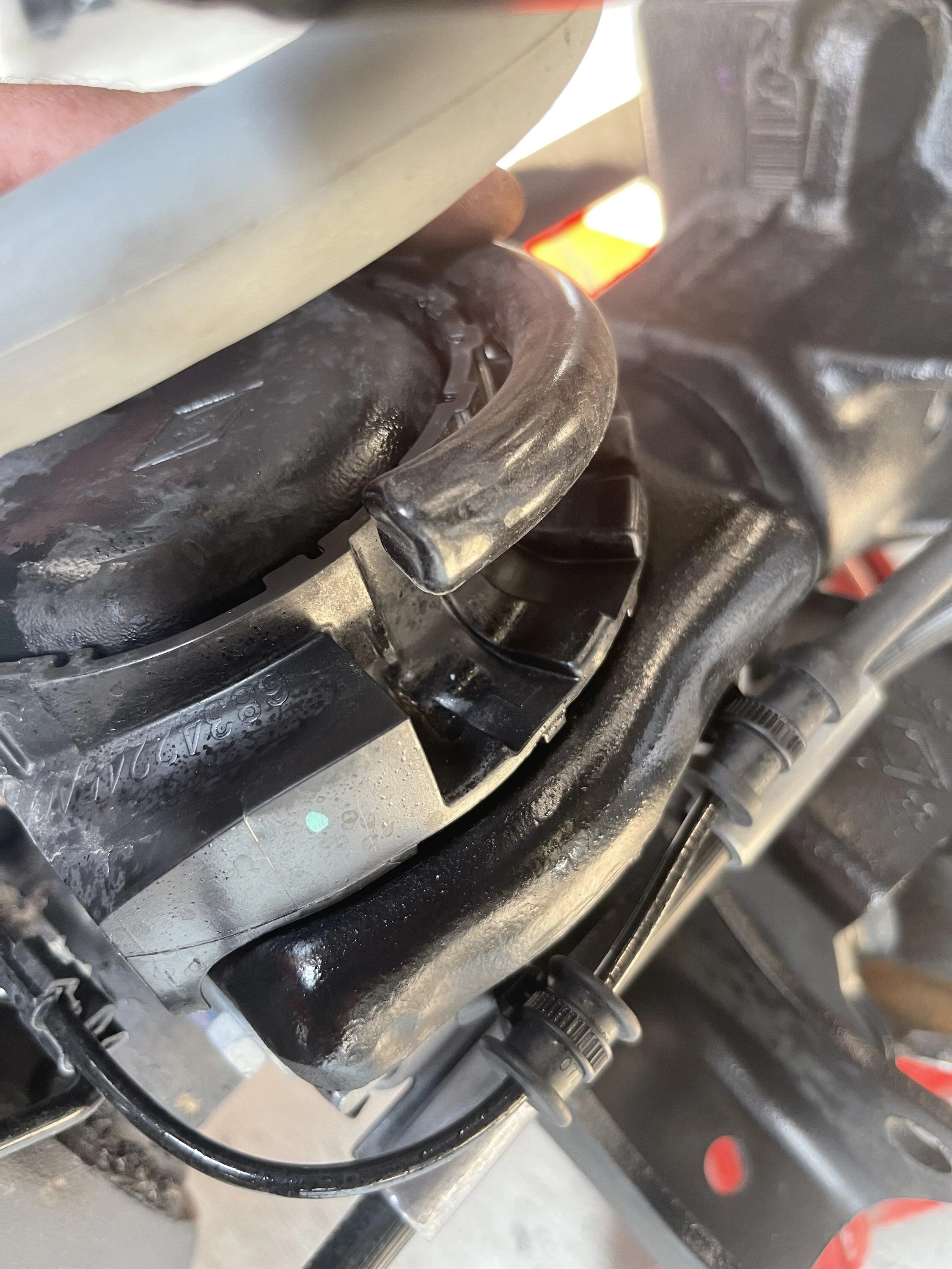

remove bottom of two rubber upper spring donuts.

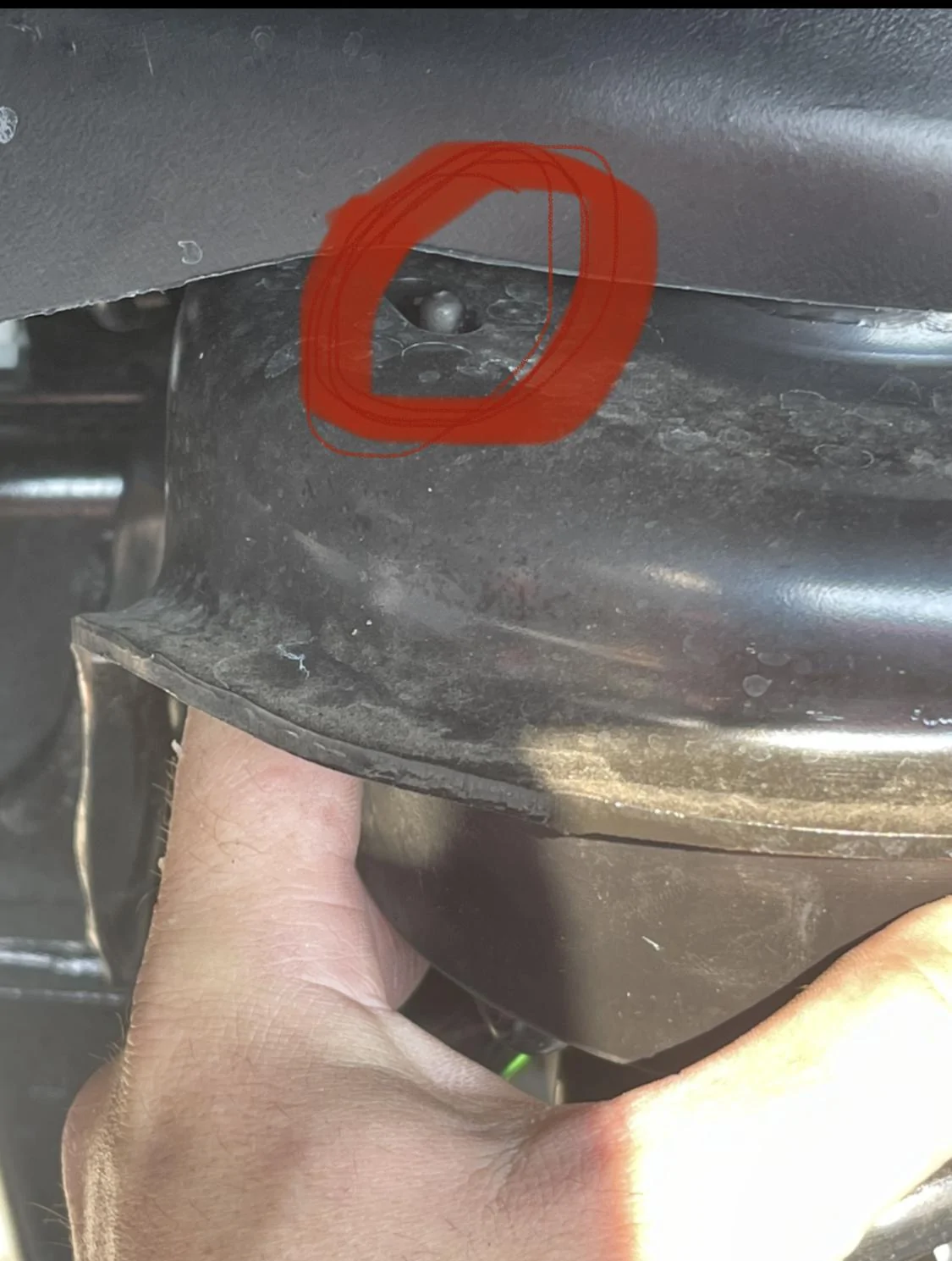

install new leveling block. Ensure the nipple on the upper spring pillow is aligned with spring bucket hole…. Then ensure bottom of spring is aligned with spring bucket relief.
Paying attention to all wires hoses, brake lines, and shock- jack the axle back up into place. Reassemble in reverse order.
