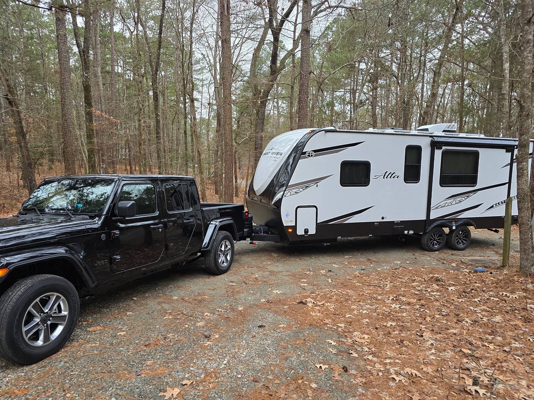

Yes, the Max Tow will tow 7750, but after doing it, I came to the realization that the JT is NOT happy about doing it. It rarely gets higher than 5th gear unless I'm going downhill. I REALLY want 35s but doing that will ensure that the truck can't get into 5th gear when towing my camper...
