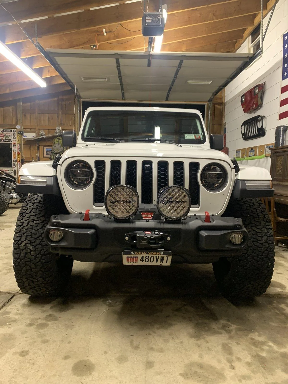

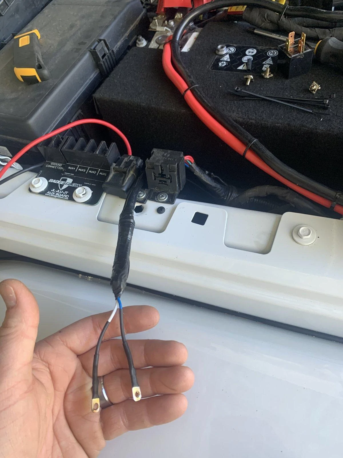

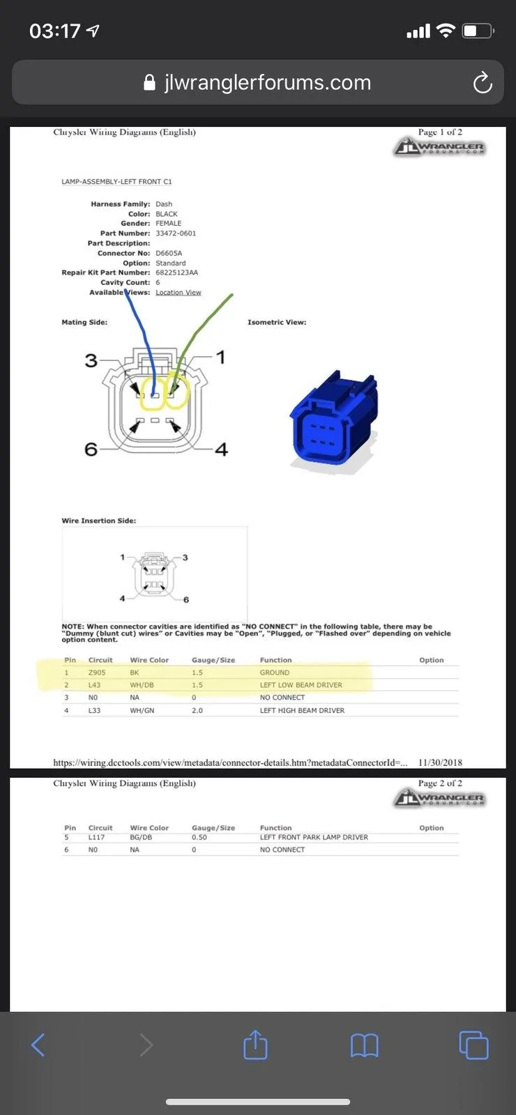

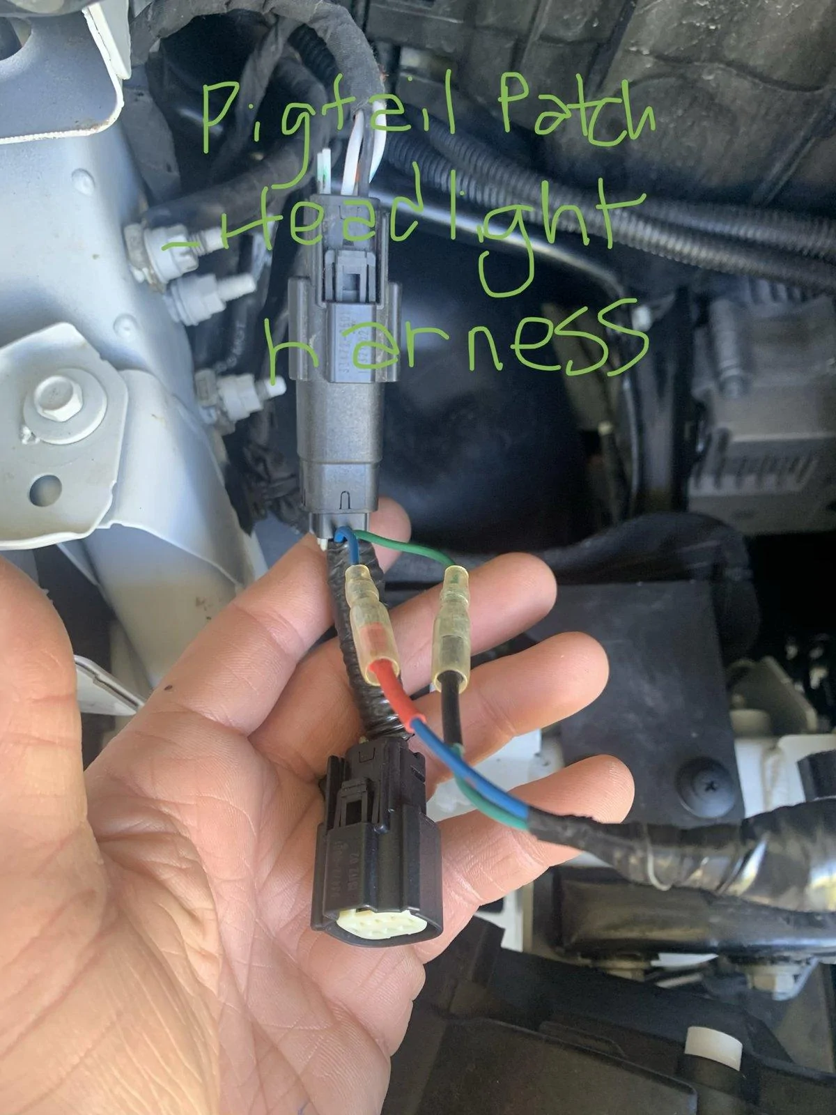

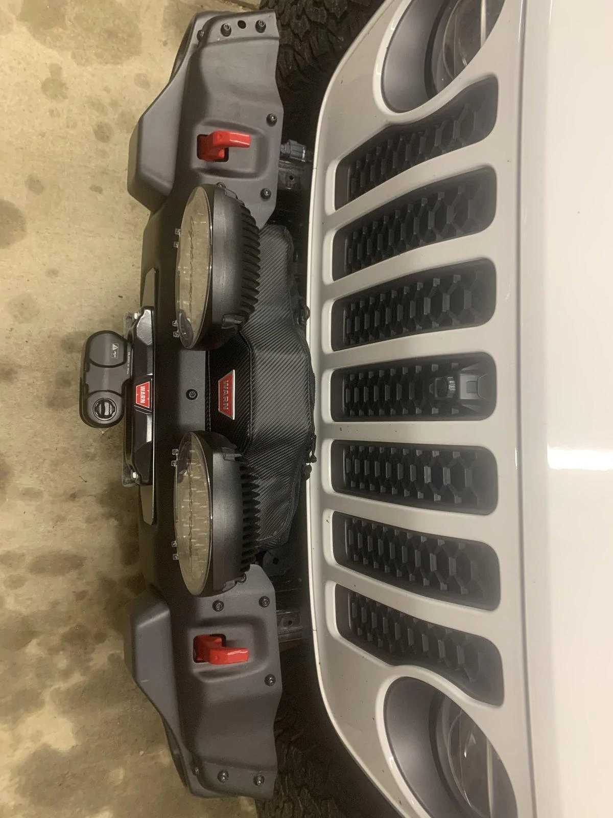

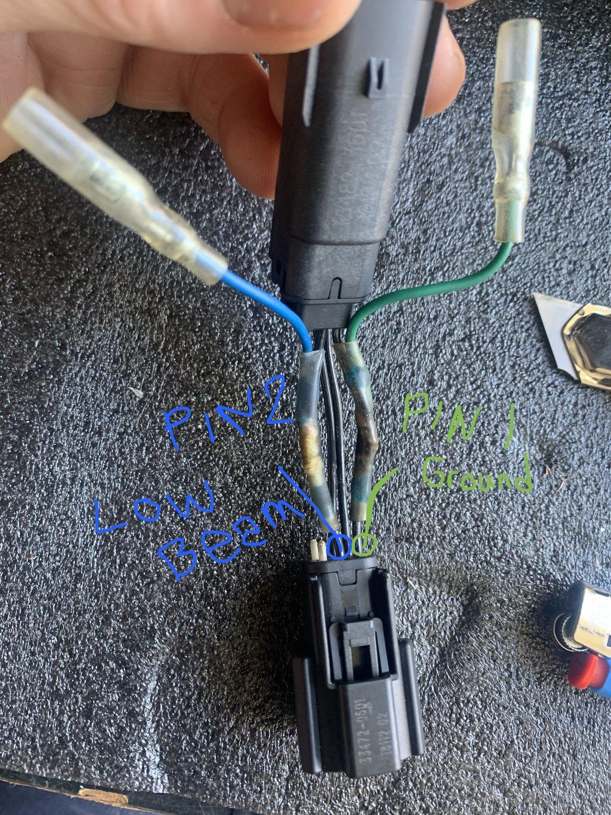

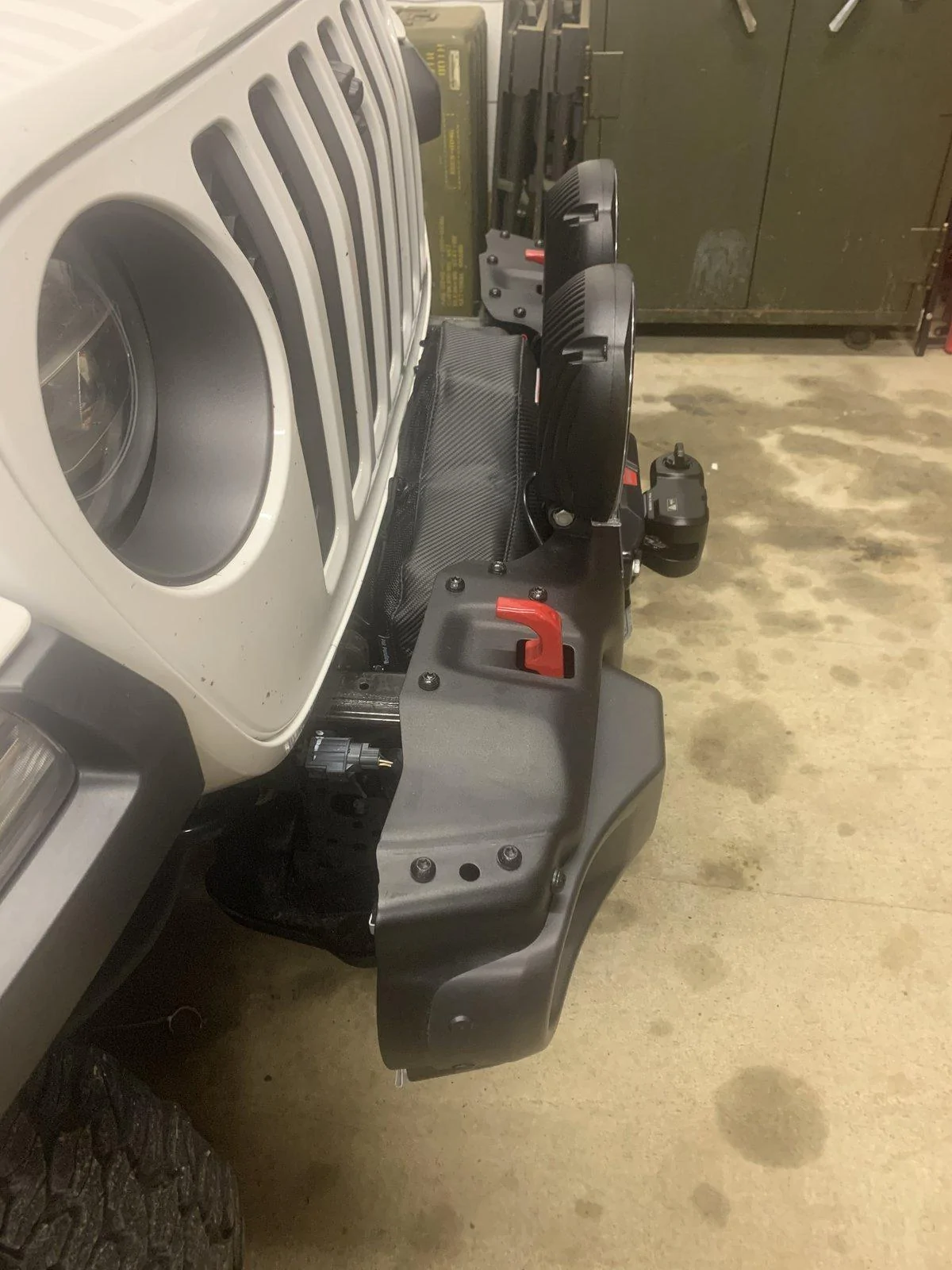

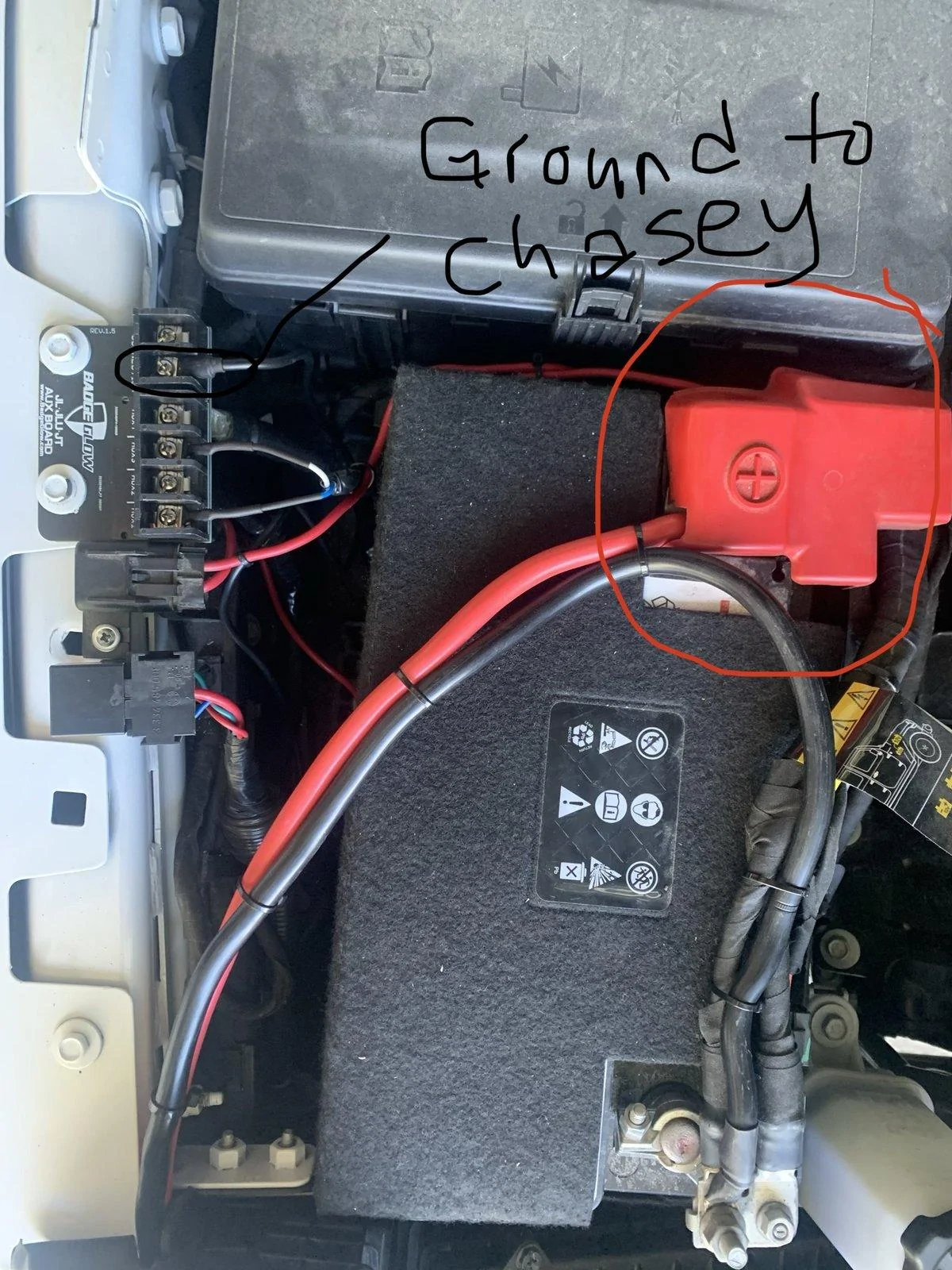

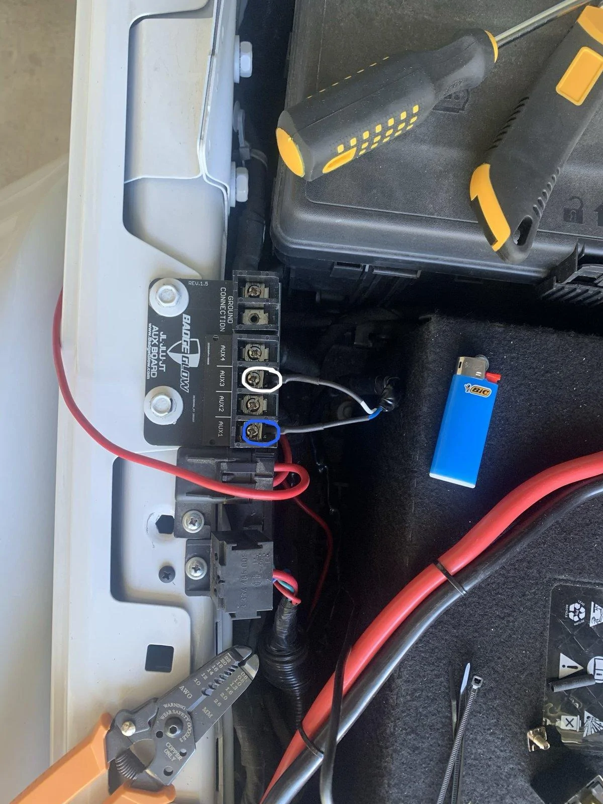

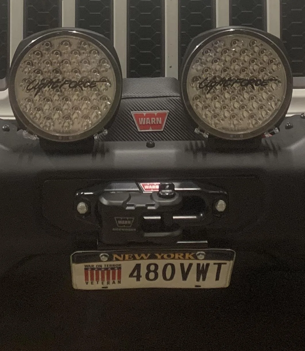

This was a 4 month adventure to get these installed on the Aux. switches! After countless emails and talking directly to the engineers in Australia at the Light Force headquarters the job is done. There is a custom pigtail that had to be made to tie into the 6 pin connector at a headlight. Then used a badge glow board to clean everything up. Best part is these lights are controlled through the Aux switches and the high and low beam. I get 3 functions...full intensity, day time running and low intensity (approach lights). Any questions ask, the wire loom for this product from light force is not compatible without modification into the 6 pin connector.
