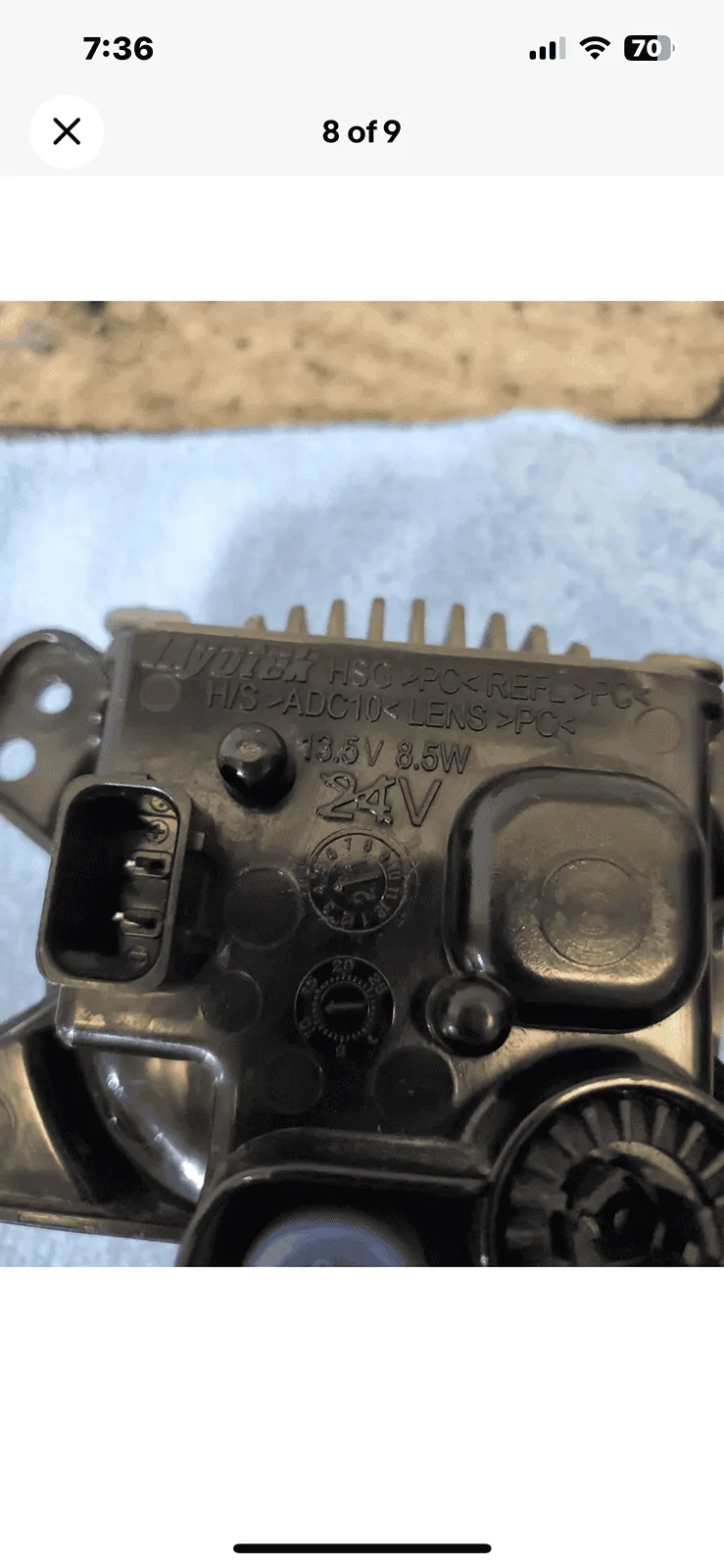

There's watt rating stamped on the back of the oem lights.
So you'd know at the least that it handles that many watts.........

Some of the lighting is literally voltage regulated, so if you use their voltage stated of 13.5 in amperage calculations from watts, you'll be good.
Can't get any more clear than your pic!
