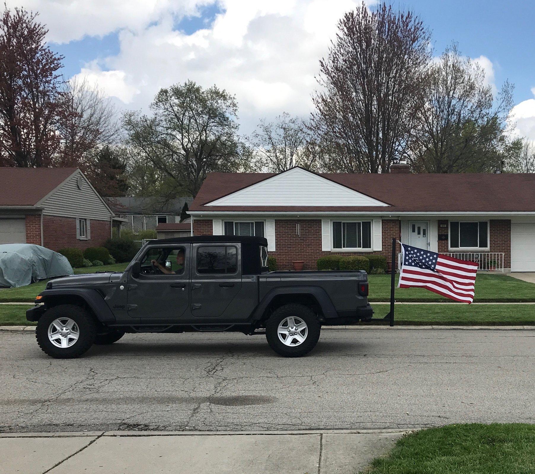

I started with that. I then used 6’ of 2” PVC painted black as the pole. I drilled two holes through the pipe for eye bolts. Ran caribiners through the eye bolts and attached the flag to them
Now that’s a great pic! You can’t beat a beautiful flag waving in the wind behind a gladiator! What size flag, I don’t want to get it too big and it touch the ground when stopped . Then again, I could probably make the pole taller!

3x5. That will give you about 24” of ground clearance at a stop if you put your top eye bolt within 3-4” of the top of the pole
