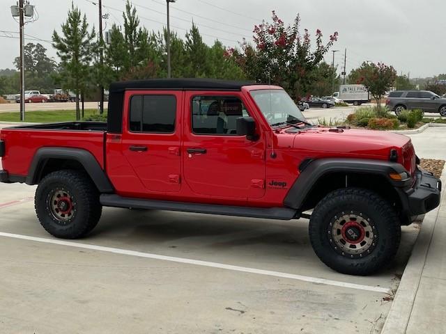

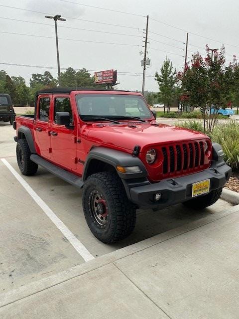

Couldn't find 35s I wanted. These are 305 70r/17s. They are 34 1/4" tall. XD FMJ137s are the wheels. A little rub when turning in reverse. Otherwise amazing. Love it

Looks Great! Whats the offset on the wheels? Did you not use any spacers?

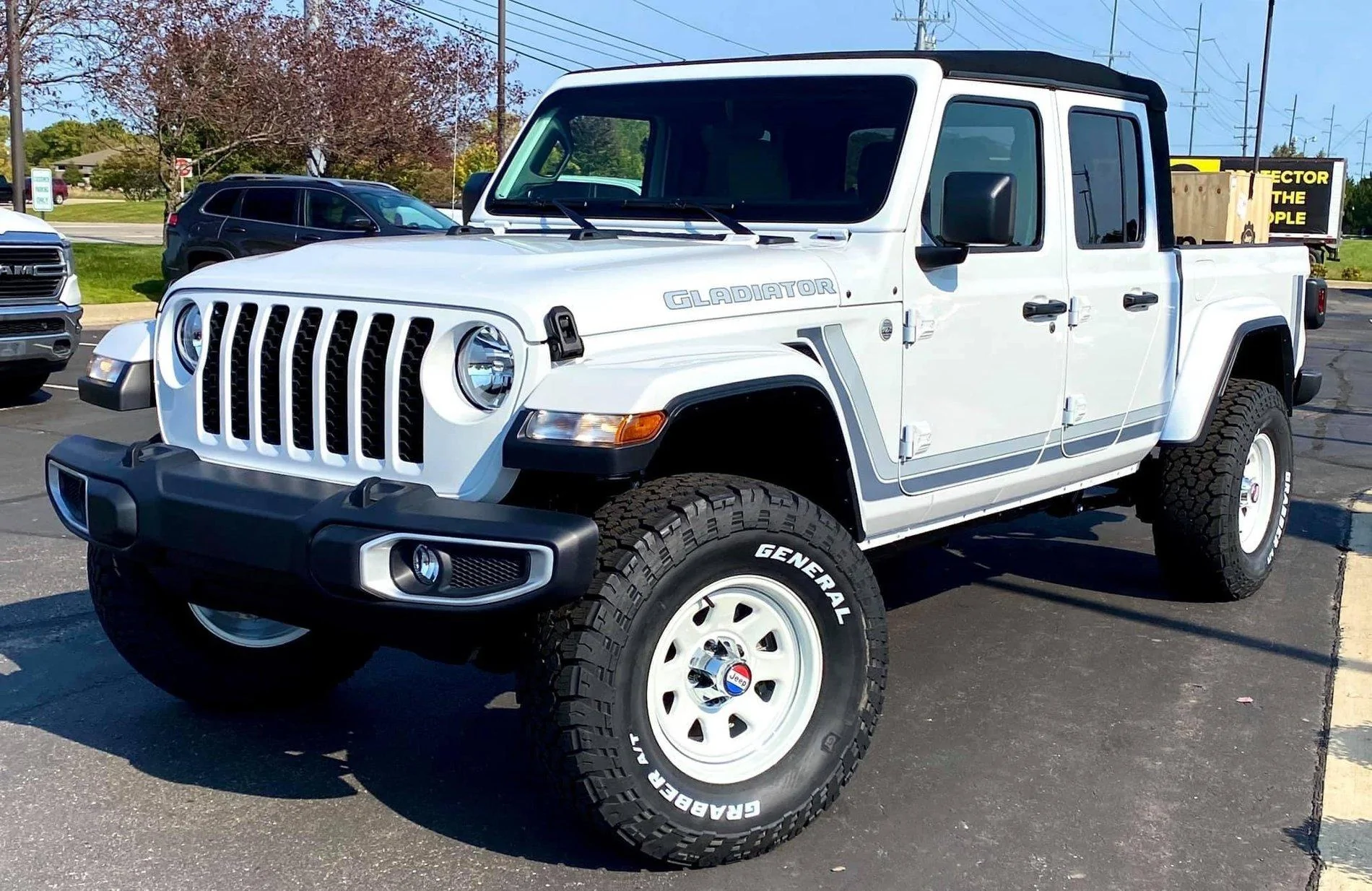

2021 Sport S Max tow with Mopar 2" lift and true 35x12.50x17's. Very happy with the look / stance. Doesn't have much rake. Will install 3/4" spacers when I do the winch bumper to keep it level
No spacers whatsoever. Its a nine and a half inch wheel and I believe a ten and a half inch tire. I didn't want any issues. Those numbers are width.
@mtudb24 I’m considering similar to what you did, except I want to keep stock wheels. Do you have any rubbing at all? With sway bar disconnected? Full articulation?
