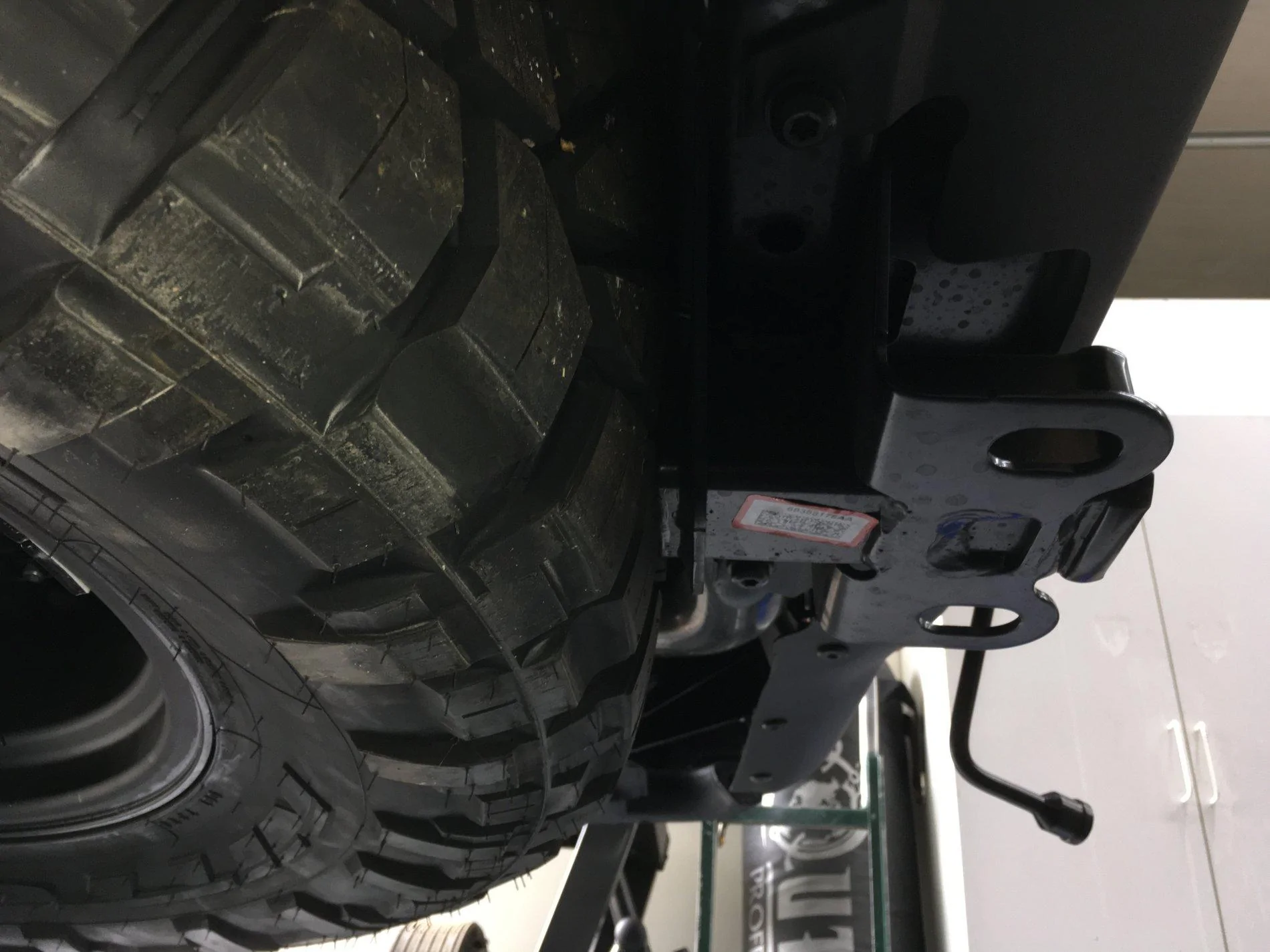

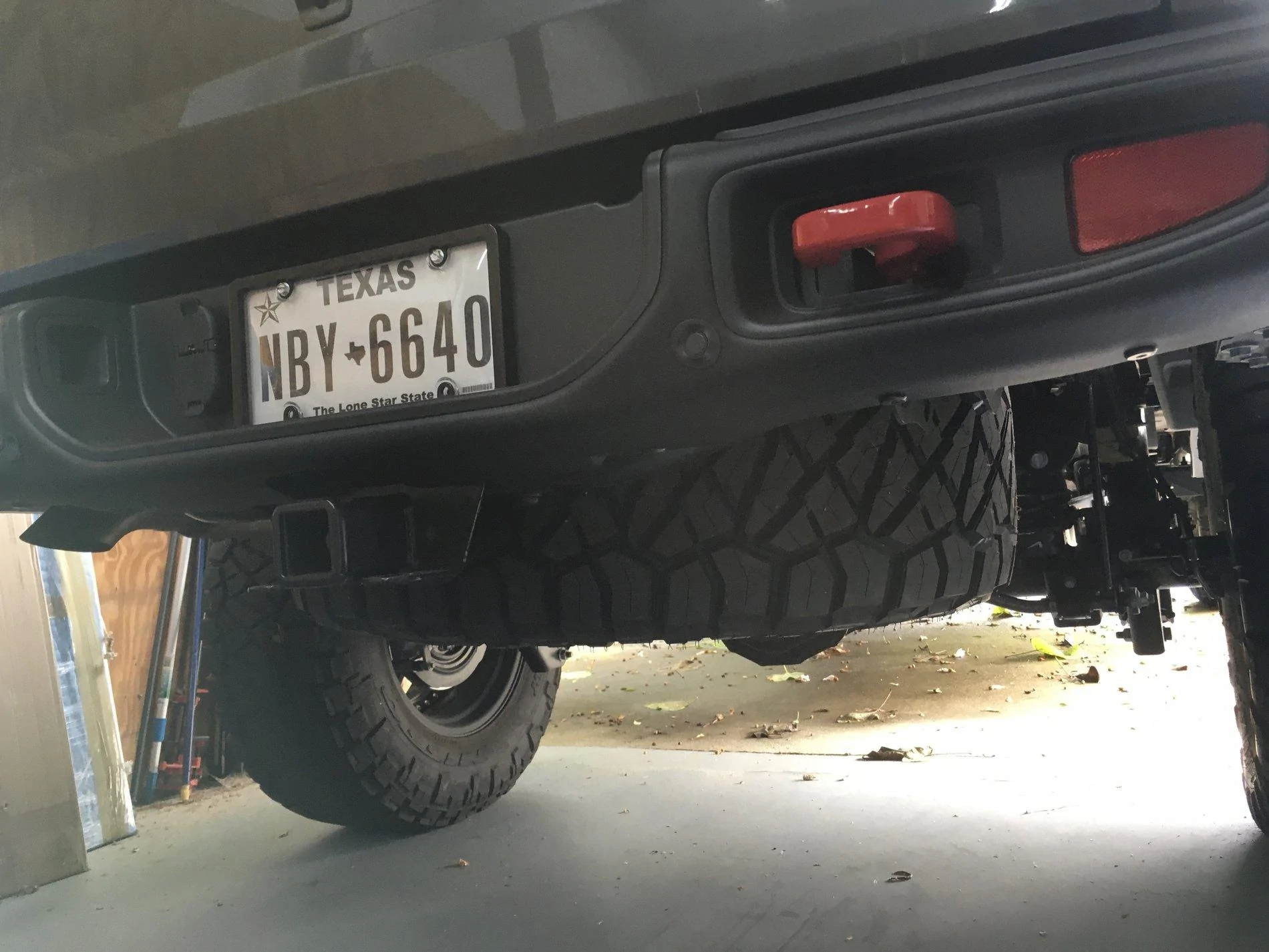

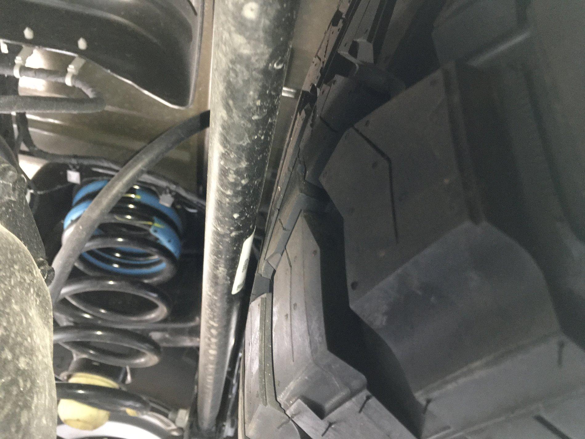

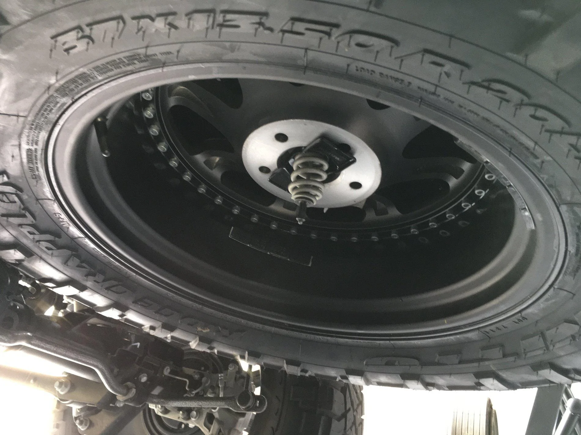

It was easier than I thought, but I had to air it down to about 10 lbs., just enough to keep the bead set. This will allow me to have a spare while towing the Corvette up to NY. as you will see, it is a very tight fit! Had to slightly bend the edge of the heat shield and I have about 1/4” clearance from the rear track bar.
Jeep Gladiator Made my Nitto 37/13.50-20 spare fit. 5022918A-C357-444C-A918-95B04342A4BF
Jeep Gladiator Made my Nitto 37/13.50-20 spare fit. CA4888E1-F5DE-4195-8E59-8B6146A66325
Jeep Gladiator Made my Nitto 37/13.50-20 spare fit. C119BF60-4C12-4D28-AED8-8168DD71D371
Jeep Gladiator Made my Nitto 37/13.50-20 spare fit. F04EBCC4-BBFA-4B9B-9BF6-AC51866BCB5B
