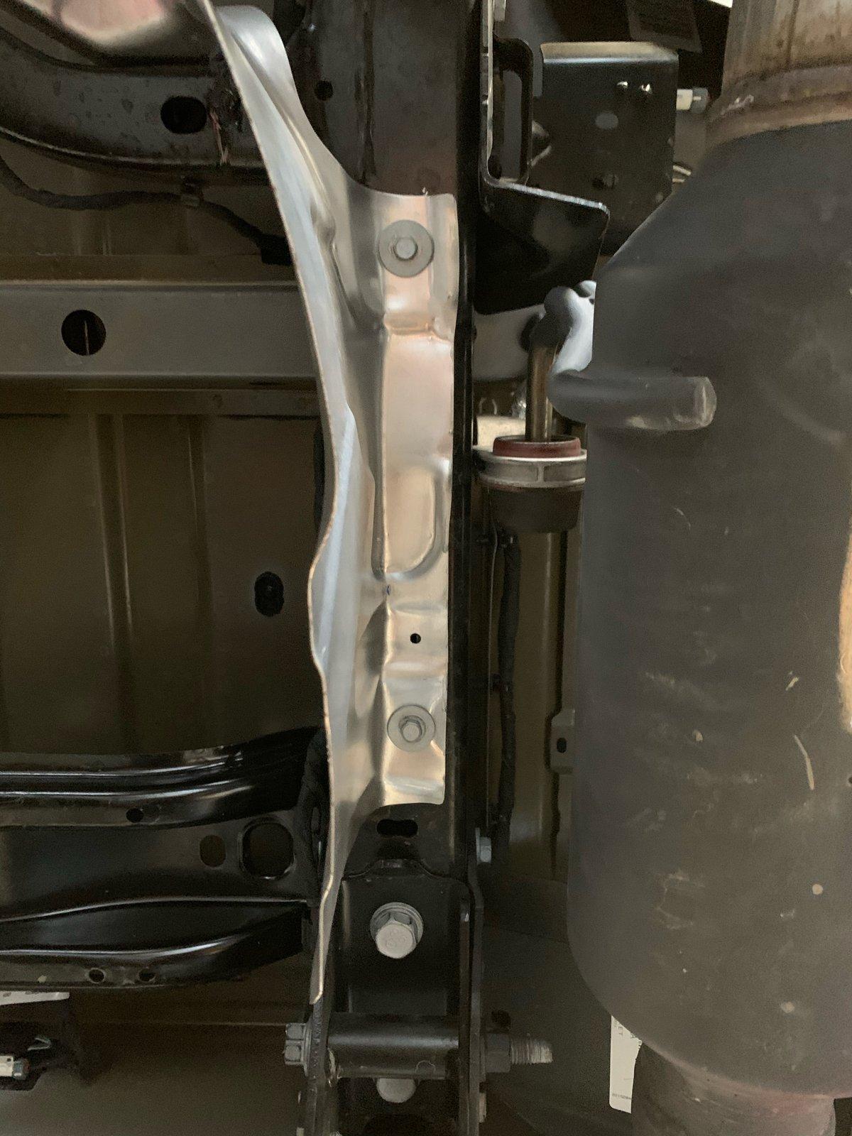

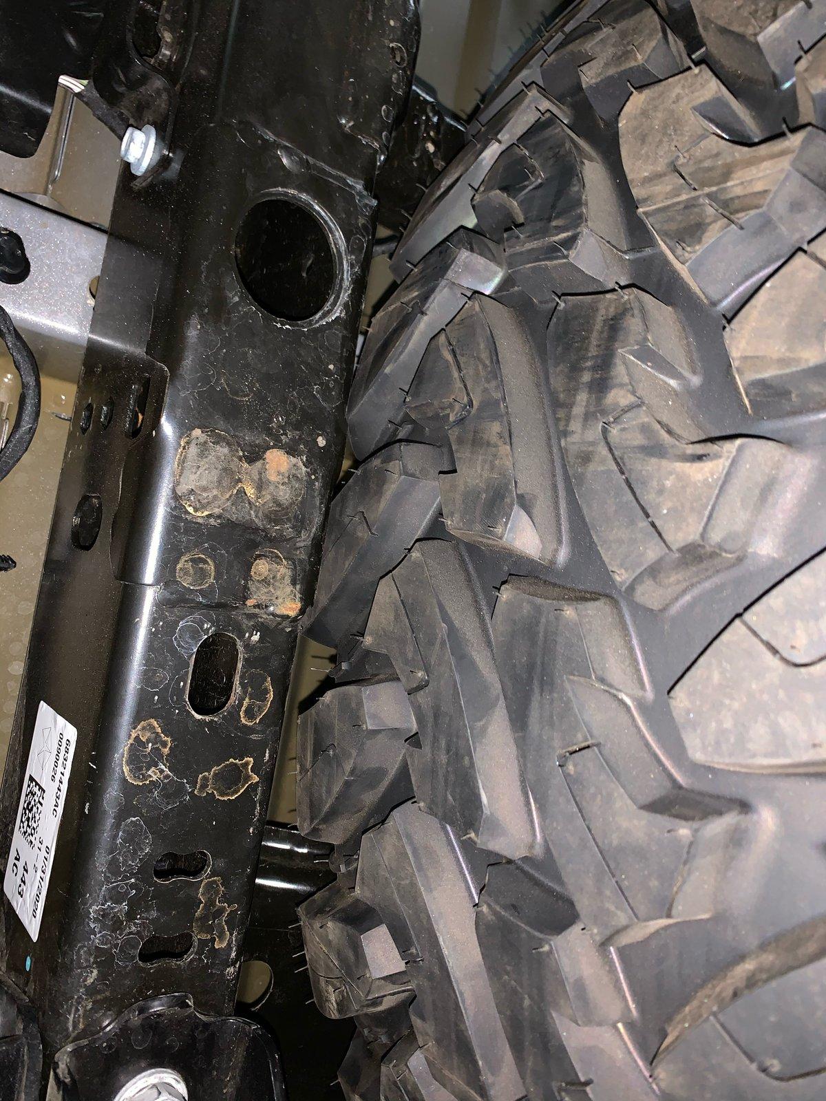

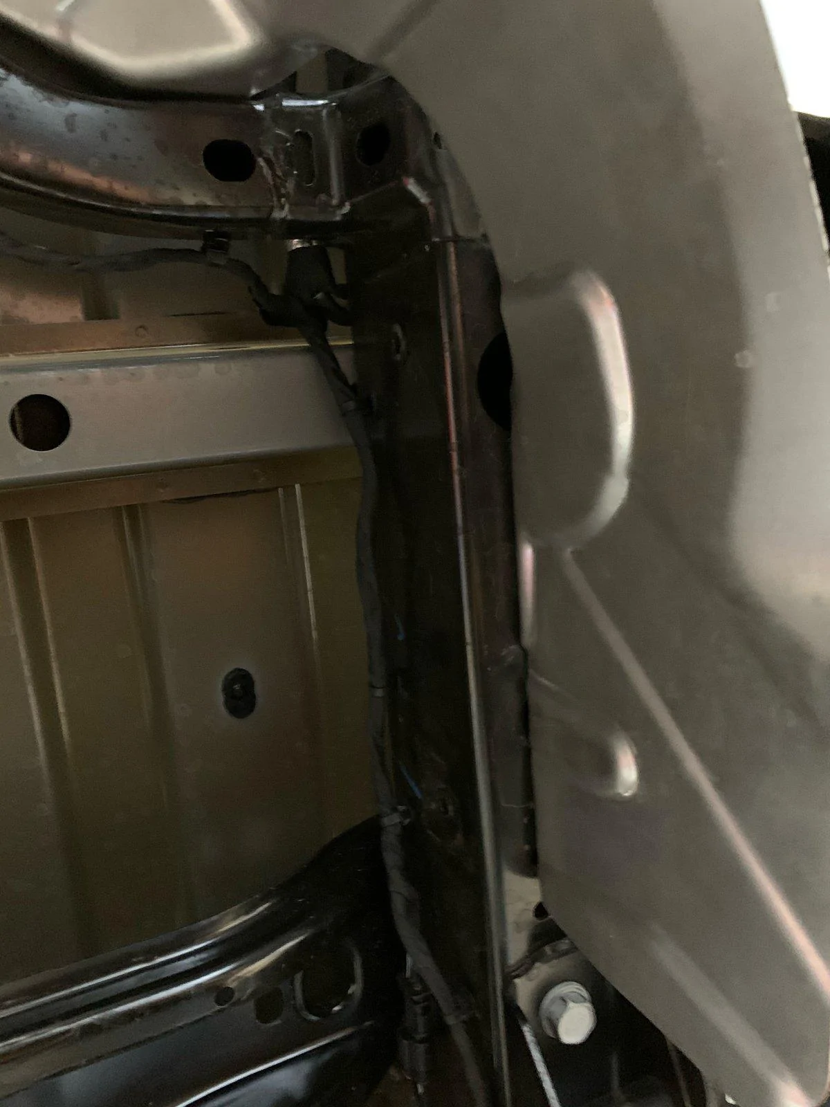

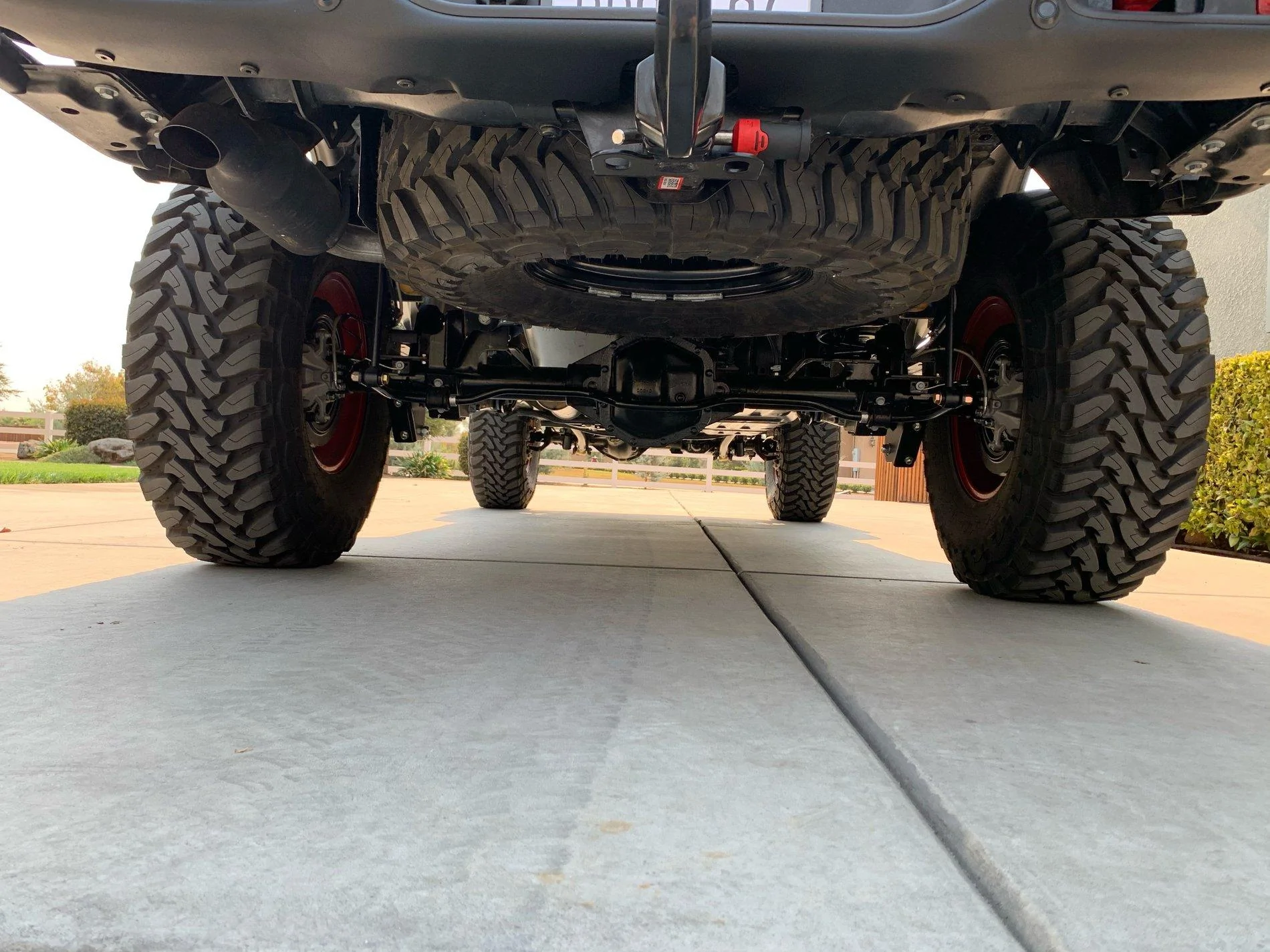

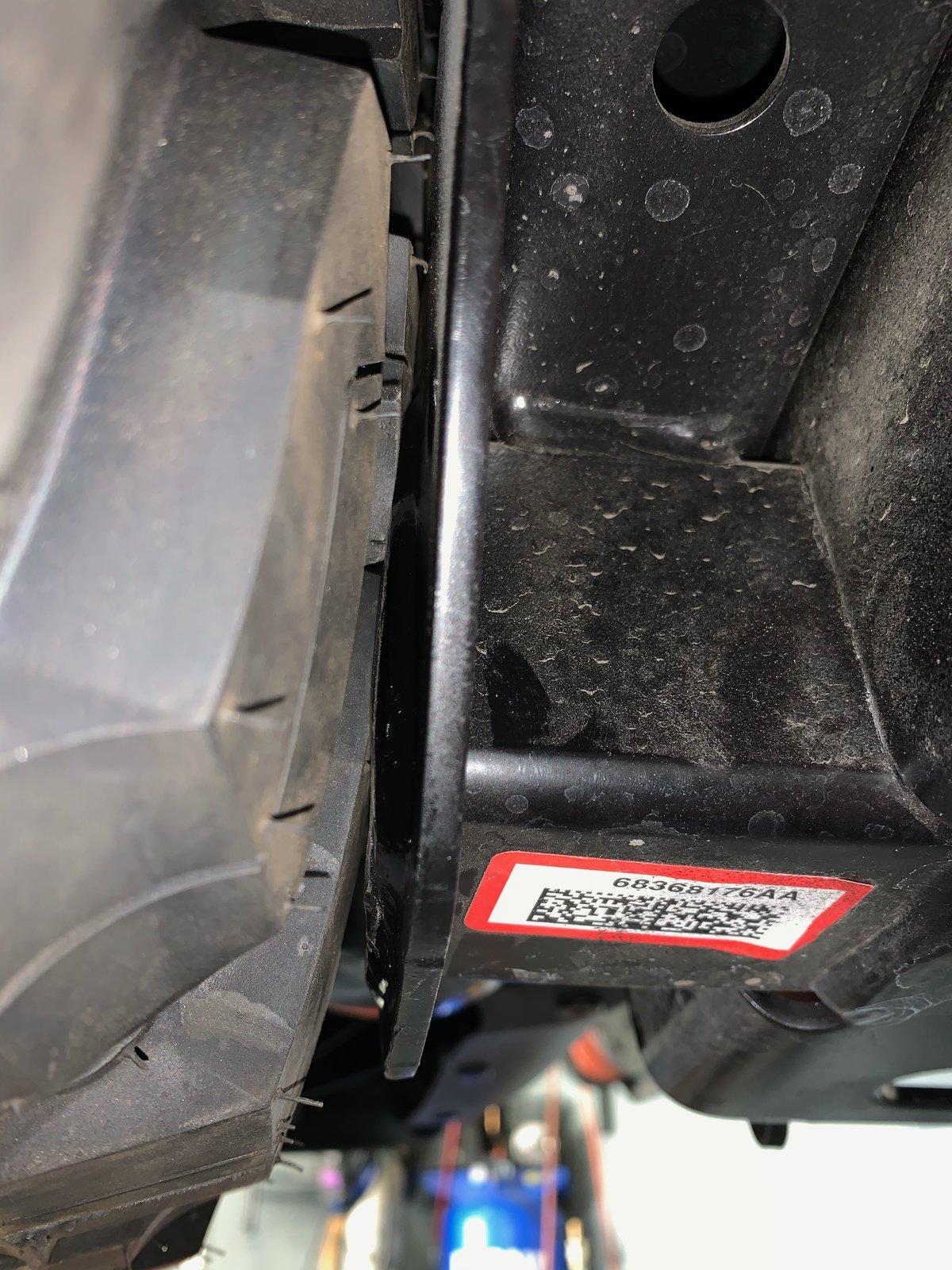

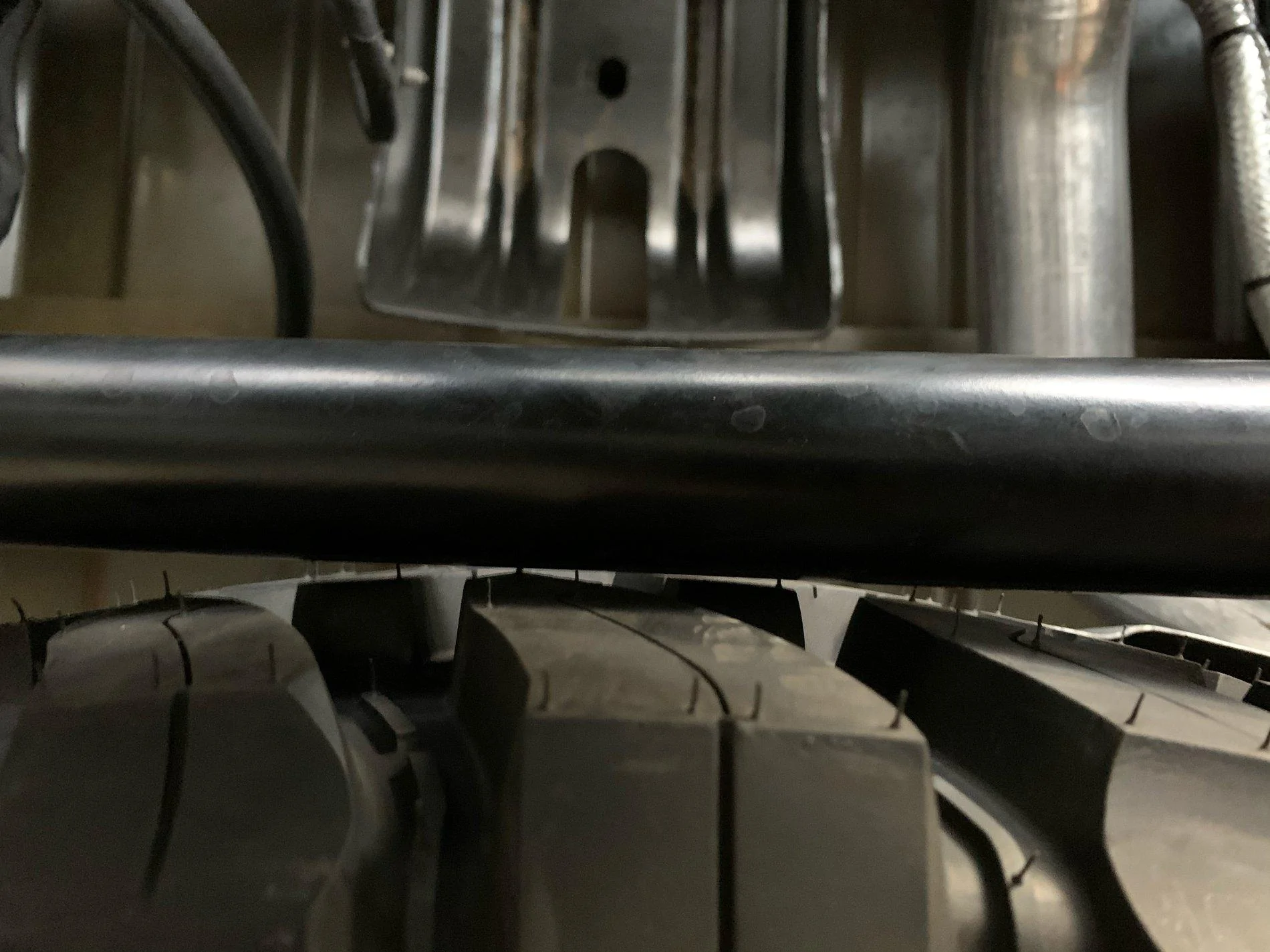

Hi Everyone. This is my first post to this forum. Just wanted to show how I fit my 37" Spare tire under my Gladiator. I know a lot of you have done it. I got it to fit fully against the cross members and between the frame rails fully inflated. I modified the heat shield by putting a 90 degree bend on the side and trimming about a inch off. Then drilling and tapping holes to bolt it under the frame rails instead of the side. This gave me about another 1/4" of room. I also loosened the rear bumper and pushed it all the way back and retightened it. Then I ground the back of the receiver hitch up to the weld. Seems to fit nicely!
