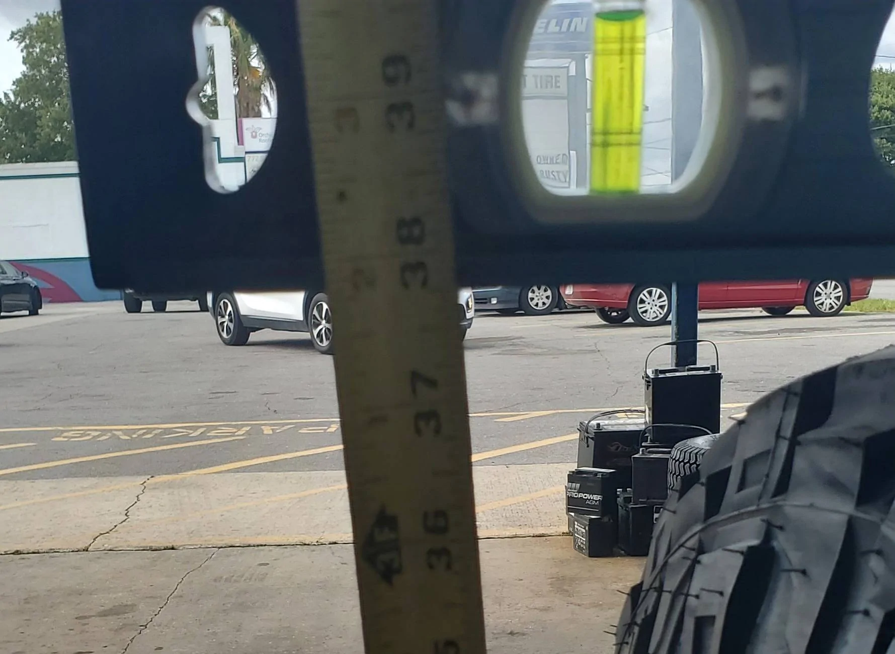

Nitto 38x11.50r17 Ridge Grappler fits
Spare measured 37.75" on the rim at 55# psi
Clayton High Clearance adjustable rear track bar
Trimmed 1/4"off the receiver tube
Removed heat shield
Sits on face of frame, not between rails

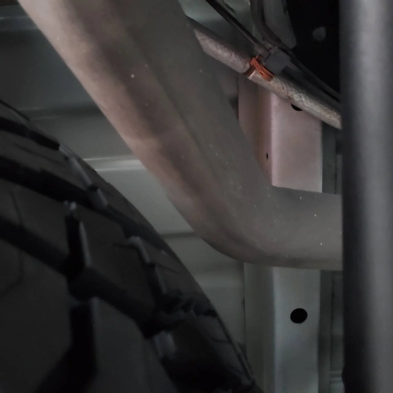

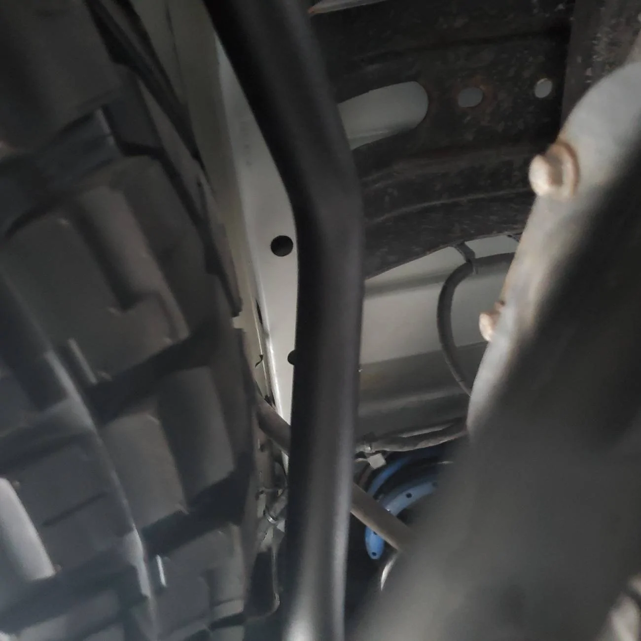

My Nitto Ridge Grappler 38x11.50r17 measures 37.75" and has plenty of clearance from the pipe on the oem EcoDiesel exhaust.
I thought about header wrap tape but don't need it.
That is my situation as well. Maybe I am over thinking it, but was worried about blowing heat from the pipe on to the tire.
Which may have also been Jeep's concern as well since they went to the effort to install a heat shield for a smaller tire (33") with an even bigger air gap.
I just got back from my son's shop.
We swapped the rusted oem steelie for a Rubicon take off rim and the spare shows no sign of any heat issues after a 2 hour Highway drive yesterday.
That confirmed my decision not to heat tape the pipe.
