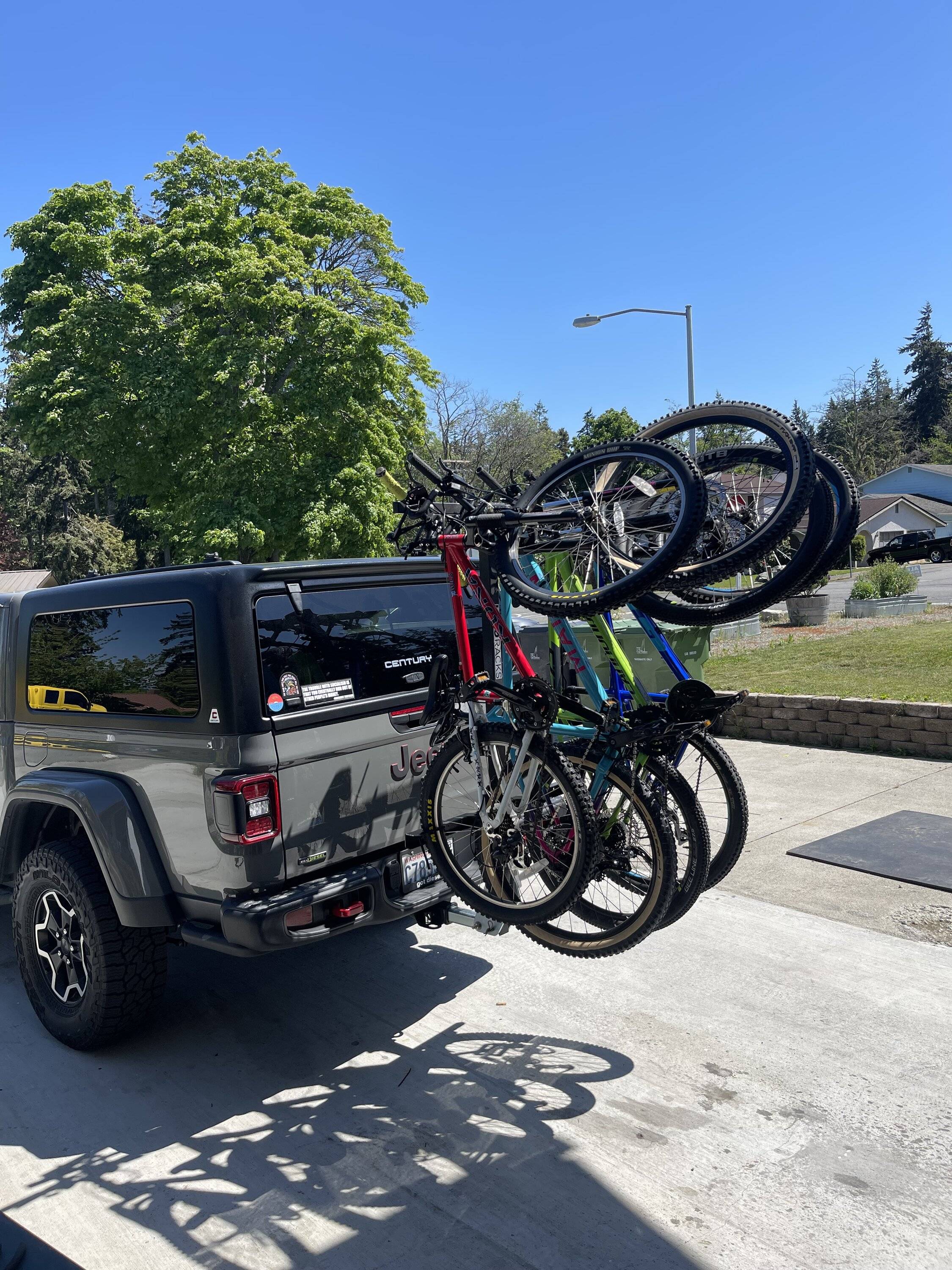

This has been the biggest clearance issue. Have trimmed flush (to the back of the receiver) both our bike carrier and standard hitch.
I use a Kuat Transfer hitch bike rack and it fits fine.
Kuat makes nice stuff, but we usually cart 4+ bikes around, so vertical has suited our needs a little better. I am actually in the middle of monkeying with the Lolo to carry 6 across…. Swapping some of the steel bits out for aluminum. If I did it over again I would have just ordered a few of the pieces (foot lowering, and hangers) from Lolo and built the rest. Don’t get me wrong! It’s BA and well built as it was, I just like to mess with stuff….
last summer before tires were added.
Those are great. I bought the kuat specifically to put into the receiver of the Smittybilt scout trailer. But it’s been convenient to put on the jeep as well. I also carry a couple or more on top when necessary.
