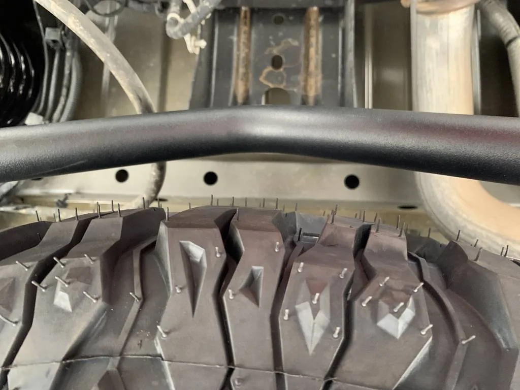

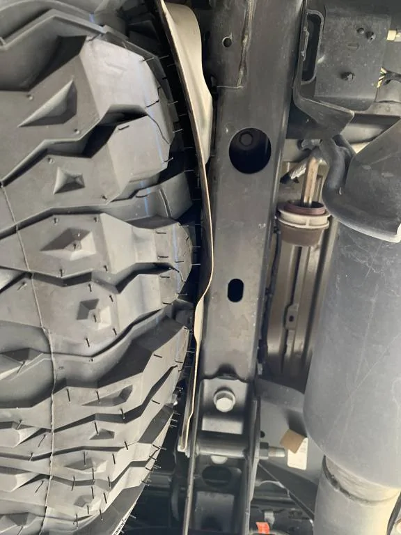

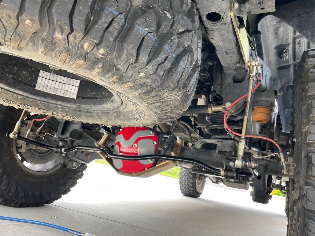

Here are some pics of a brand new Milestar Patagonia M/T - 37x12.5x17 on a Method bead grip 17x8.5 inch rim. I had to air down to 8 psi to get it to fit. I am using a Clayton bent track bar with a Clayton 3.5" overland plus lift kit. Note: a new Goodyear Kevlar MTR in the same size, with the same rim, did not fit even with no air.
Holy weights Batman! Did they Red dot mount your tires??
