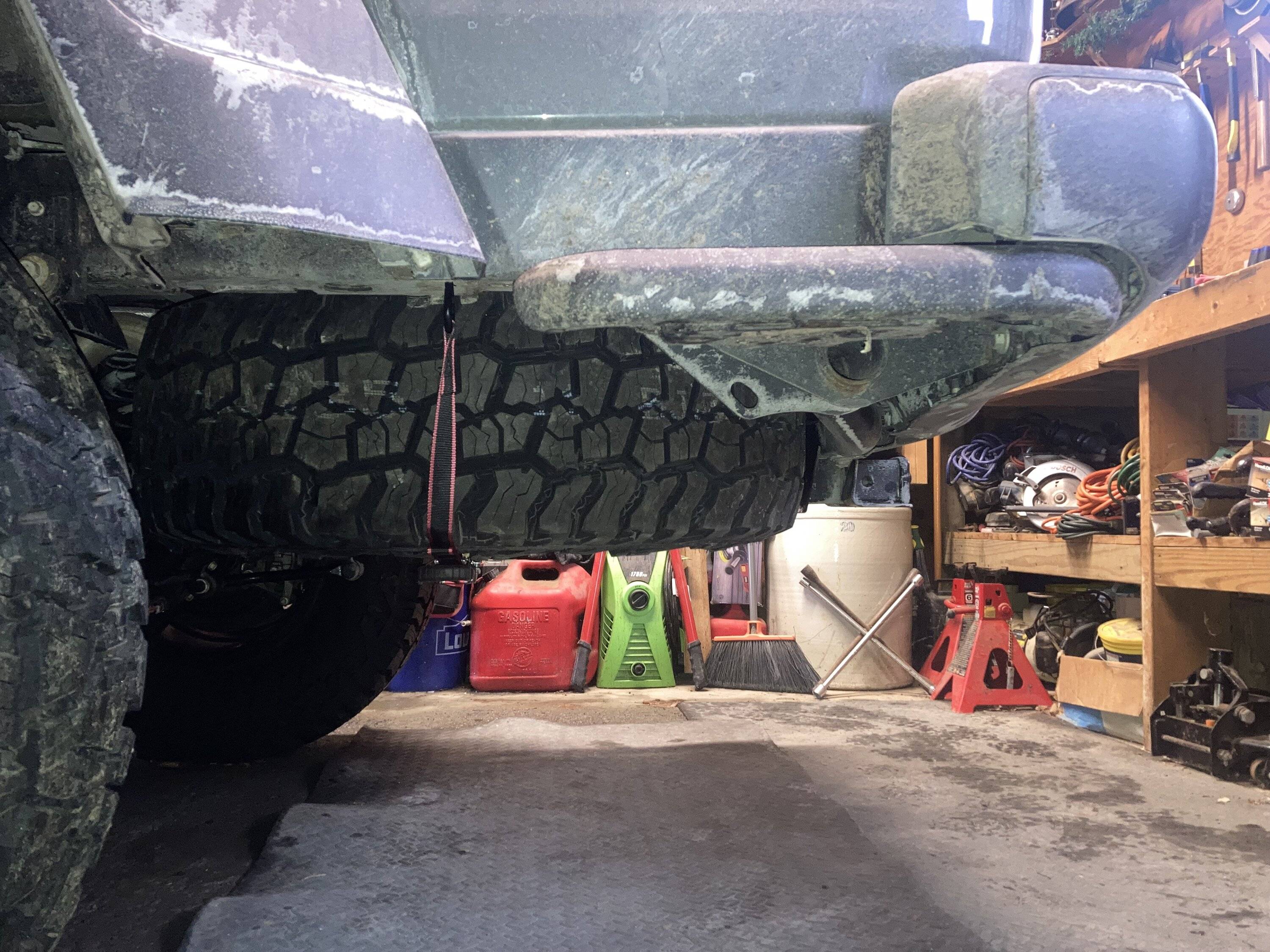

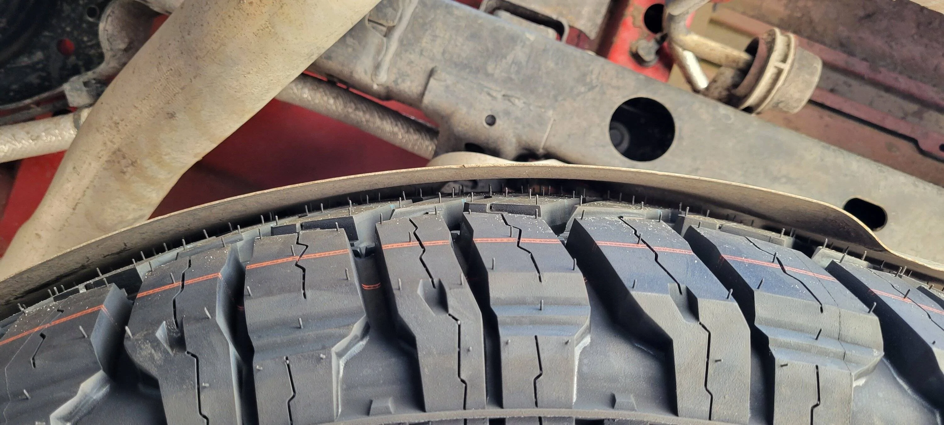

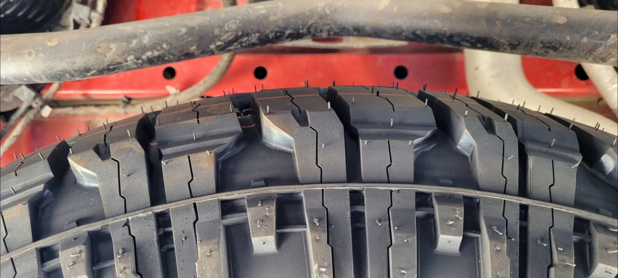

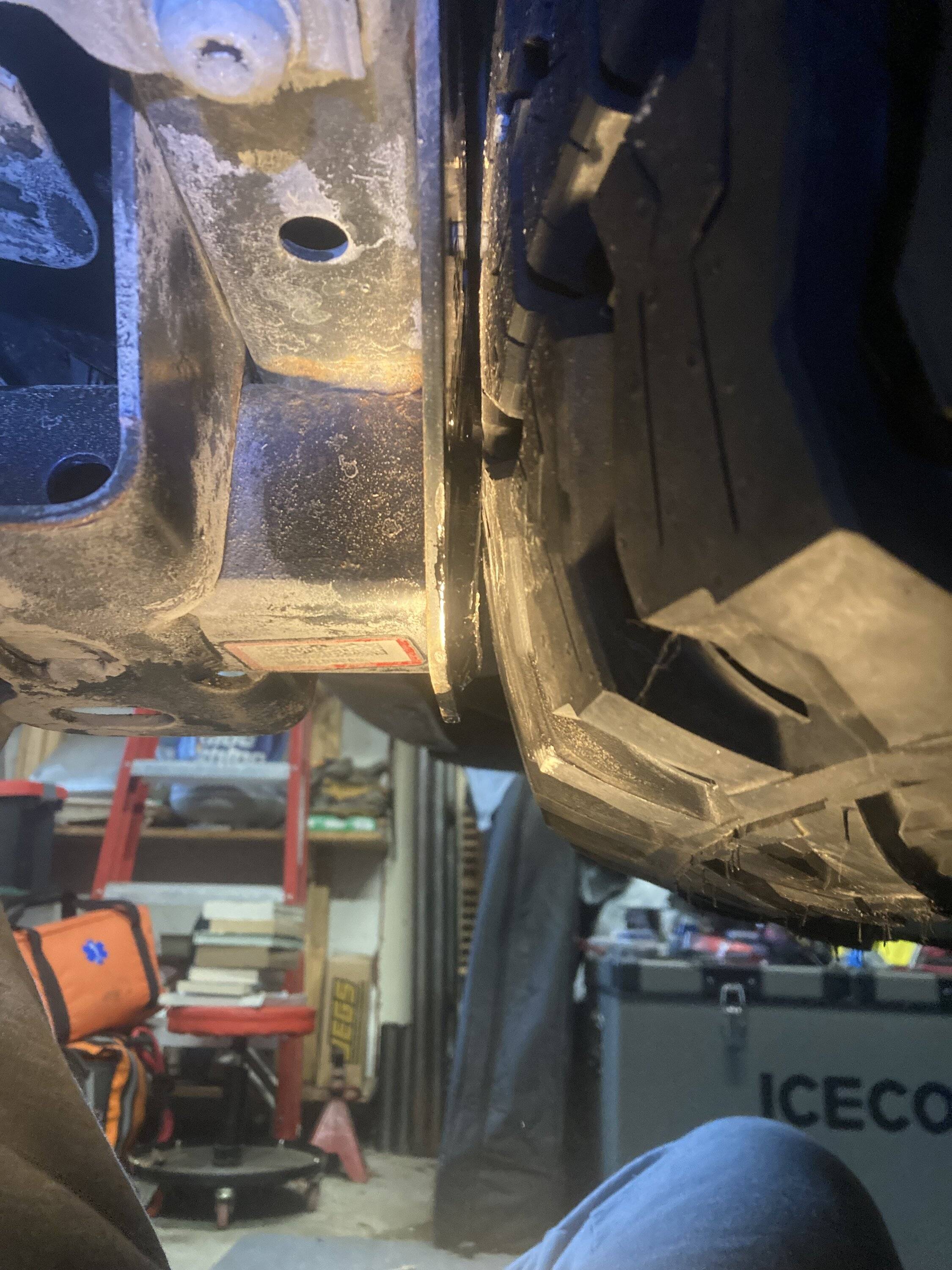

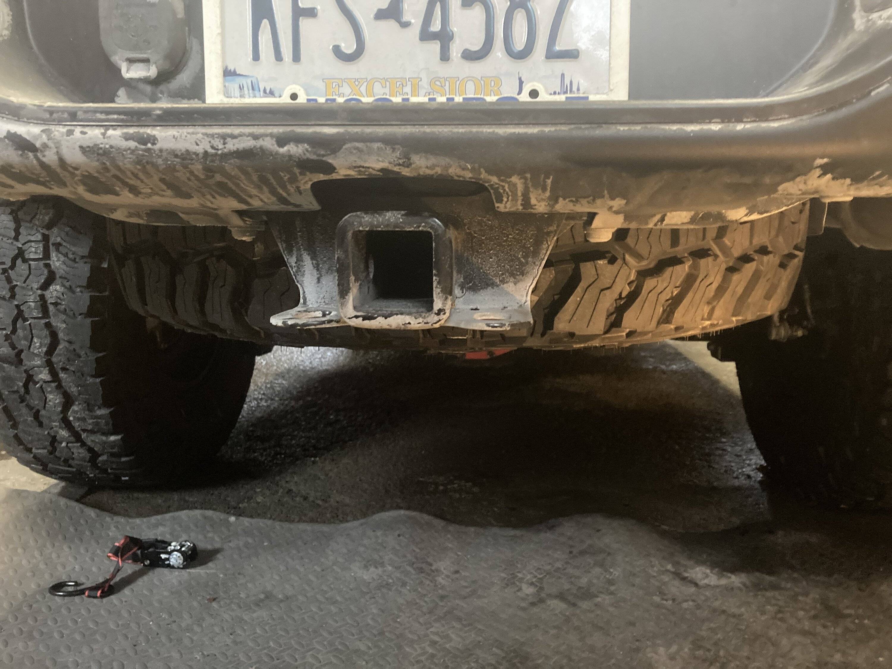

I know it's been said (and denied a few times too) so I'll add that with some advice and pics from @Moriarty, I got my 37x12.5x17 Mickey Thompson Baja Boss AT on an AEV Borah Dual Sport wheel under the bed with the factory track bar. Tire is at 32 PSI. The only mod was trimming about 1/4 inch off the hitch tube inside the weld.
Jeep Gladiator 37” spare tire - list of tires that fit under the bed IMG_3207
Gotta love road salt.
Jeep Gladiator 37” spare tire - list of tires that fit under the bed IMG_3210
Jeep Gladiator 37” spare tire - list of tires that fit under the bed IMG_3209
Jeep Gladiator 37” spare tire - list of tires that fit under the bed IMG_3213
I added the $10 Husky strap just for a little insurance, since the spare winch has more weight now.
I'm still going to keep my eye on a bumper swing-out mount down the road, and will likely move it to the bed if I'm going rock crawling, but for highway and overland trails, I think it will do.

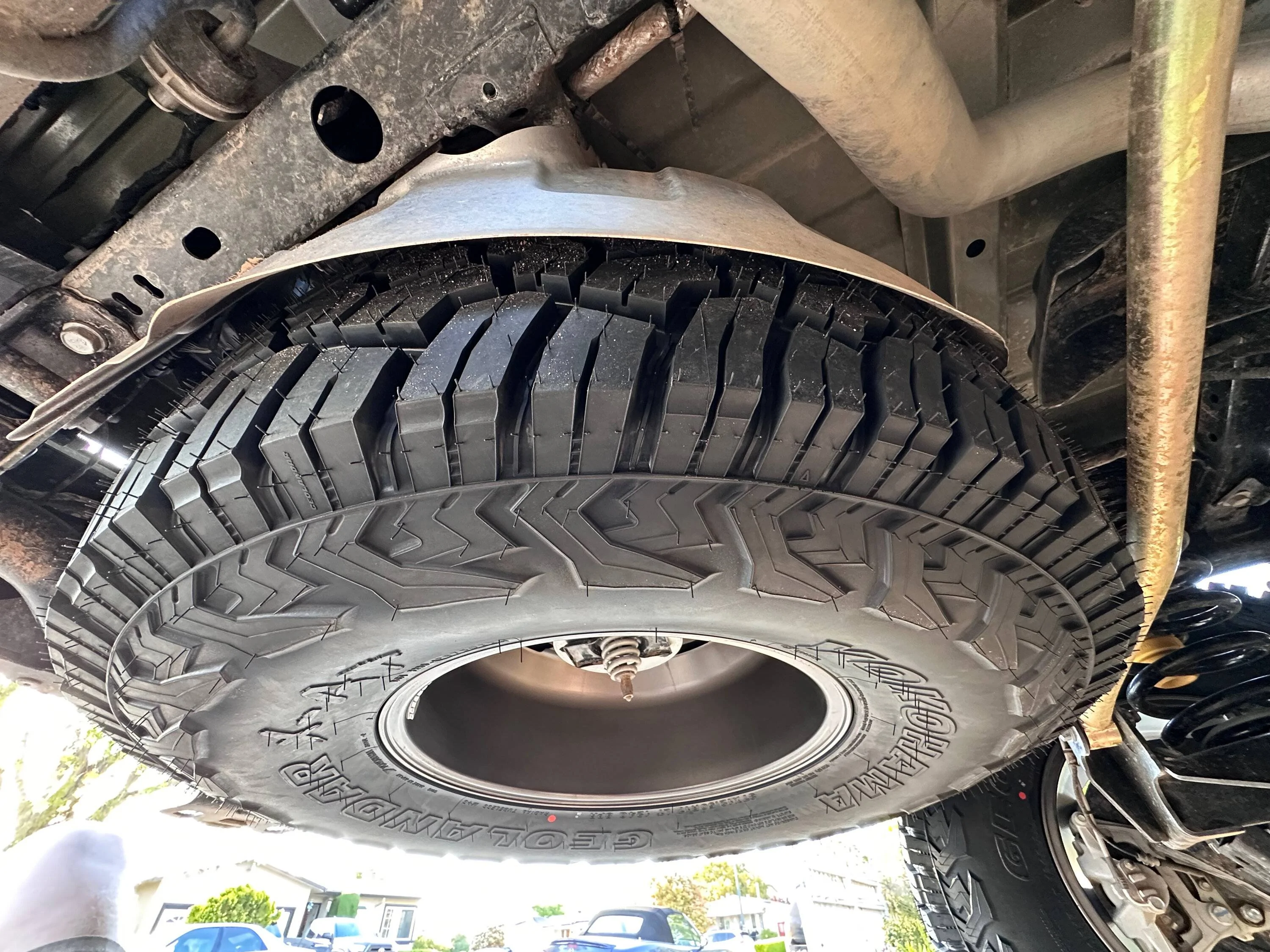

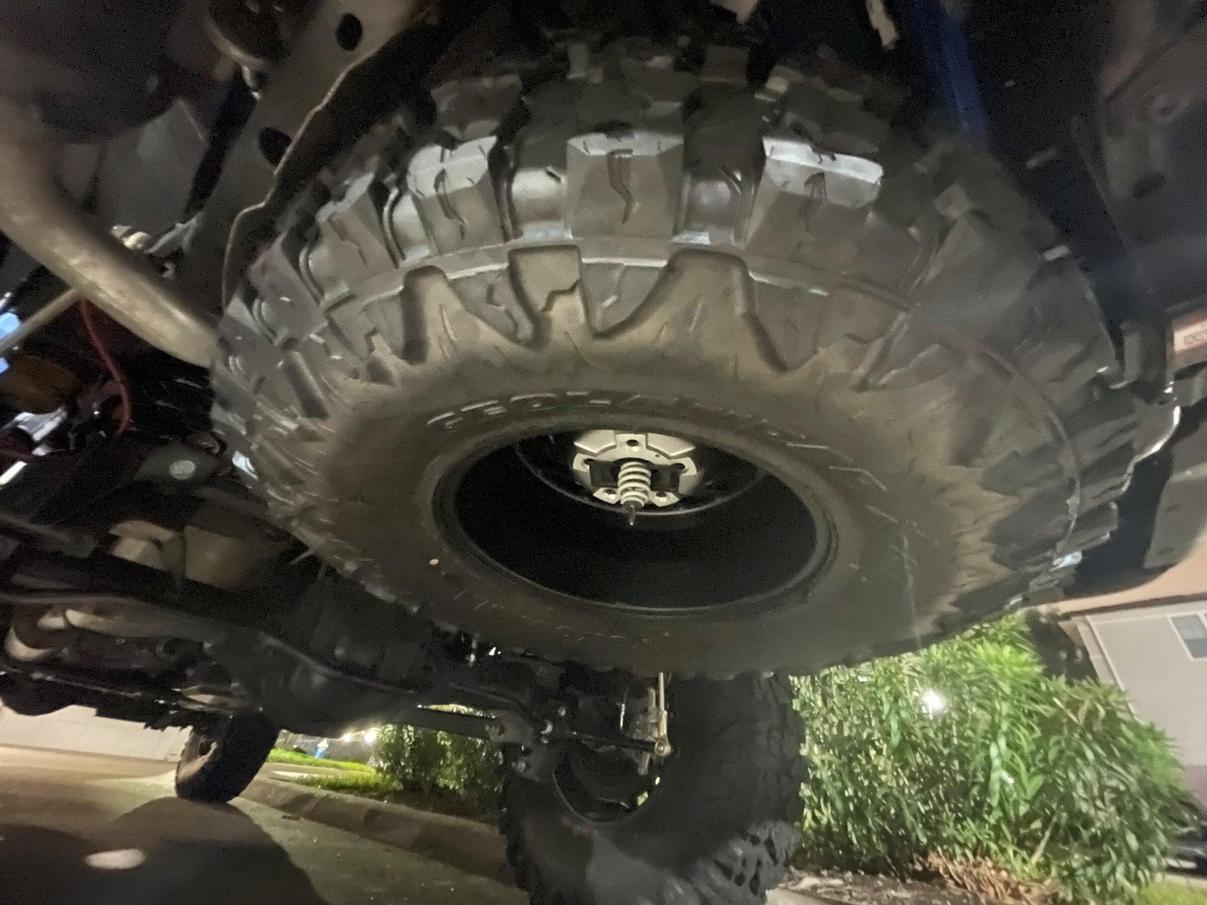

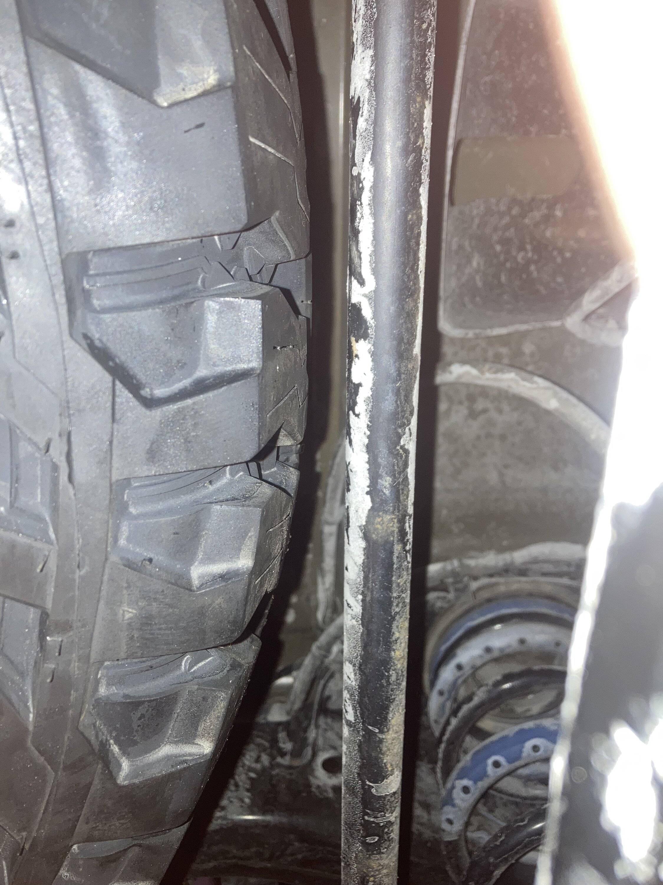

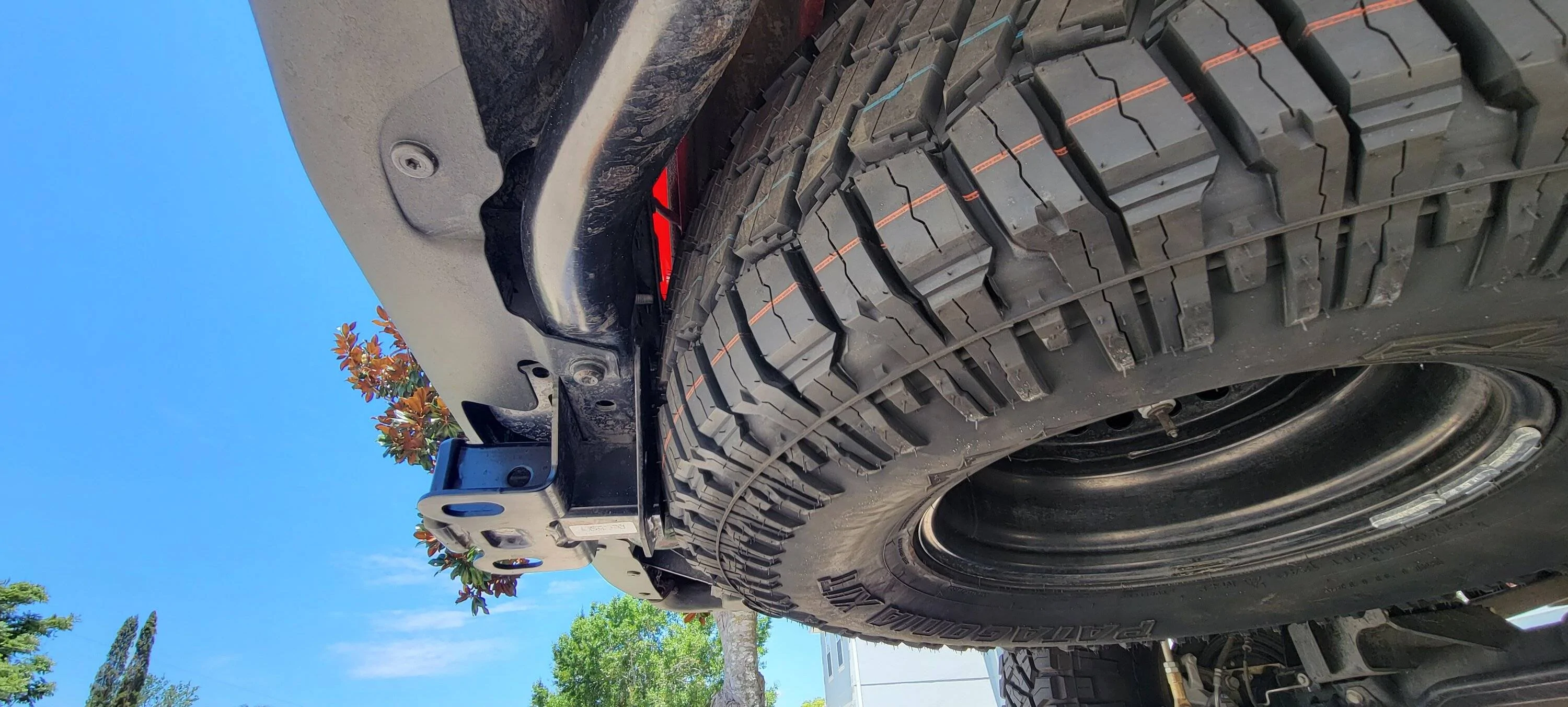

Yokohama X-AT 37x12.5-17 on 8.5" wheel fits in stock spare location, no modification to receiver hitch or heat shield, but with an aftermarket track bar (Metalcloak). I measured 36.5" side-to-side, and 35.6" loaded heavy in the rear (Alu-Cab + gear)
Jeep Gladiator 37” spare tire - list of tires that fit under the bed IMG_1818

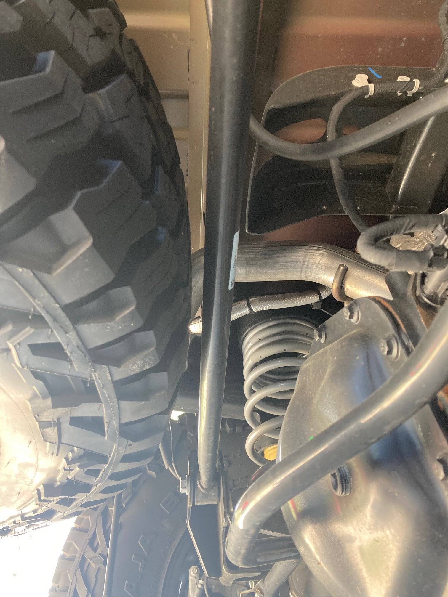

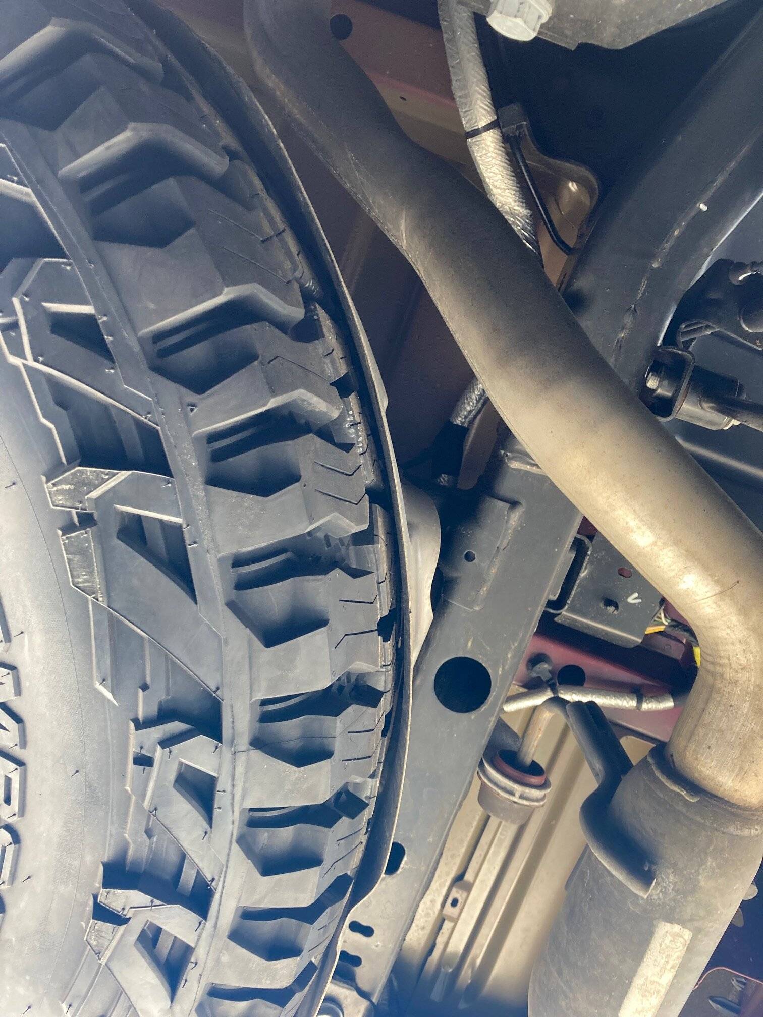

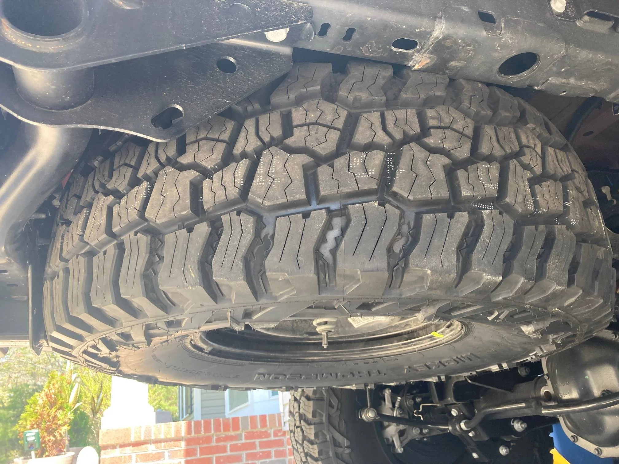

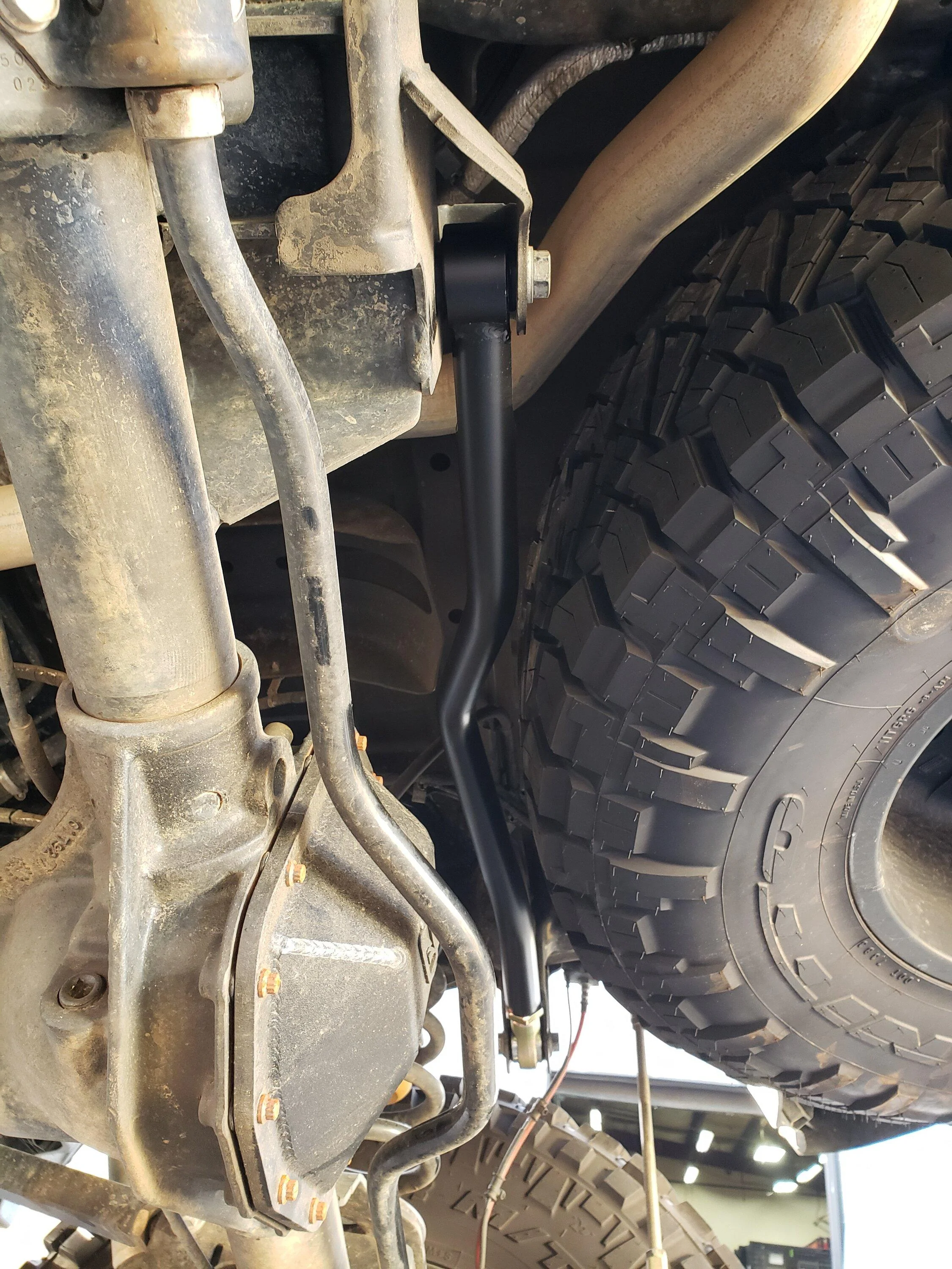

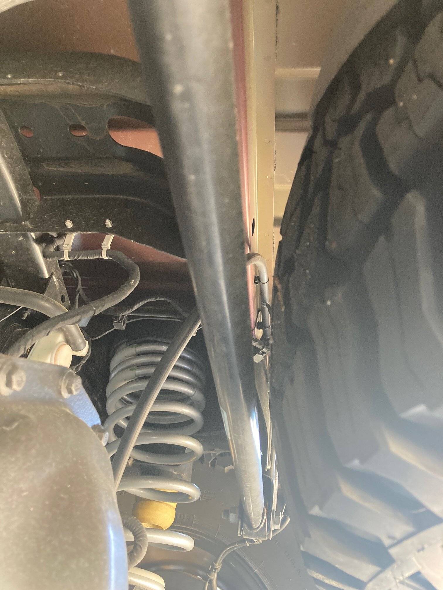

I can confirm that a 37 x 12.50 Milestar Patagonia AT on stock spare wheel
Jeep Gladiator 37” spare tire - list of tires that fit under the bed 20230613_121204
with a Clayton Offroad adjustable trackbar with bend fits. Hits the receiver hitch though.
Jeep Gladiator 37” spare tire - list of tires that fit under the bed Screenshot_20230613_133820_Gallery
Jeep Gladiator 37” spare tire - list of tires that fit under the bed 20230613_121037
