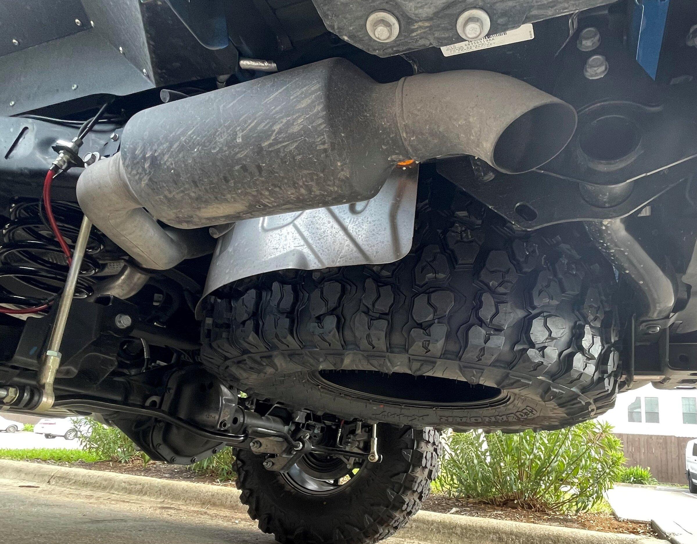

I’m digging the pizza cutter sizing. How long have you run them?
About 3K miles so far. They do HOWL but it is not obnoxiously loud. Hard to sneak up on anyone though. They worked great rock crawling, and did OK in 3+ feet of snow but definitely dug more than floated.

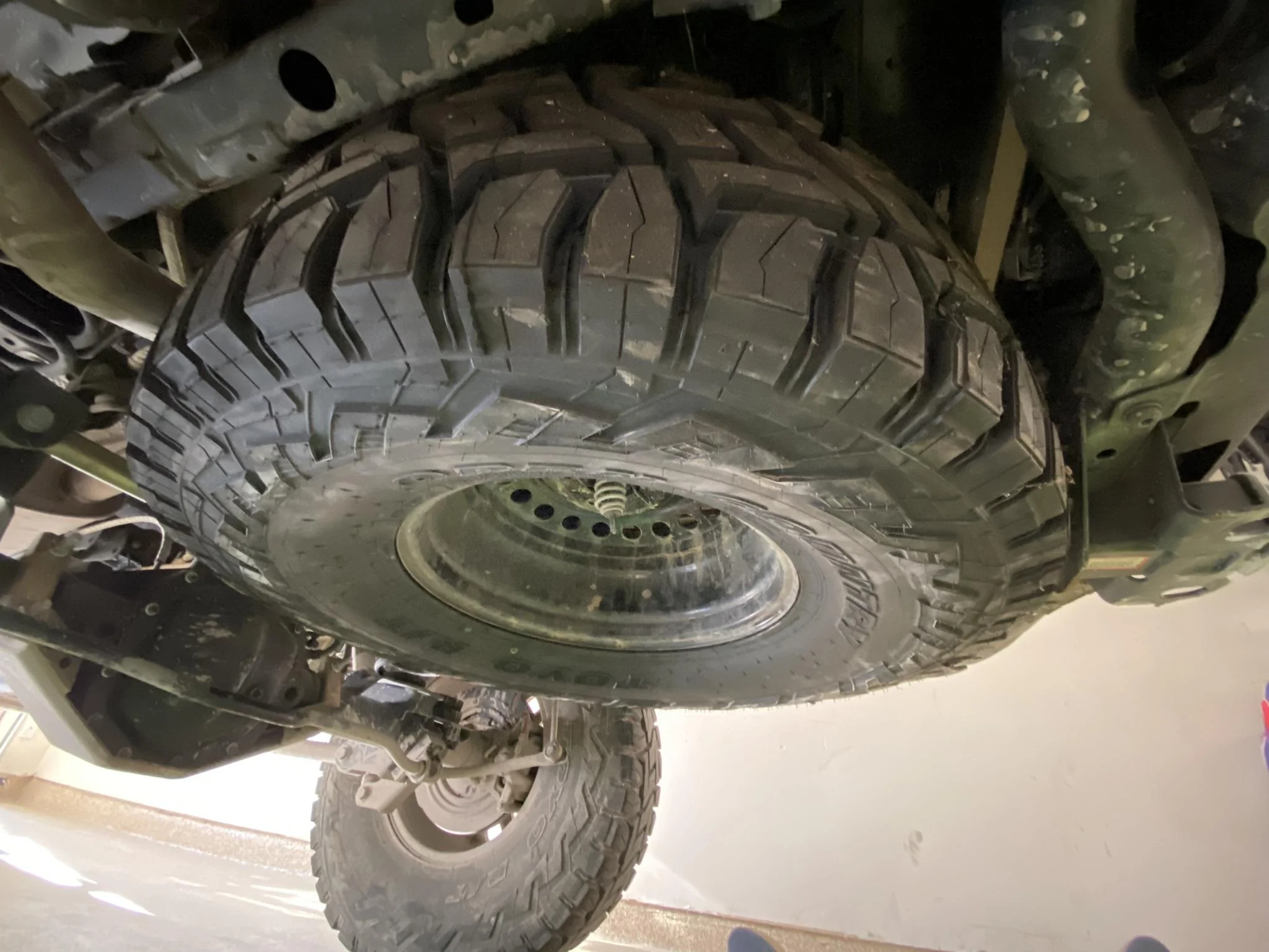

I'm going to try to fit my 37x13.5 Toyo RT under today so I can use my whole bed traveling to the coast. I know it is shown not to fit but I gotta try. Are most of you removing the heat shield? Mine is already removed.

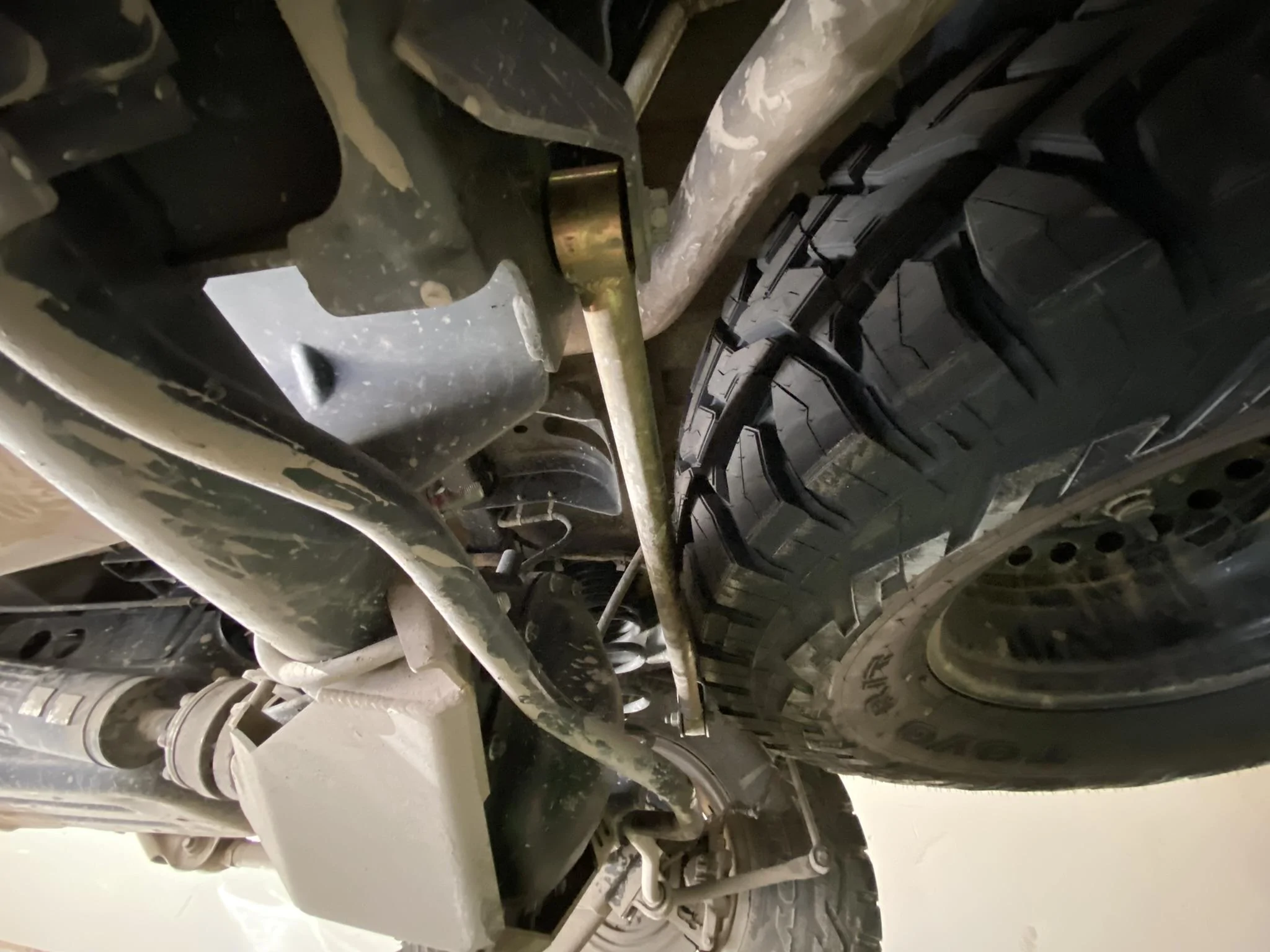

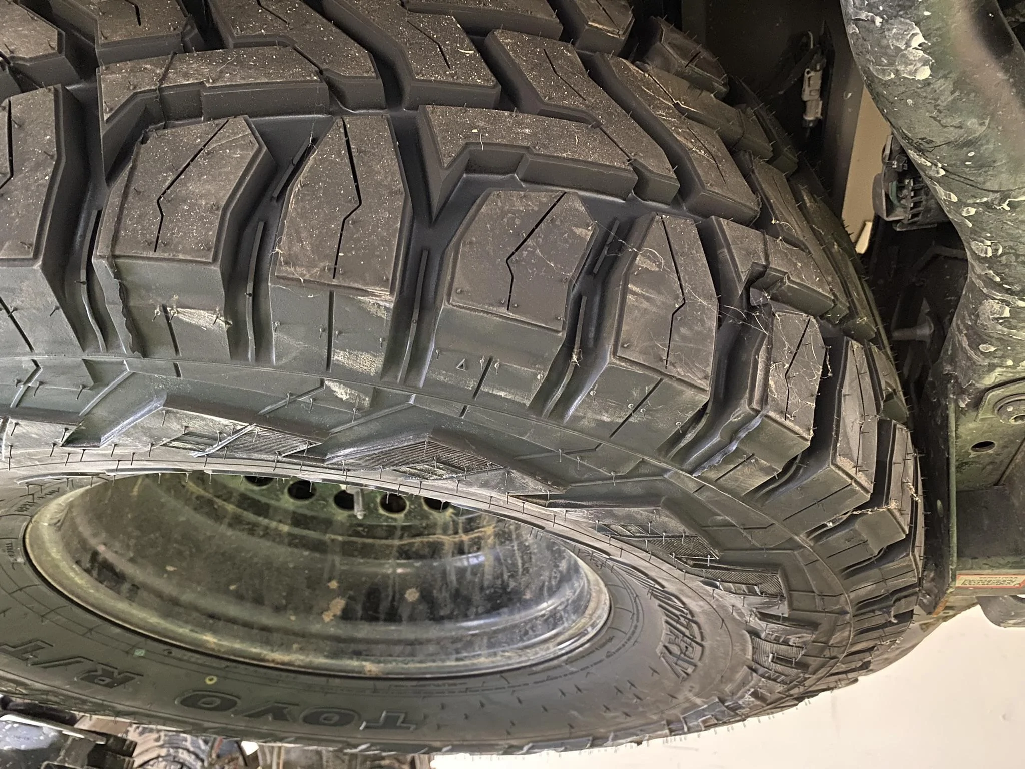

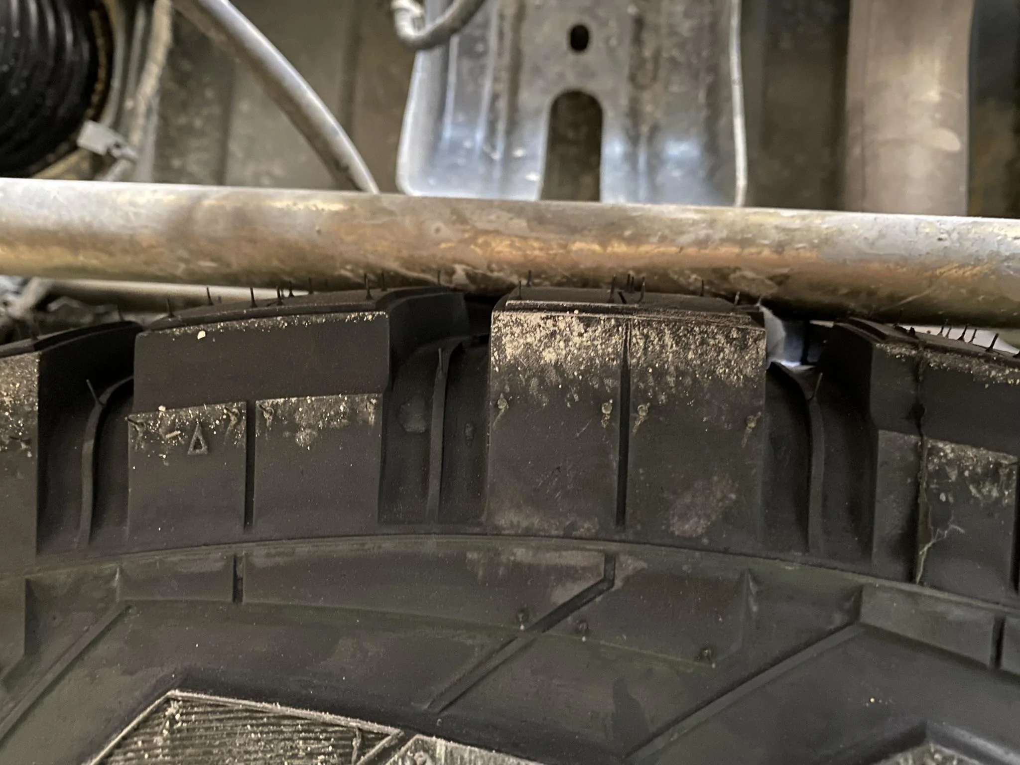

I got it up and under. It is against the MetalCloak gamechanger track bar. I deflated to 15#. Does anyone see a concern with this for daily driving or road trips? I'd remove for wheeling.

I can confirm that the Toyo R/T 37” x 12.5" does not fit in the spare location. I tried it today :(

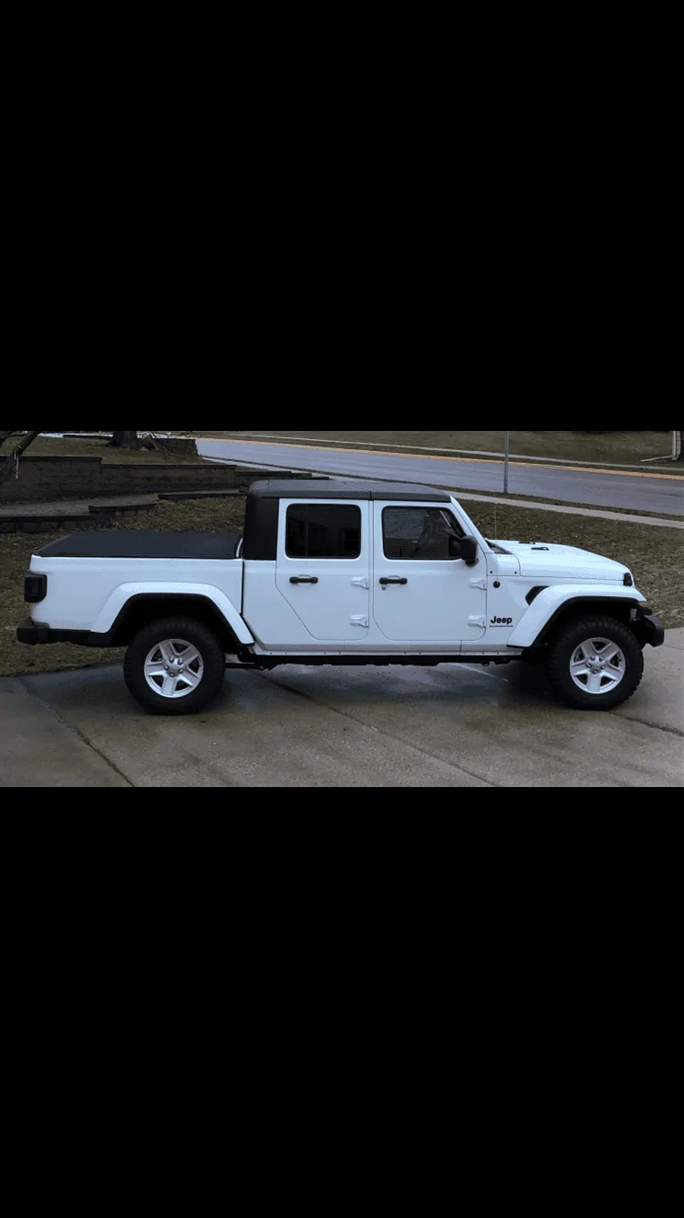

Badak X-treme 37x11.5 fit, 0 psi and lots of cussing. It is true to size 37”.

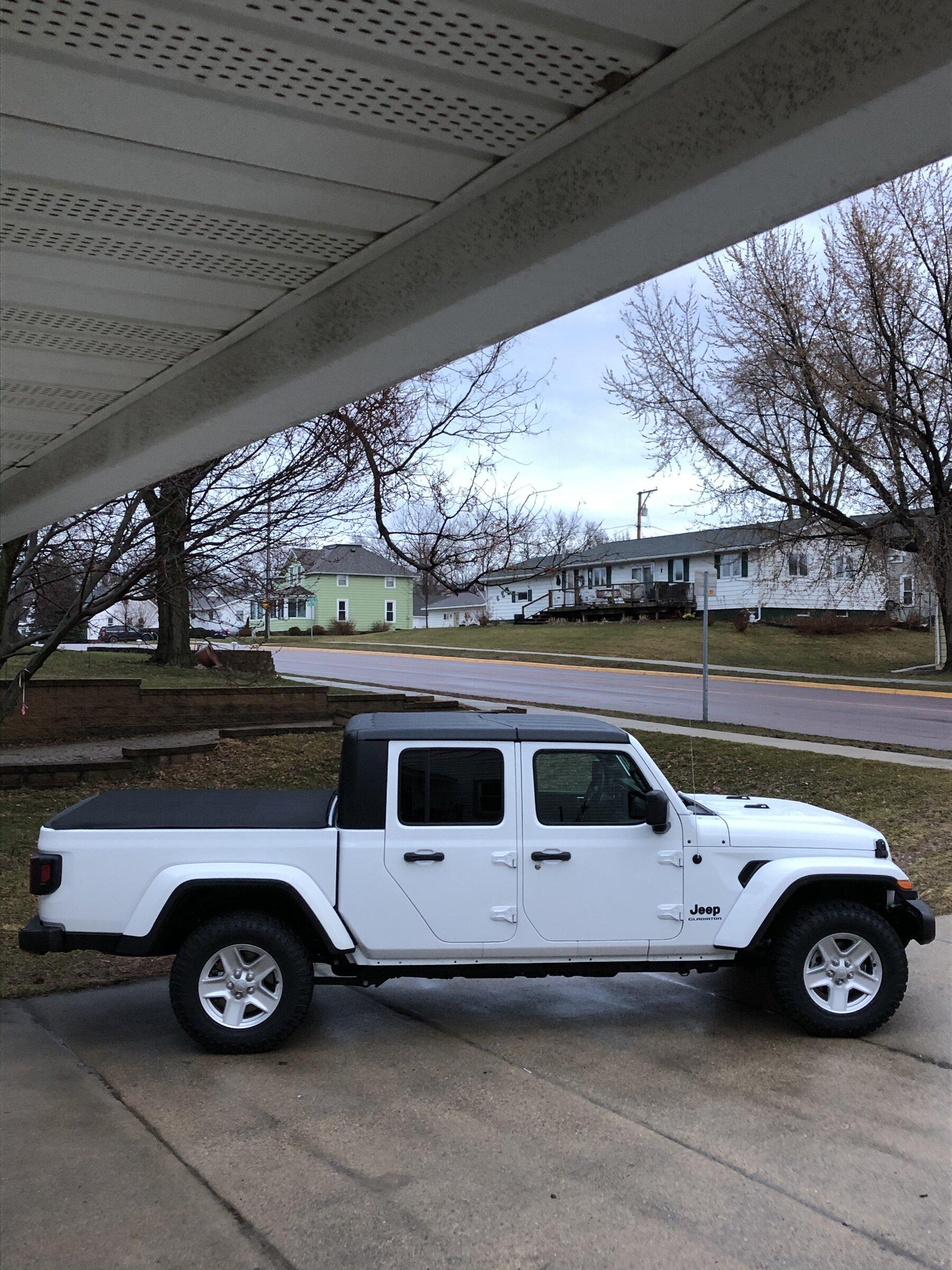

That looks white-ish. My ‘21 is white. Finally getting to the point I can maybe do something to it.
Beastly tires.
I’ve always stayed more narrow also. I’m Thinking about a 3.5” lift and then some simple 315’s.
Probably Patagonia’s because they’re damn affordable.
