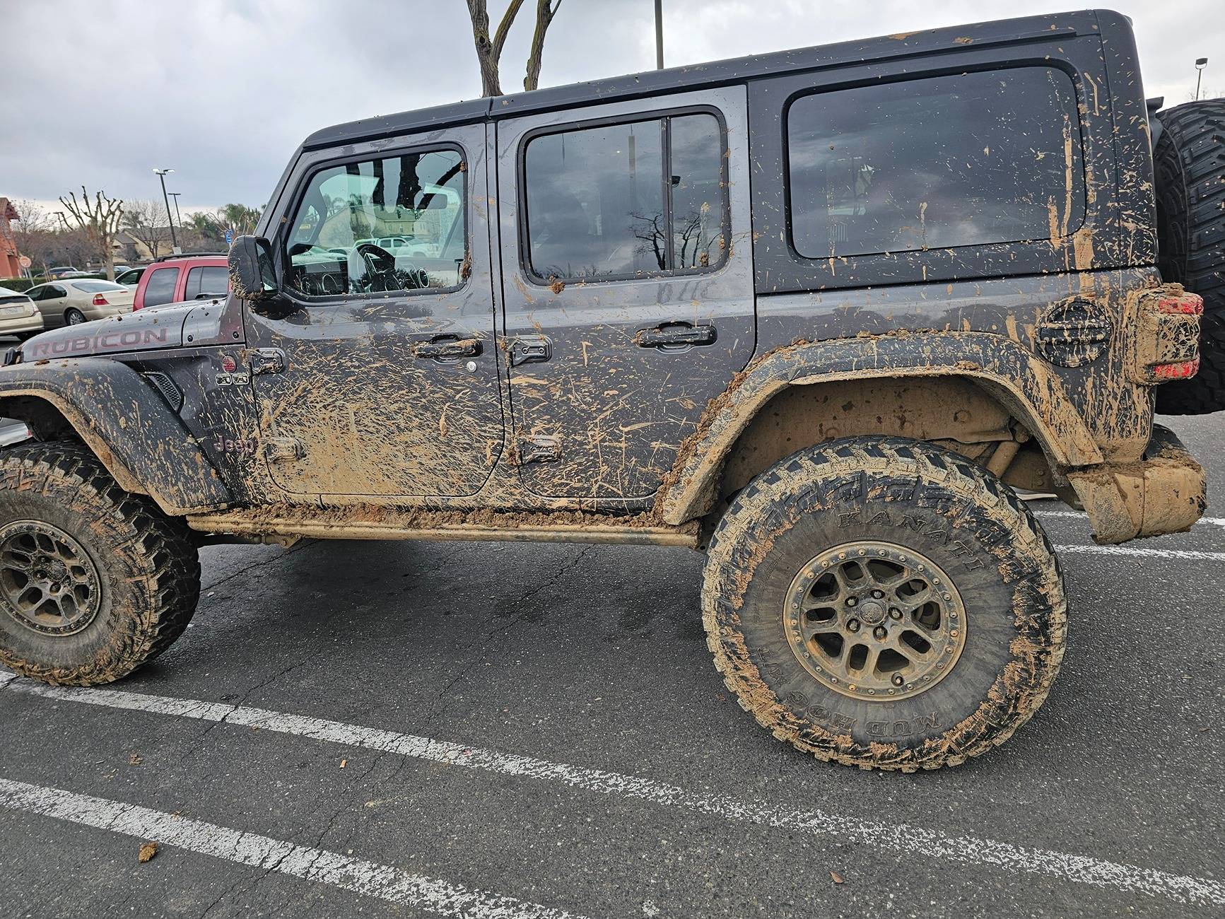

39x12.50r17 kanati mud hogs have been great on the JLUR. Not sure it would fit under the JT but I was impressed enough with the 39s that I run them in a 37 on the JT and that fits with room to spare. A much better option than the 39" ko2s that are both smaller and wildly over priced.
