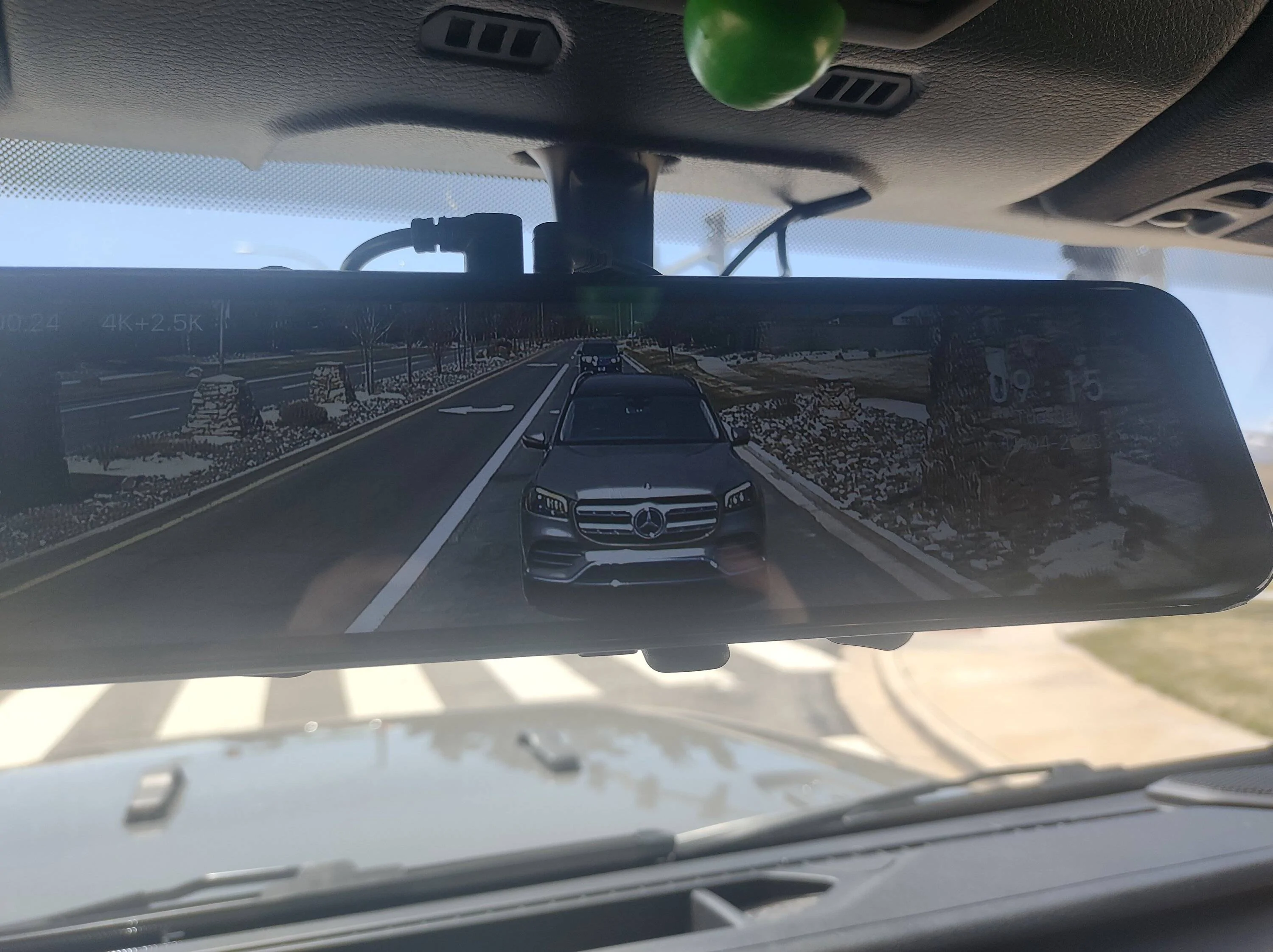

I tapped into the fuse box. Cigarette lighter fuse for switched power and USB ports for power all the time. Used a piggy back fuse splitter. Worked fantastic. It was used for my rearview mirror camera. Ran it up the pillar and across behind the windshield above and tucked into the fascia. Dropped it out the front right next to the mirror

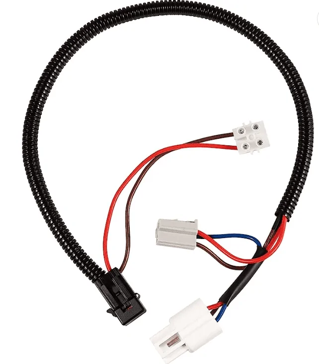

You can also use that 12v outlet extension that comes with a feed pigtail. It would be ign switched, but it's what I used to power the controller for my snow plow since I wanted it off with ign off.
https://www.amazon.com/gp/product/B087KP7QJH
It has a fused power, and a ground lead in a handy connector.
