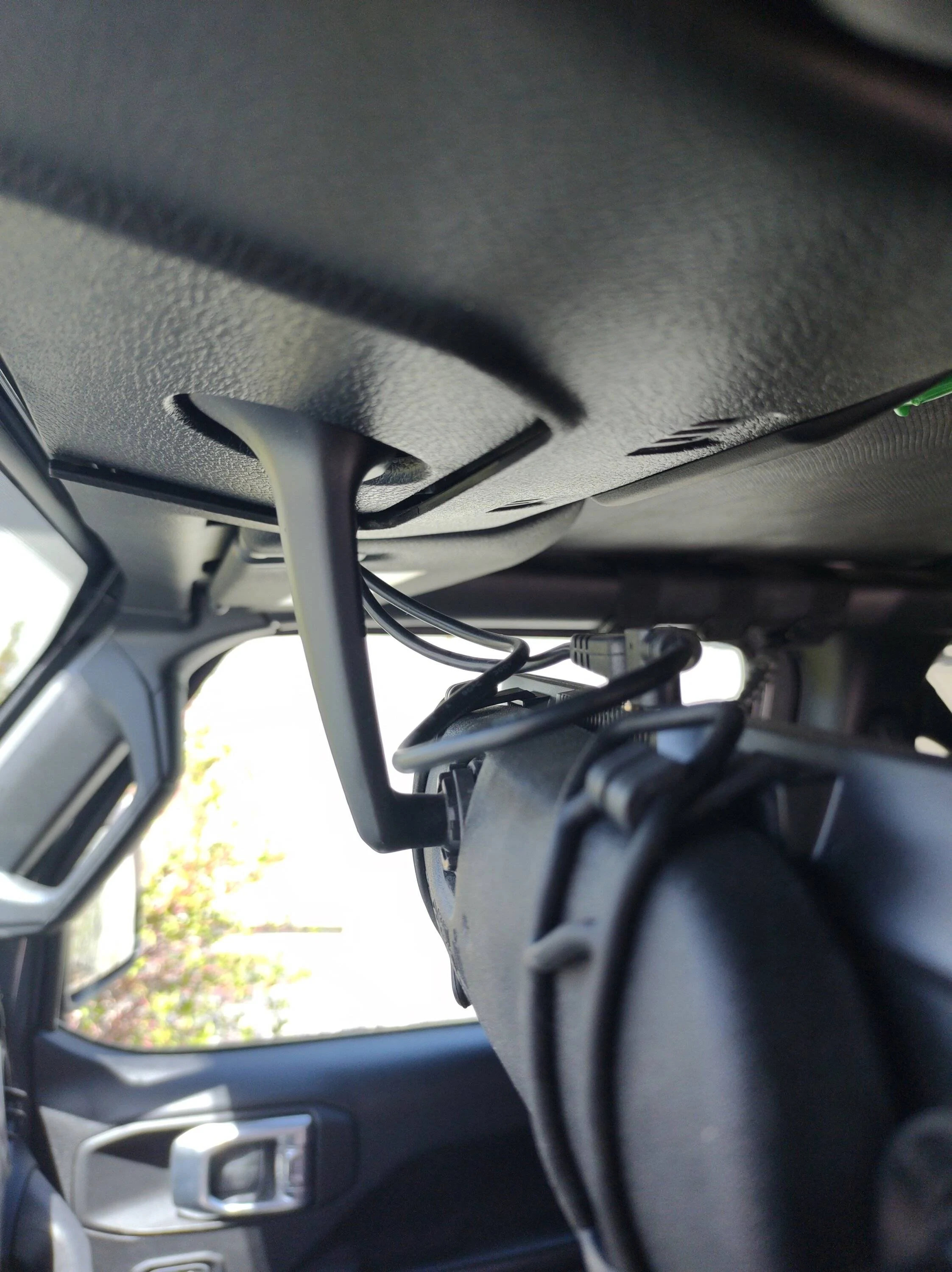

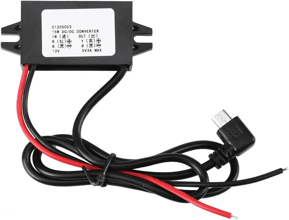

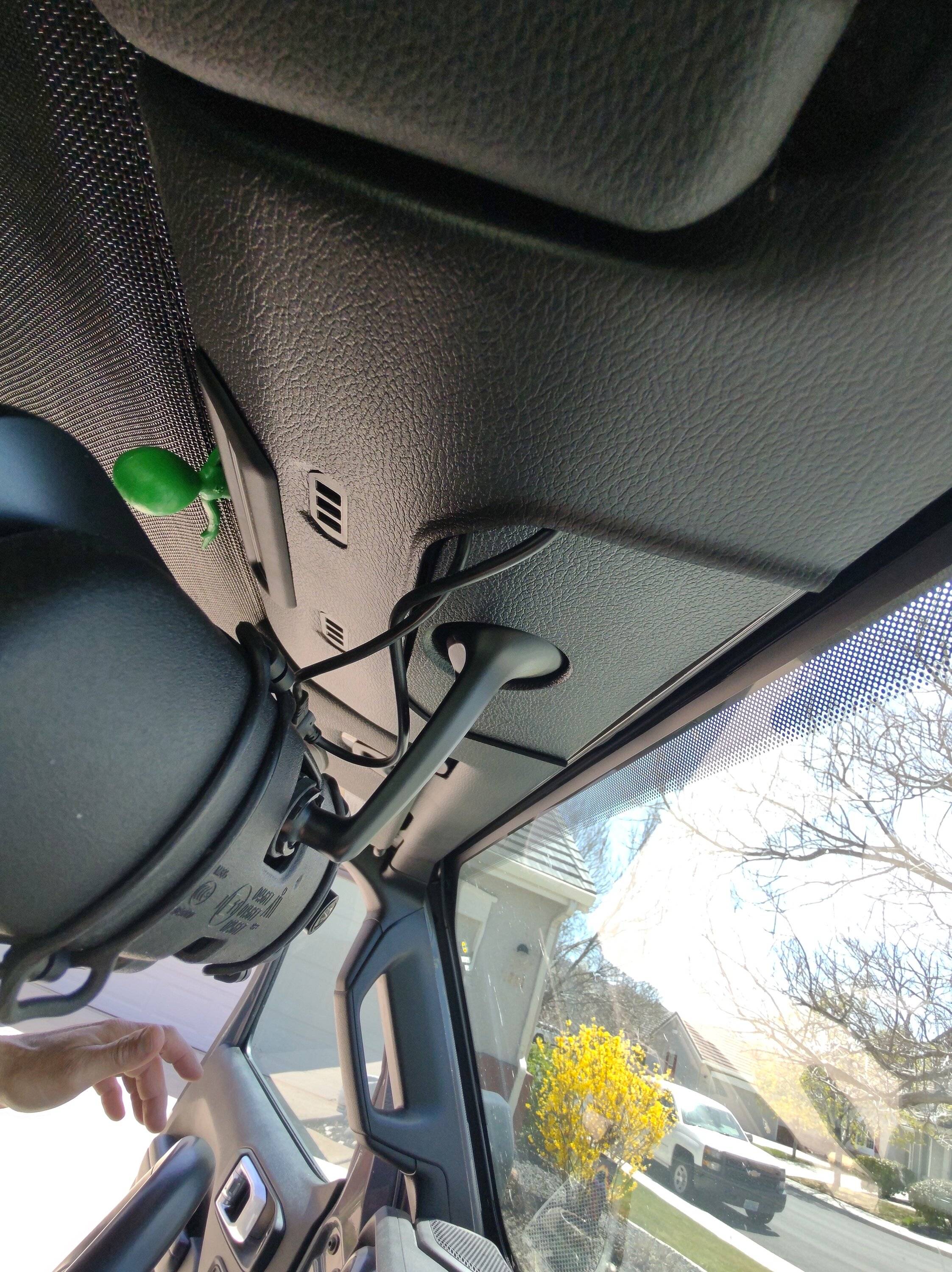

I tapped directly into my auto-dimming rear view mirror power. Undo the plastic trim piece behind the mirror, clip the wires, connect the converter (12v to 5v microUSB), and it turns on/off with ignition. The trim piece won't fit in there as well as it did before, but the camera is behind the rear view mirror. Out of all the options I researched on here, that was the best way.
Jeep Gladiator Powering a dashcam ? 1682632394689
https://www.amazon.com/gp/product/B07H7X37T6/ref=ppx_yo_dt_b_search_asin_title?ie=UTF8&psc=1

firemedic2714
Scotty P
Oct 24, 2018
464
488
St. Louis, Missouri
20 JT Rubicon, 19 Genesis G70, 1972 Ford LTD coupe
Firefighter / Paramedic
Not the OP, but thanks for posting all the answers. I've been contemplating a dashcam, too.
