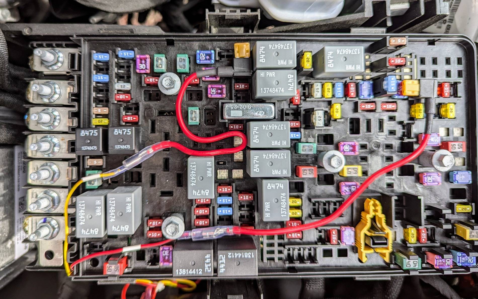

Here's where I powered my Wolfbox G930 mirror dashcam with the hardwire kit. (I have a 2023 Diesel Rubicon.)
Jeep Gladiator Dashcam wiring PXL_20240801_160224208~2
Accessory power from fuse F52, Cigarette Lighter.
Continuous power from fuse F98, SW Bank.
Note the orientation of the fuse taps. This orientation puts the new fuses in parallel with the original fuse.
If you are using fusetaps that come with fuses make sure they are a suitable size. My fusetaps came with 15A fuses where 2A or 3A would be more appropriate. I have 5A installed until I come across some 2A or 3A

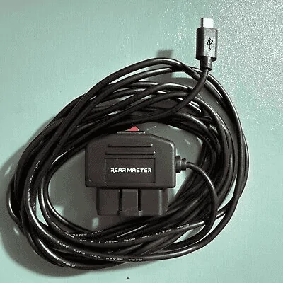

I have a few power cables that power off of the obd2 port. They work well. There is a switch on it that you can turn off the constant power and use it with ignition power. They come in micro usb, mini usb and type c that I know of. Bought mine in 2021. They all still work as they should.
