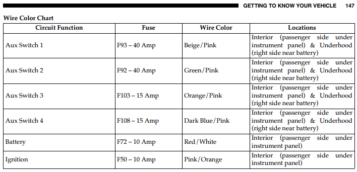

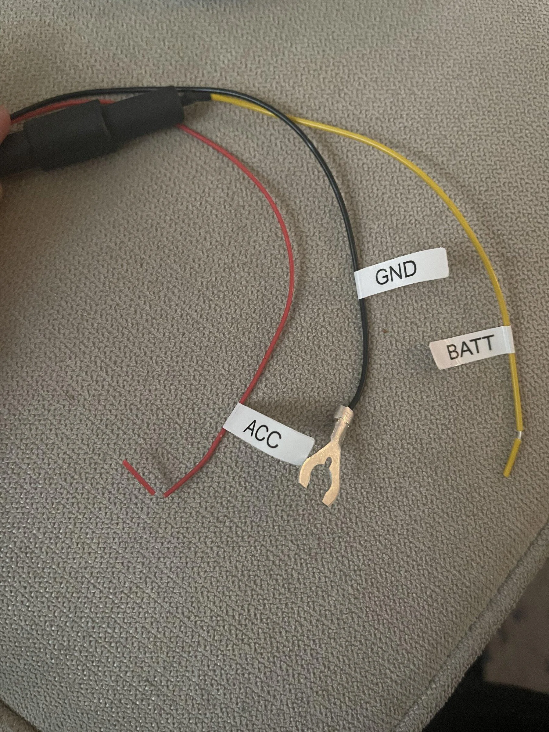

Alright, electrical is one thing that makes me nervous. Can anyone confirm my approach for my Garmin Mini 2 dashcam install?
below pictures are of the wiring harness for the parking monitor function, and the diagram for the factory installed aux wiring.
To avoid going to the fuse box, can I connect the two battery wires and the acc wire (dashcam) and ignition wire (aux wires) without fear of a catastrophic problem? Thanks in advance for your input!

Just connect:
BATT (Yellow on dashcam) to Battery (Red/White on Jeep)
ACC (Red on dashcam) to Ignition (Pink/Orange on Jeep)
And ground it out to a grounding post or bolt.

Just connect:
BATT (dashcam) to Battery (Jeep)
ACC (dashcam) to Ignition (Jeep)
That was the idea I was going for. Thanks for the confirmation!

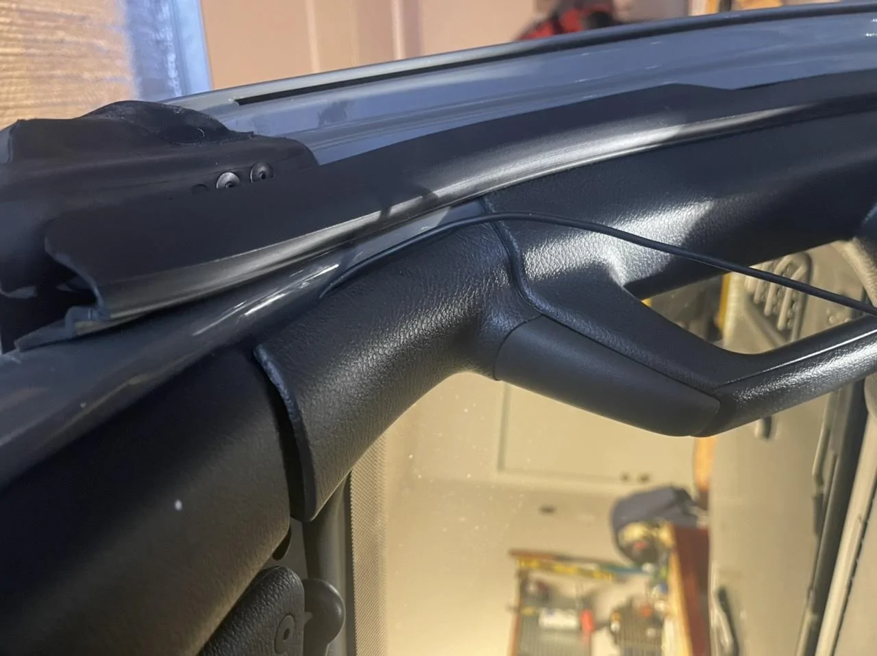

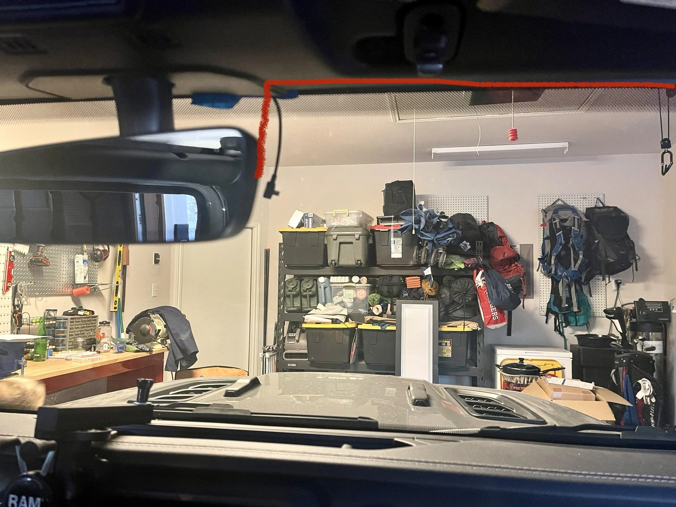

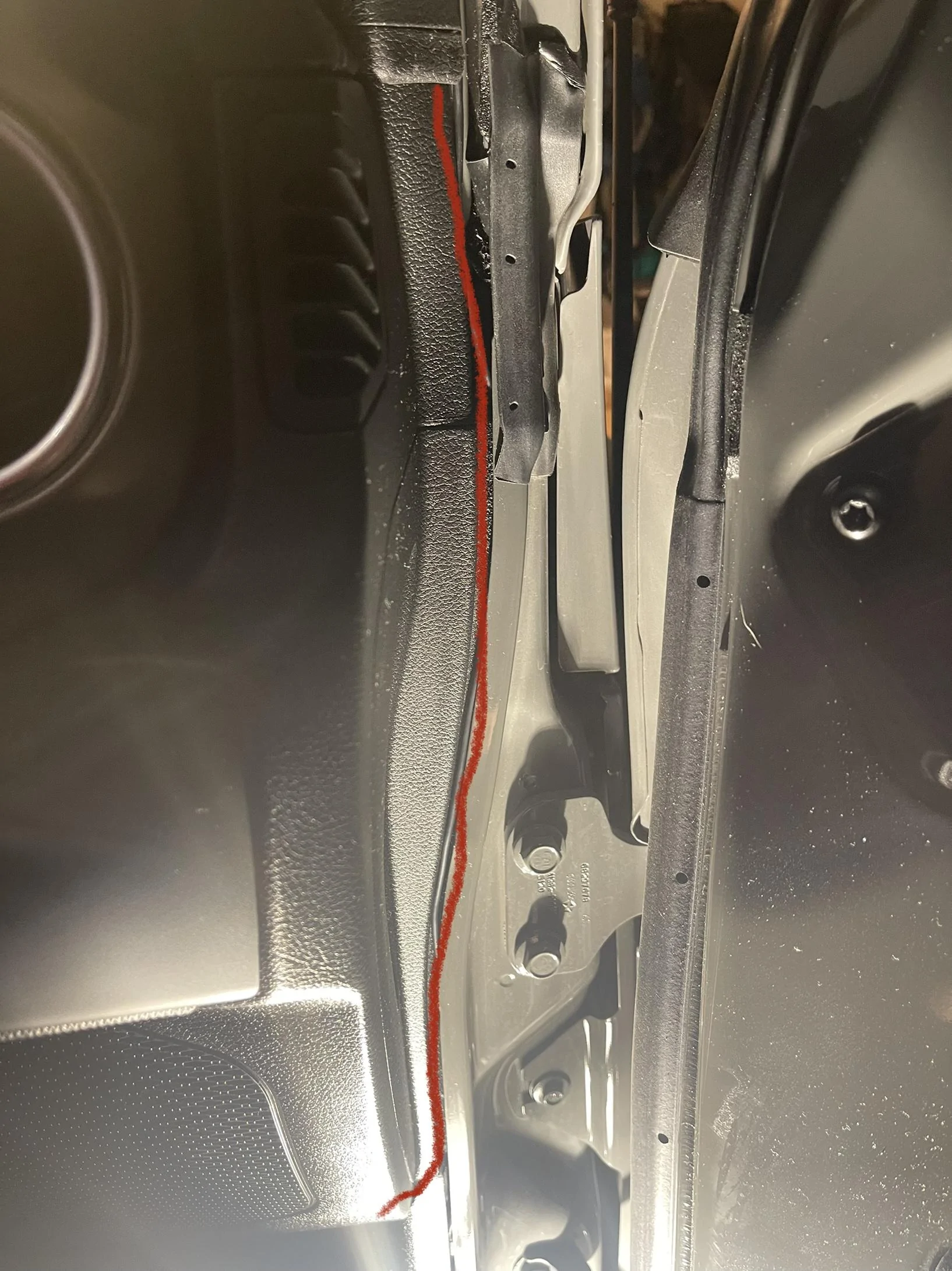

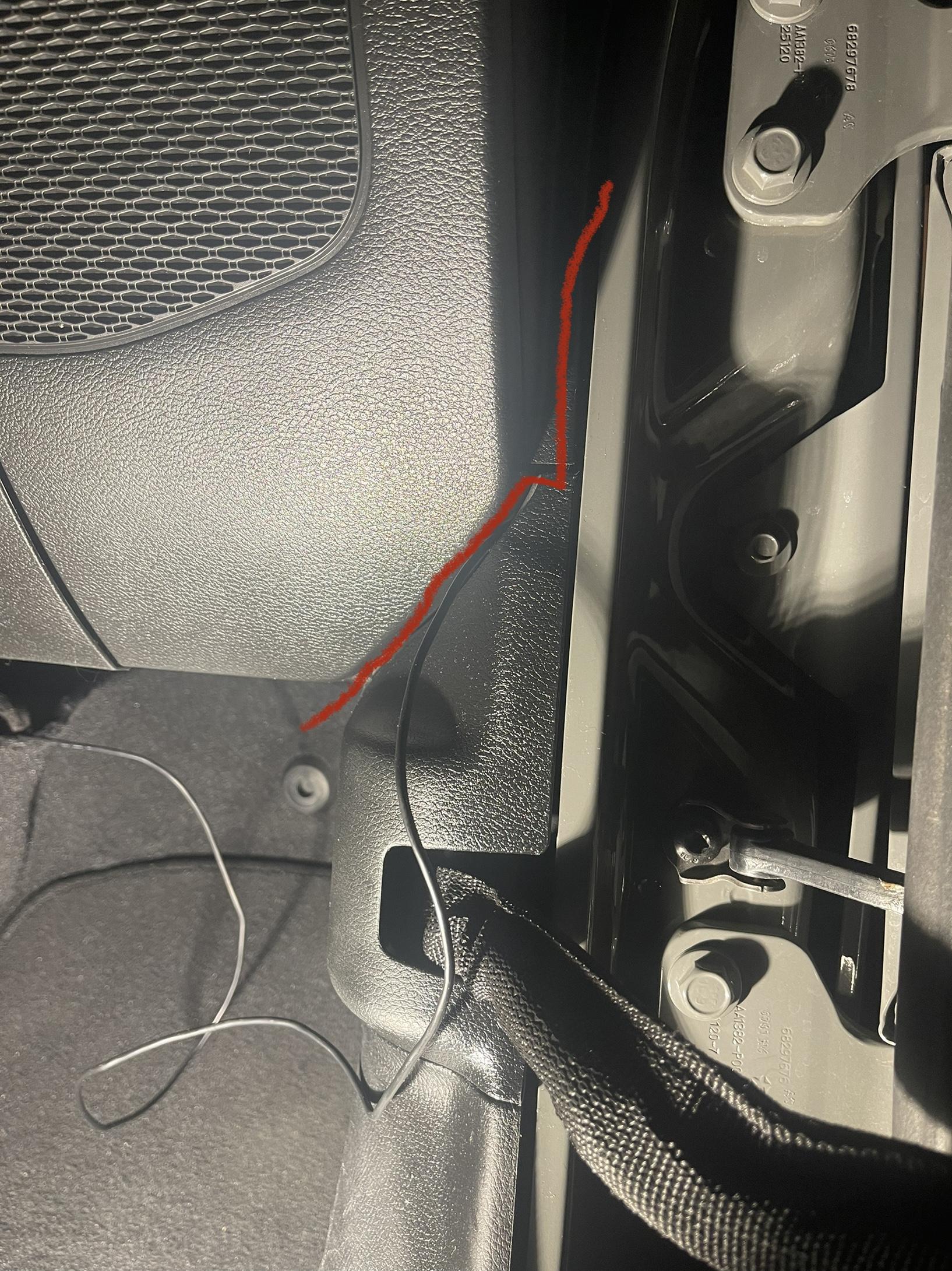

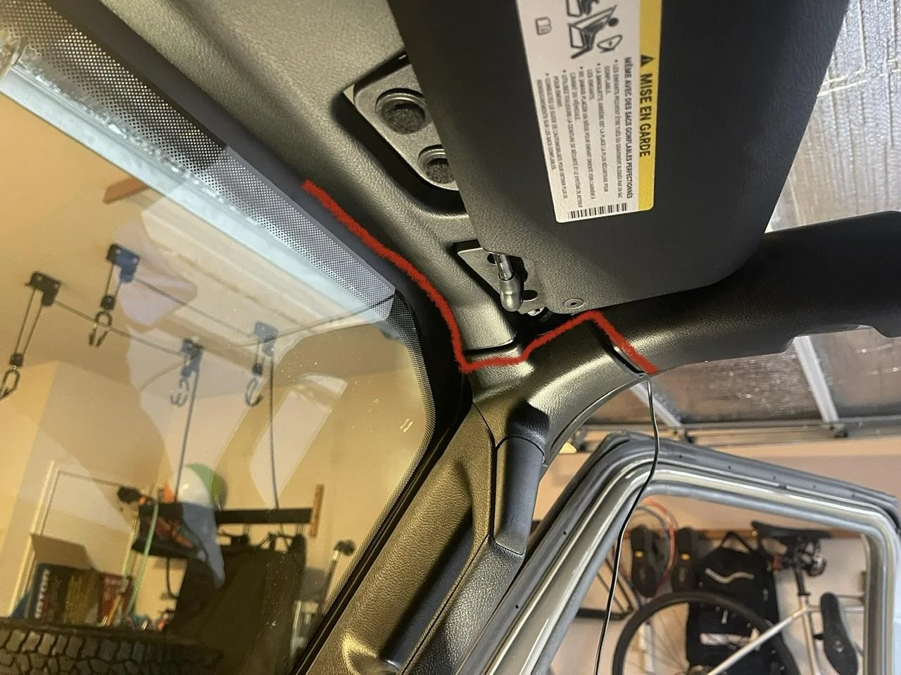

As promised. Don’t judge the condition of my garage. It’s organized, you just can’t tell.
This is the best route I found. It gets tight in spots, just pull back on the panels a bit and itll go. I don’t believe there is any visible wire if you do it this way.
There was a nice spot to attach the ground wire when you pull back the carpet near the aux switches. enjoy!

Turn you head 90 degrees. Idk what happened with this photo.
Jeep Gladiator Dashcam wiring question C98D7EB1-8851-4356-9D5C-5D2105085583
Jeep Gladiator Dashcam wiring question D6BBBB2B-3C5F-4ABB-9A9F-990987AC5E6B
Tuck the rest behind the carpet and you're golden
