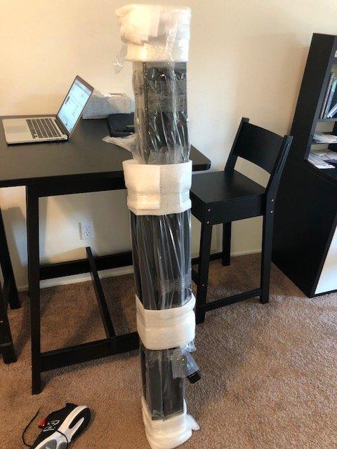

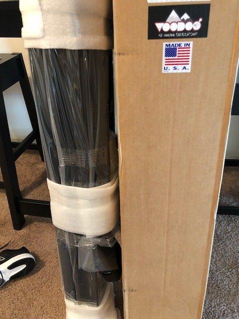

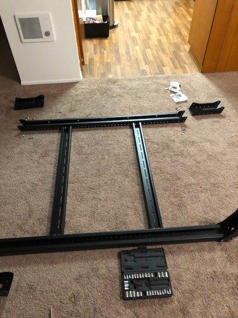

Here are pics of how it's shipped with everything laid out. I'll update this thread when my vehicle actually arrives someday!
The packaging is top notch and all the painted aluminum bits arrived in perfect condition.

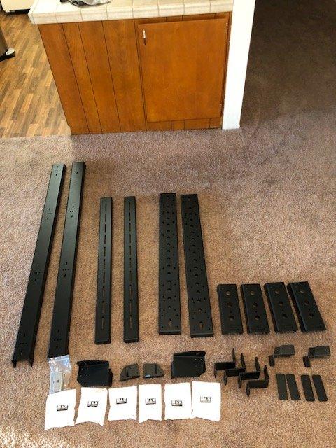

Everything laid out looks like not much.
The directions are lacking. Just use some common sense when assembling. Also, use anti-seize on everything that is part of the stainless hardware. Use WD-40 to remove any anti-seize that gets on painted bits.

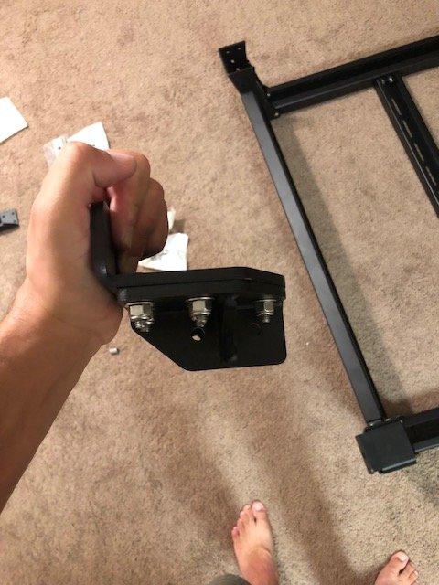

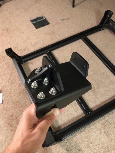

Pictured below is one of the rear brackets that allow for relocation of the mounting point when using a tonneau cover on JT's with the Max Modular.

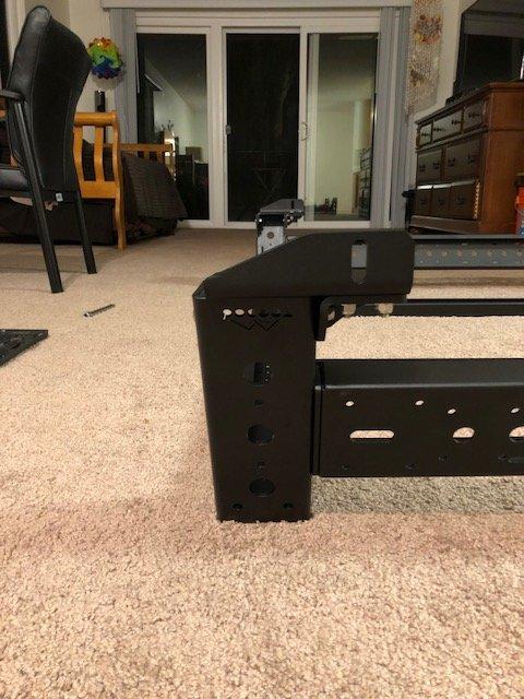

The left side of the picture below shows the rack orientation with the brackets for tonneau relocation.

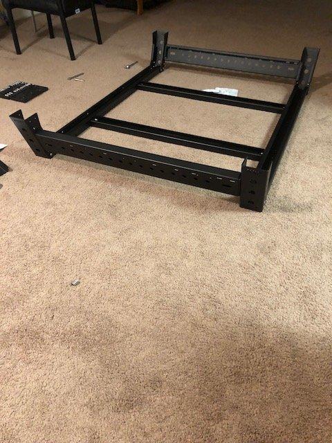

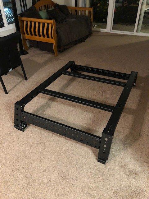

Pictured below is a rack in search of a truck to get mounted on...soon.
I'll follow-up with an installation section w/ photos.
