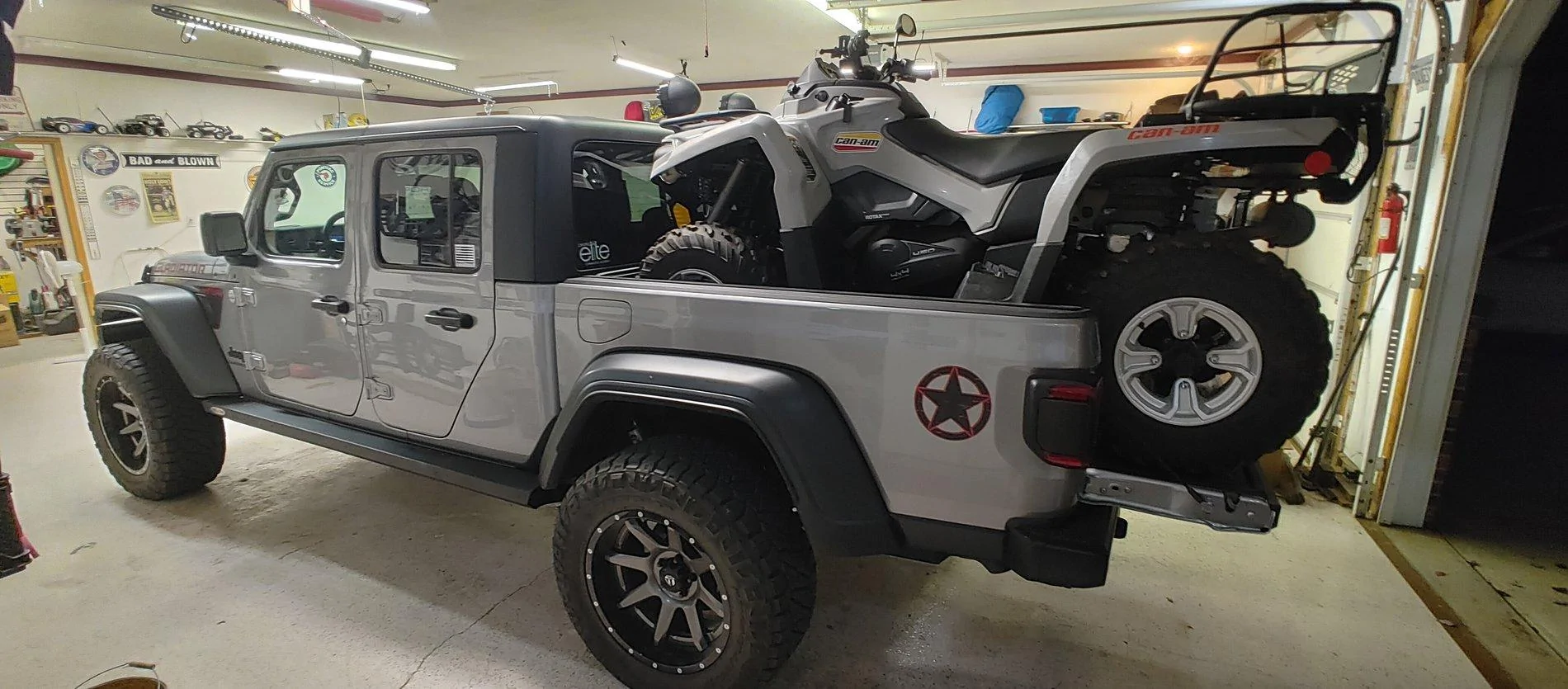

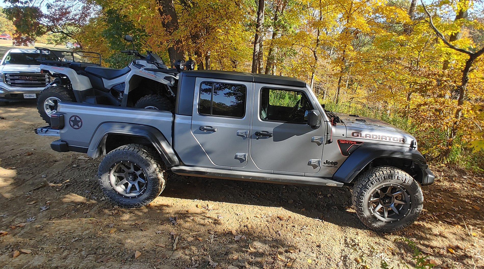

I ran 1.5" front spacers, 0.75" rear spacers, and 35x12.50s on my Max Tow. It articulated just fine and I hauled and towed big weight with it. Even did some videos with FULL payload capacity on it, and also towing near the max with it.
