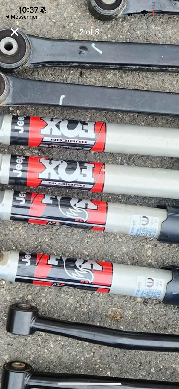

Hey everyone, I have a 22max tow. I am going to be buying some Rubicon take off suspension parts. What’s parts are an upgrade for the max tow and what part are the same or are not? From what I understand the max tow has stiffer stronger springs.
I’ll be picking up Rubicon FOX Shocks, Springs, Arms, Track Bar, Sway Bar.
I am thinking the shocks? Are the arms, track bar and sway bar different from what I have or an upgrade?
New to the jeep space so I appreciate any help!

20-23 rubicons had fox shocks. Mojave has fox shocks but they are the reservoir ones.
Jeep Gladiator Max tow with rubicon suspension upgrades? IMG_4125
