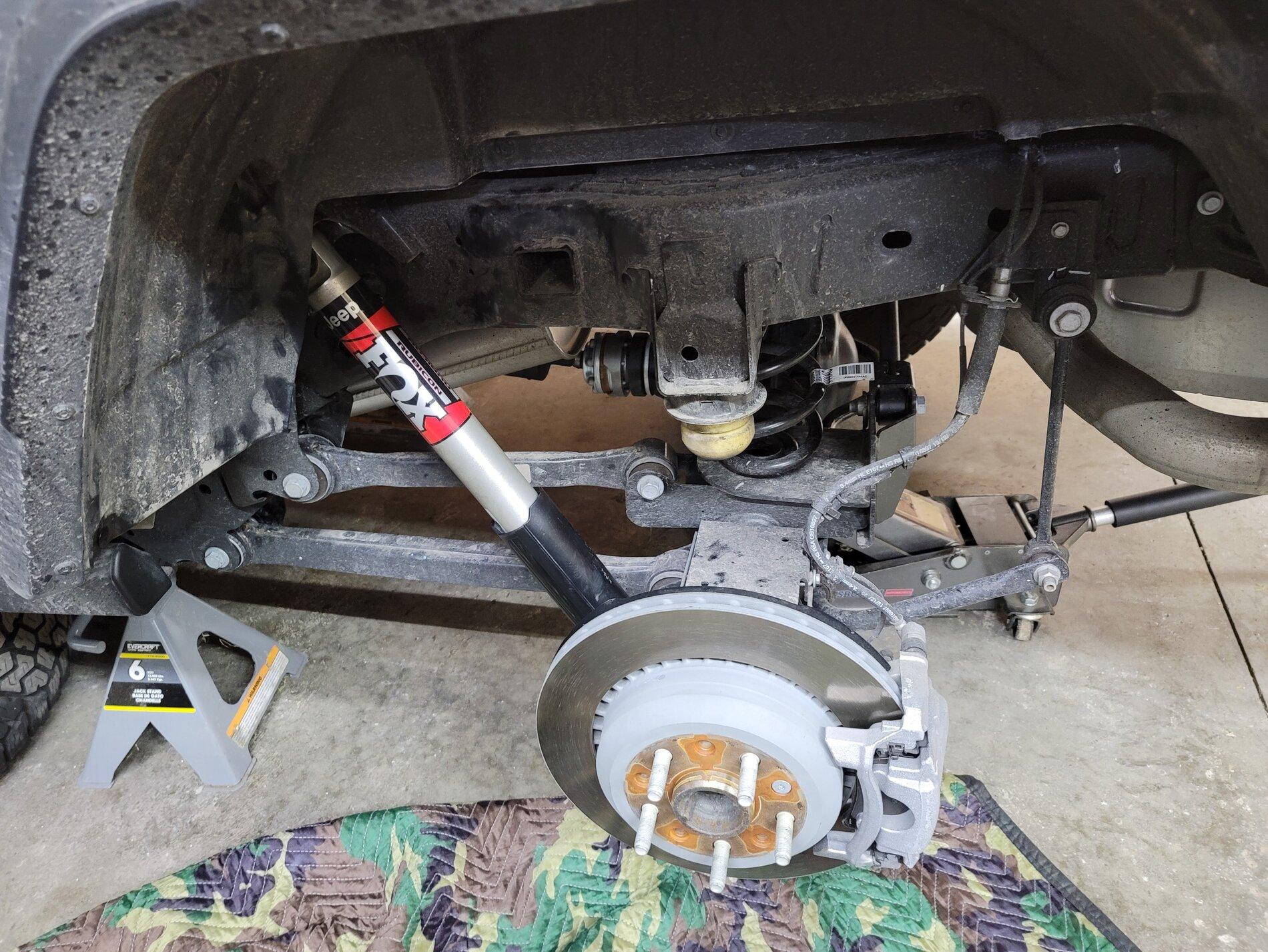

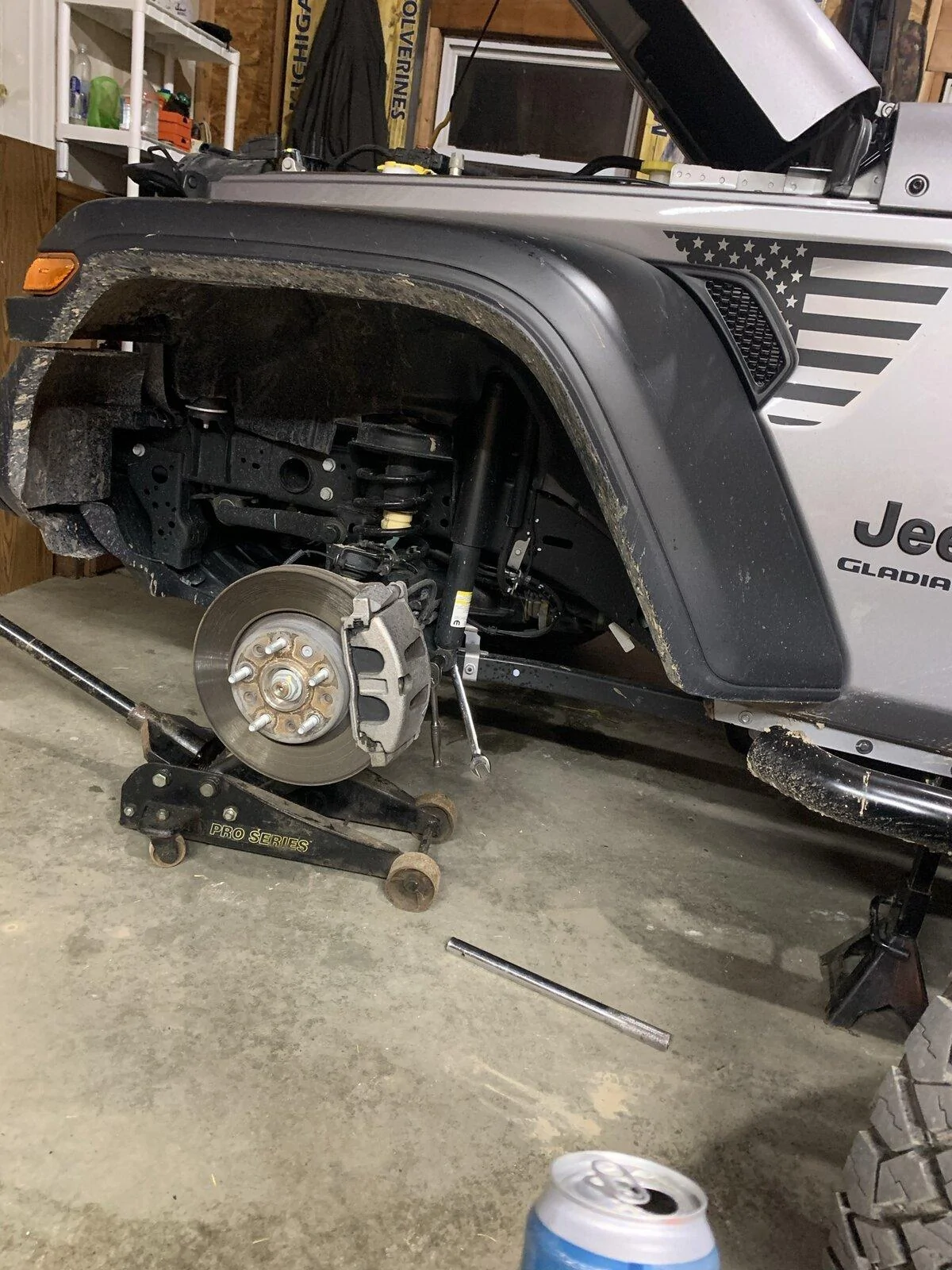

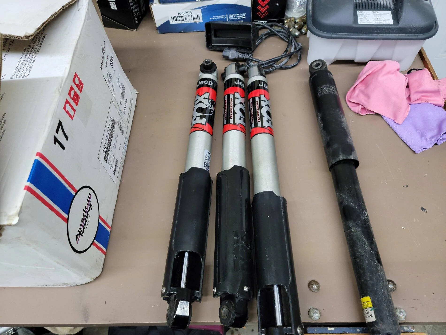

Picked up my Rubicon takeoffs this weekend and got them put on my max tow. The upgrade is worth every penny, its hard to explain the difference. I saw someone compare the ride before the upgrade to being in bounce house :LOL: that feeling is gone for sure with the upgrade. The one inch of lift in the front doesn’t hurt either, we’ll see how much I loose once I install my winch this weekend.

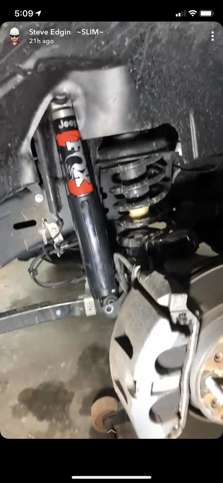

I installed the shocks... I was debating on the front springs. They have the same amount of coils? Did it raise the front? And did u just do shocks and springs?

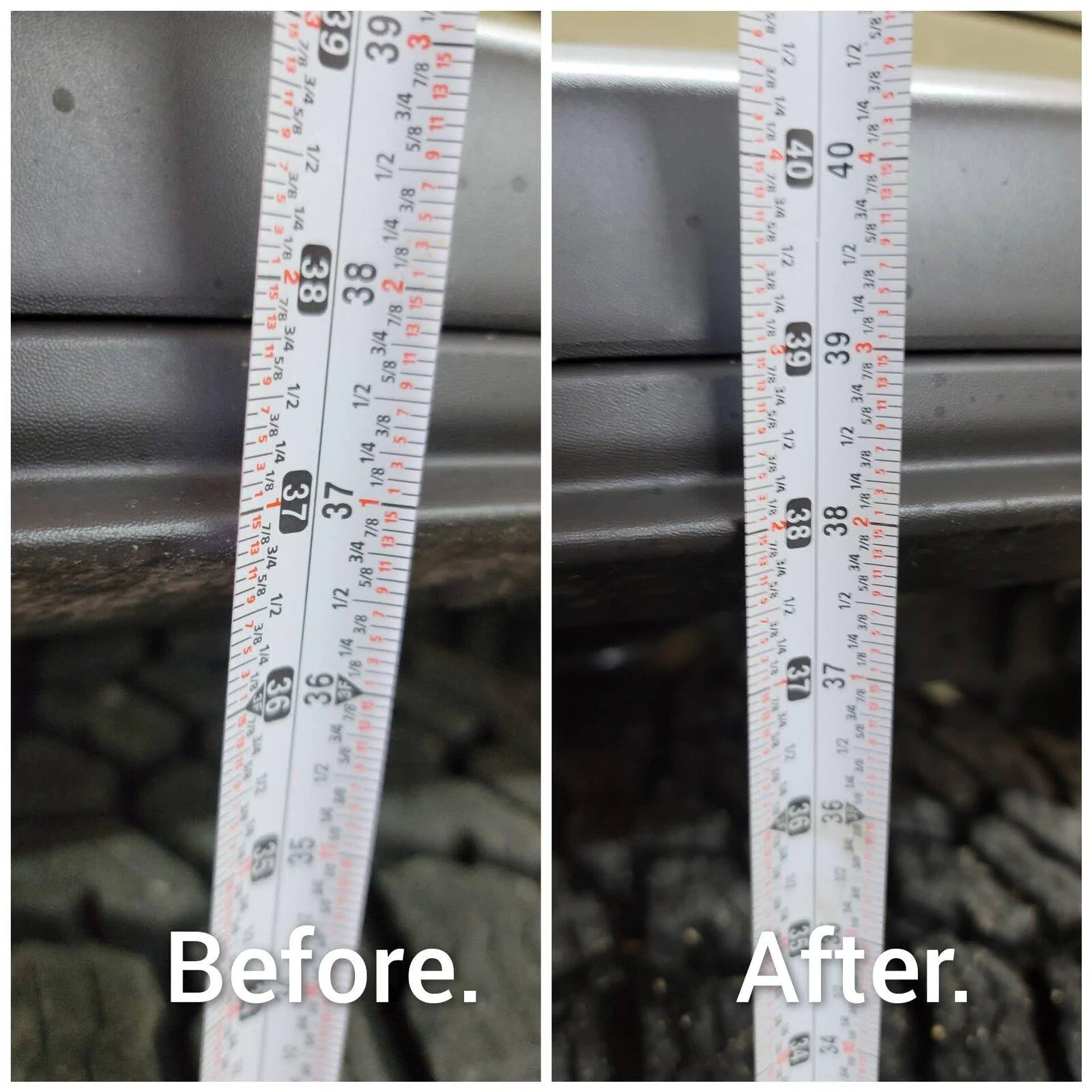

Rubicon springs lifted my Max tow 3/4" in the front but I already had the Badlands Winch and a steel front bumper on mine. Some say it gives 1" of lift in the front. I kept my rears installed on mine because the springs are more progressive on the Max tow and I didn't want to mess with the towing on it. It definitely lifted mine.

A little. It also added an additional .75 inches of lift to the front to help level it out mostly. Still got a little less than 1/4 inch of slope front to rear
