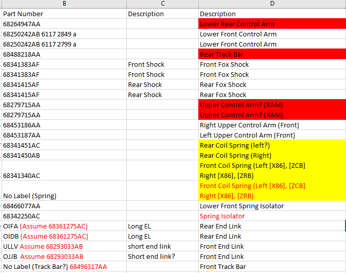

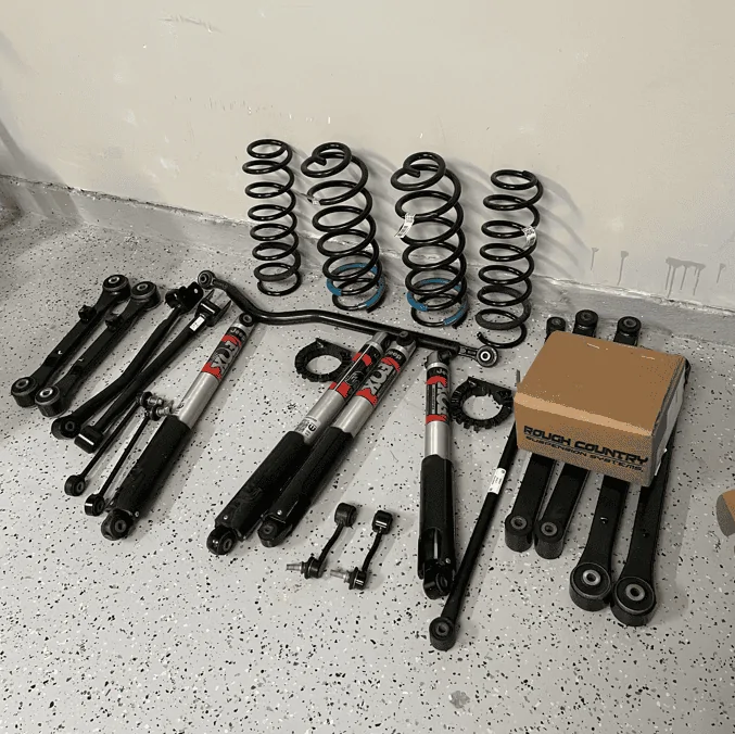

I have purchased the full Rubicon setup from a 2020 Gladiator that includes all hard parts (list below). I can reconcile most similar/same parts with a few exceptions I noted in a quick parts diagram search, can anyone confirm the components highlighted in read are shared between both models or if I should replace my OE with any of these? I have read that it is just springs and shocks that are unique, just trying to plan thoroughly before I start turning wrenches. I have also included a photo of components I have detailed for reference. My plan was intially to replace shocks and springs only, then add the RC 2.5 leveling kit to front to get rid of the rake. Im going to get under the jeep with my tape to measure parts that are higlighted in red.

Update: I felt like the noob in me got ahead of myself with this post. Once under the jeep, I was able to confirm all part numbers highlighted are identical components OE VS Rubicon setup. Shocks and springs it is.

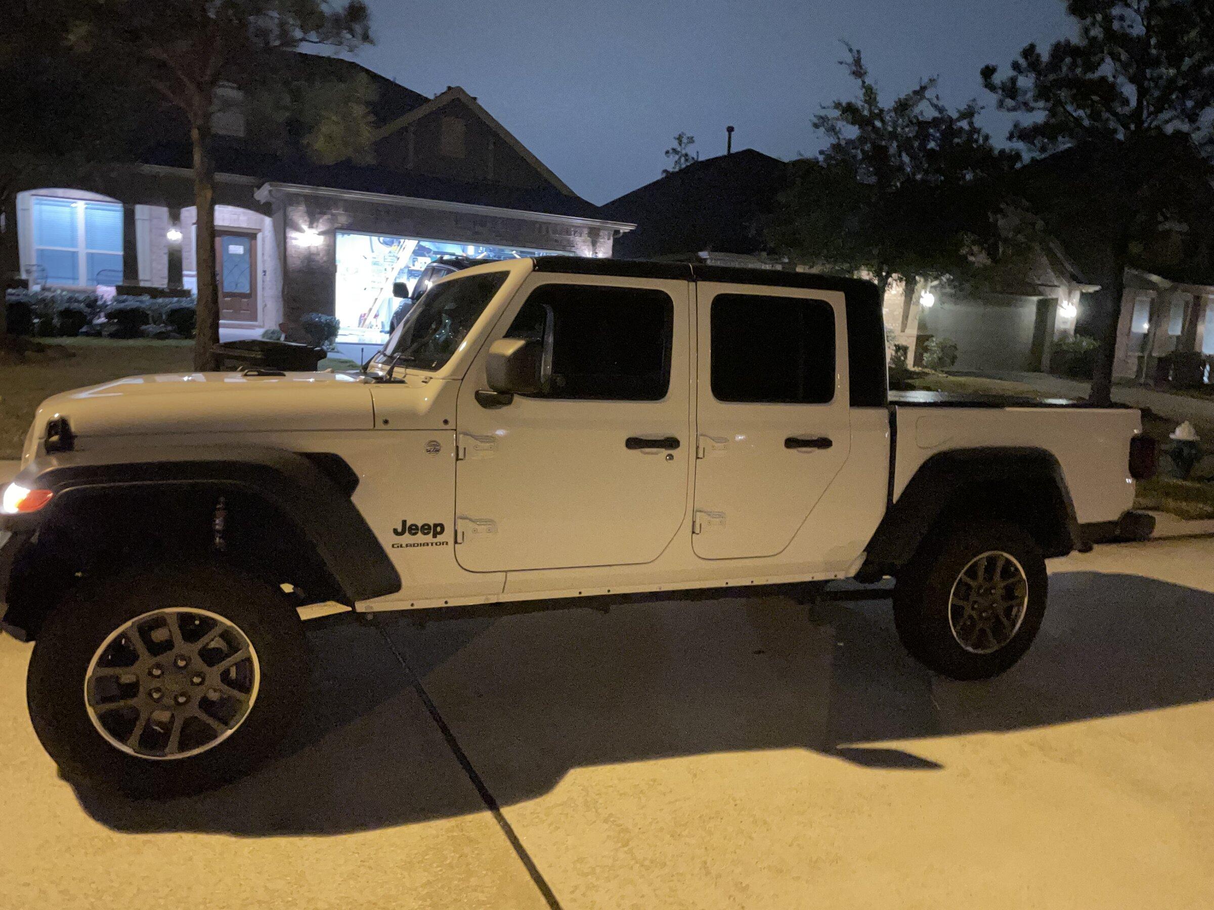

I finished up with the help of a friend in about 6 hours. It was much less than 2K. The entire setup cost me less than 300!

IT was a fairly straight install, definitely either requires a spare set of hands or 2 floor jacks. Im not super knowledgeable on the jeep planform or straight axle (yet) so i printed instructions for full lift install from the RC website and highlighted relevant steps to my build to use as a guide if I got lost, it was helpful keeping me on track.
I will say that it did not provide much of a lift by itself (probably 1-1.5" if that) but I added the RC leveling kit which ultimately gave me what I was looking for.

I don't really tow anything, I have been driving a BMW i3 (electric sub compact) for years without the need so I cant imagine requiring the full payload. I think most Max Tow folks who actually tow elect to keep the stock springs and only upgrade the shock to prevent and degradation in tow performance. I can tell you that there is no net height effect gained by swapping springs that I can see, the springs appear to be same height.

I dont know, but from what I have read, as long as you leave the Max Tow Springs in the rear, should not impact capability.

It looks great! Just need the Rubi rock rails or something on the side. I don't like how you see the rocker pinch joint on the sports.

I did this upgrade on my Max Tow.. Only parts you should change are the shocks all around & just the front springs. The max tow rear springs are already better then Rubicon rear springs. You can also add the Daystar 3/4" front spacers which are about 40 bucks on Amazon and end up with an almost completely level truck.
