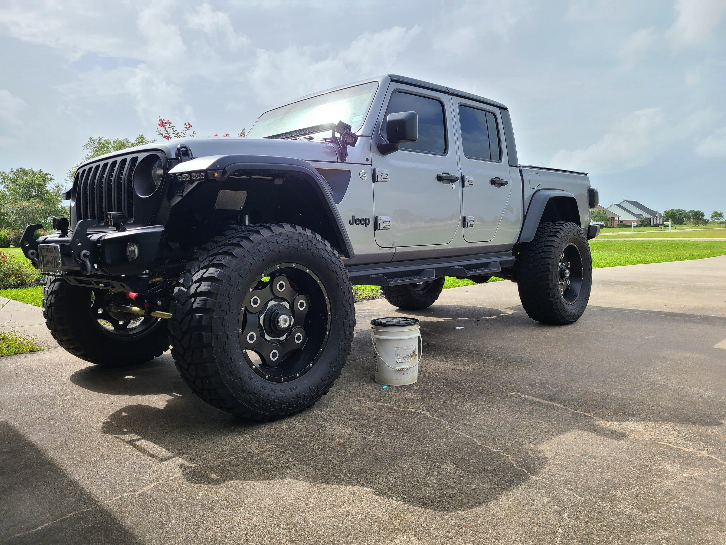

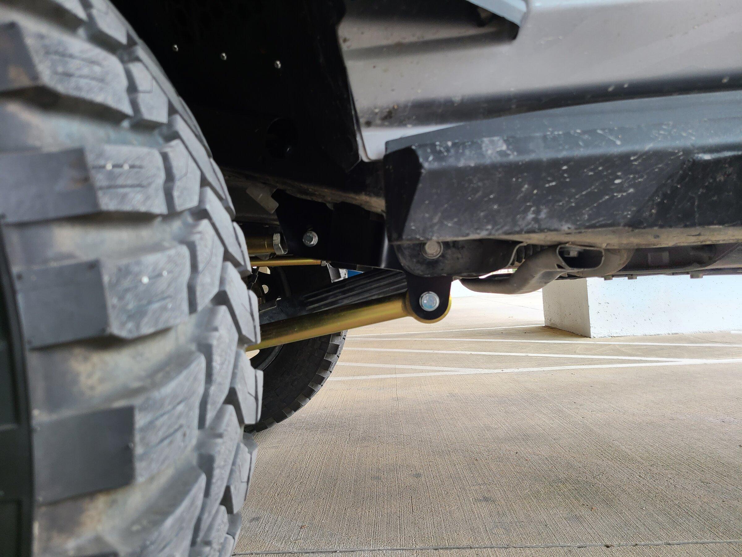

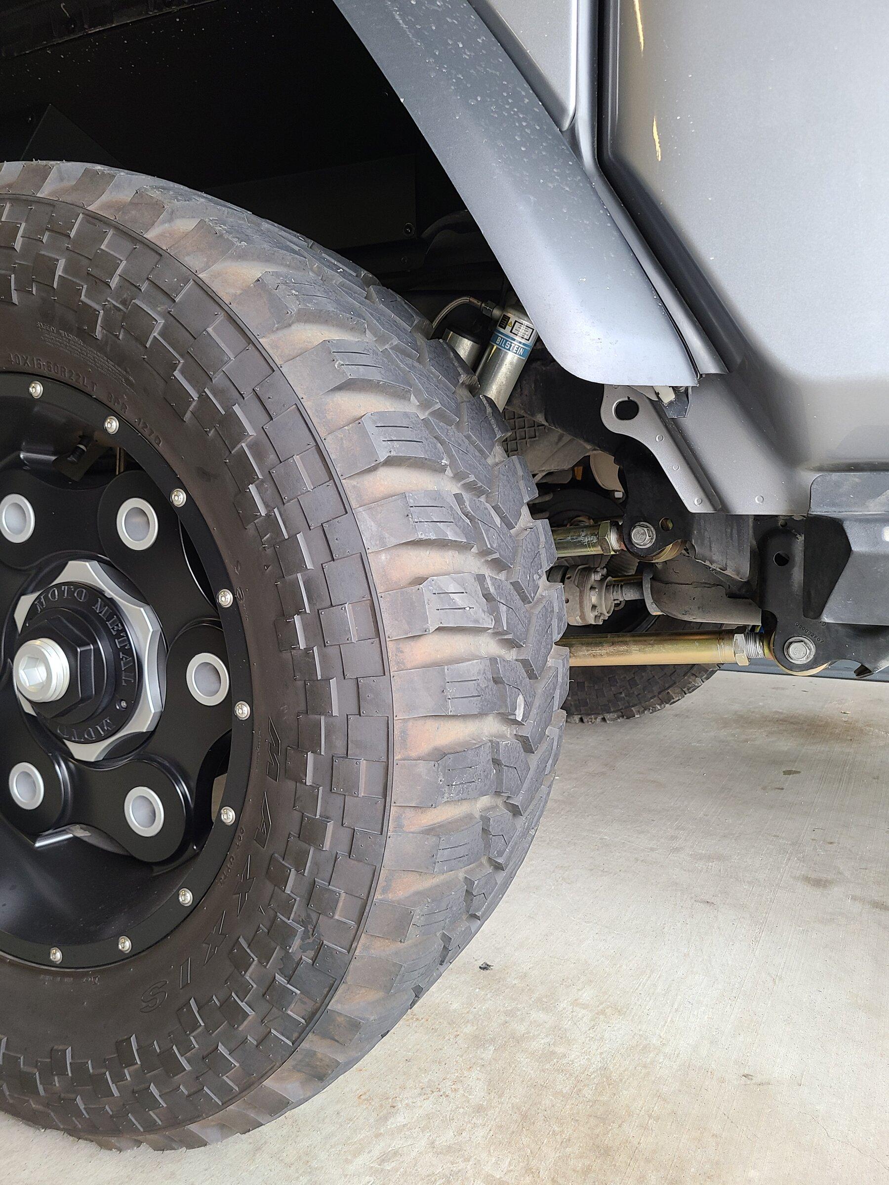

I am currently running Evo 4.5" springs with MC control arms. I had to put the lower fronts out pretty much to max and add geo brackets to get my castor angle right and stop DW. They do work tho and ride great! That is a huge jump from the MC 3.5" to the Evo 6.5". The MC lift measures 3.5" of lift in the front and ~ 2" in the rear. My 4.5" Evo springs got 4.5" in the rear and 6" in the front. I am at the very edge of range with my stock drive shaft. You would need to replace the drive shaft with a 6.5".
