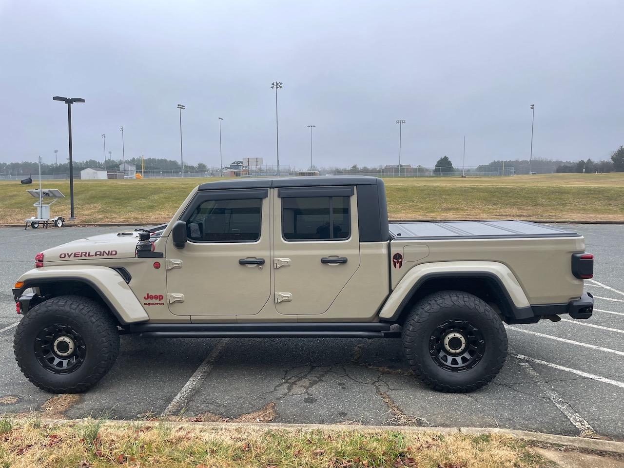

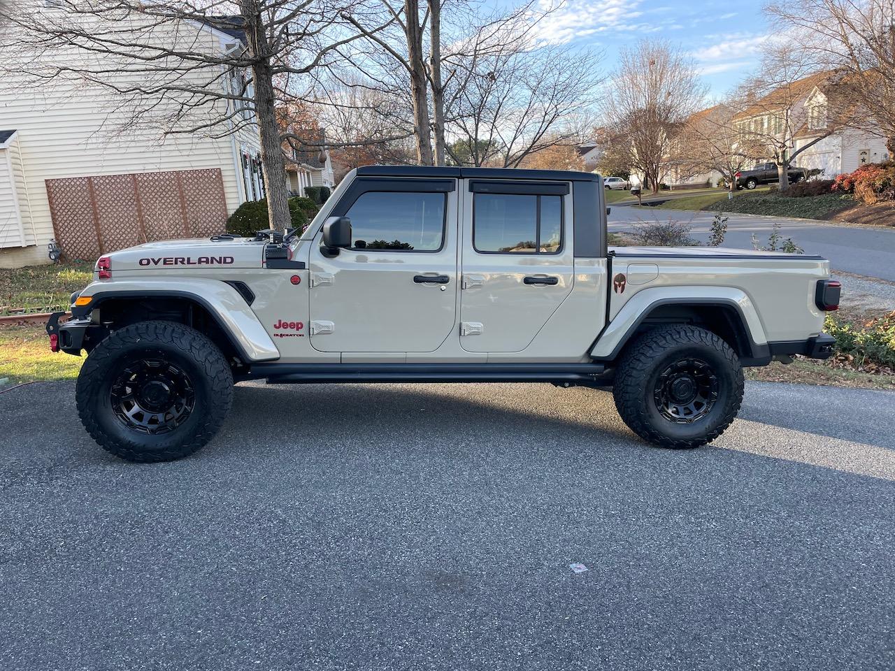

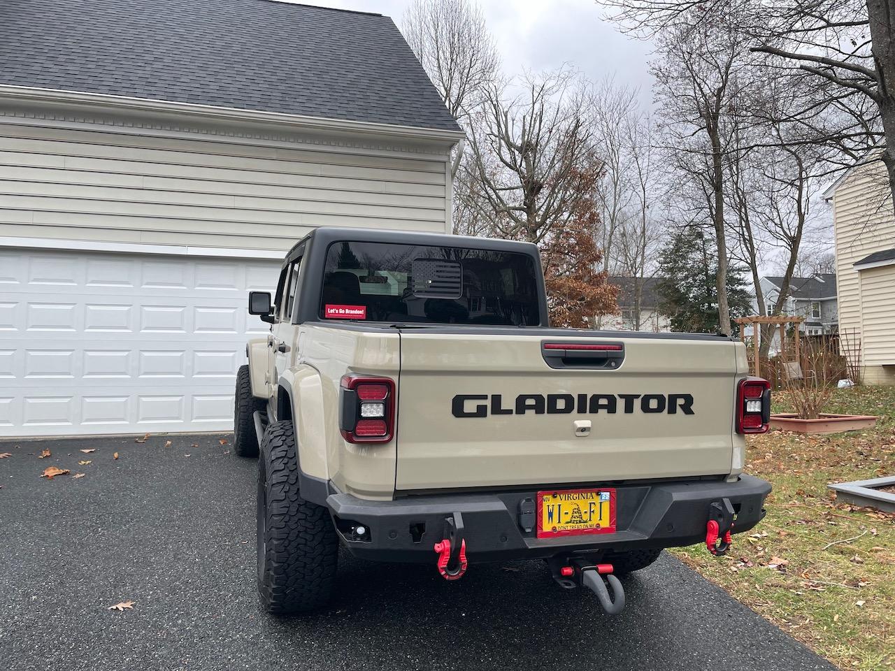

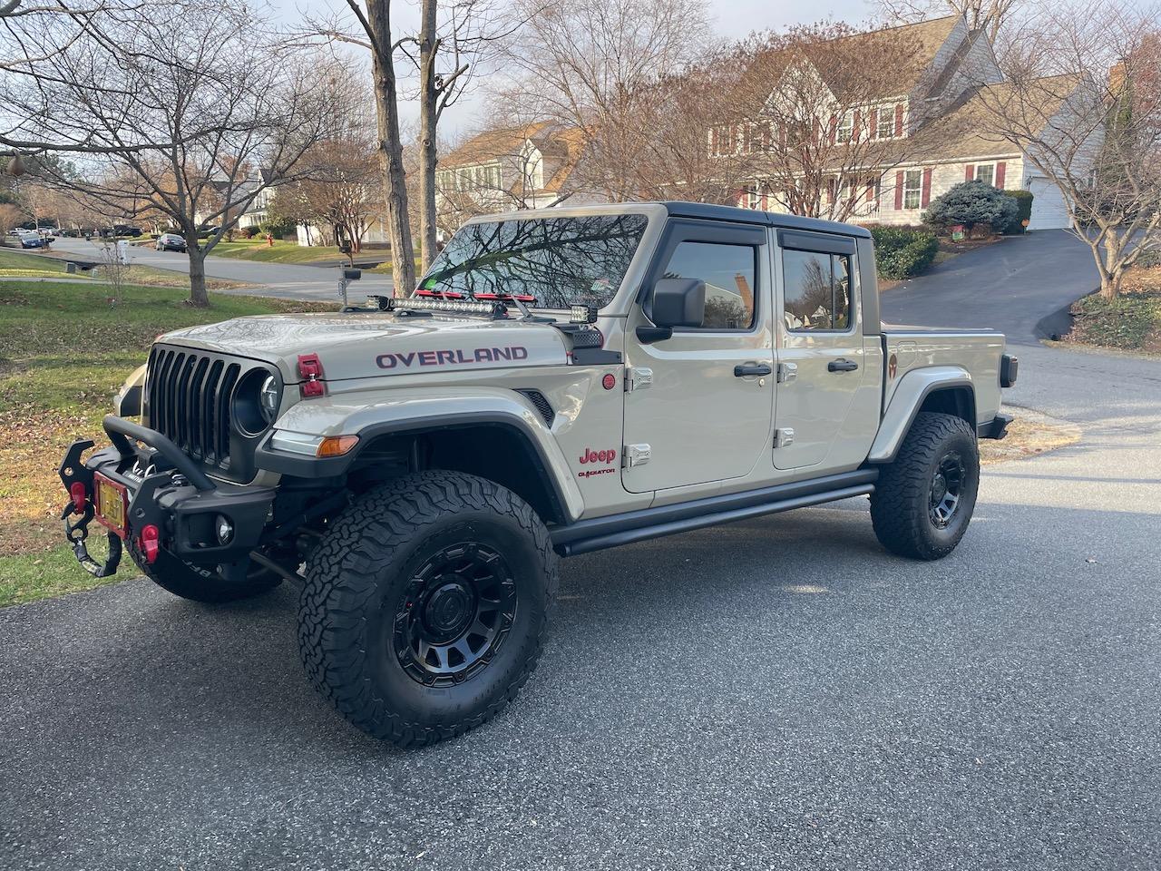

Here you go, the last pic is after I painted the center caps Gobi.

Thanks for the pics ! Really appreciated !! On the pics the level kit is install ??
