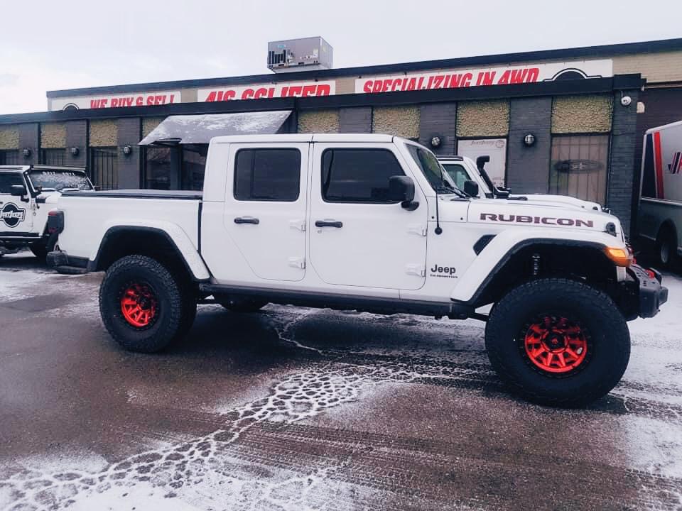

I have a mopar lift kit and daystar 3/4 with factory steel bumper it was fairly level but when i added aftermarket bumper and winch it sagged....will be adding 1.5 spacer this spring

What wheels and tires are you running?
