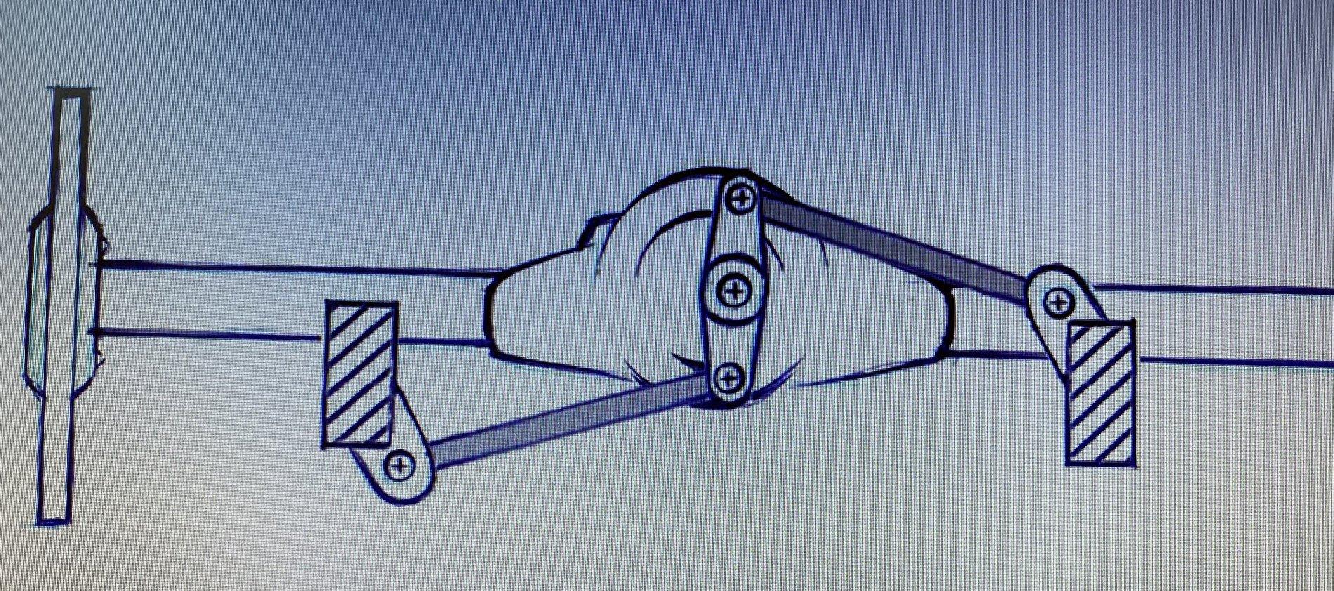

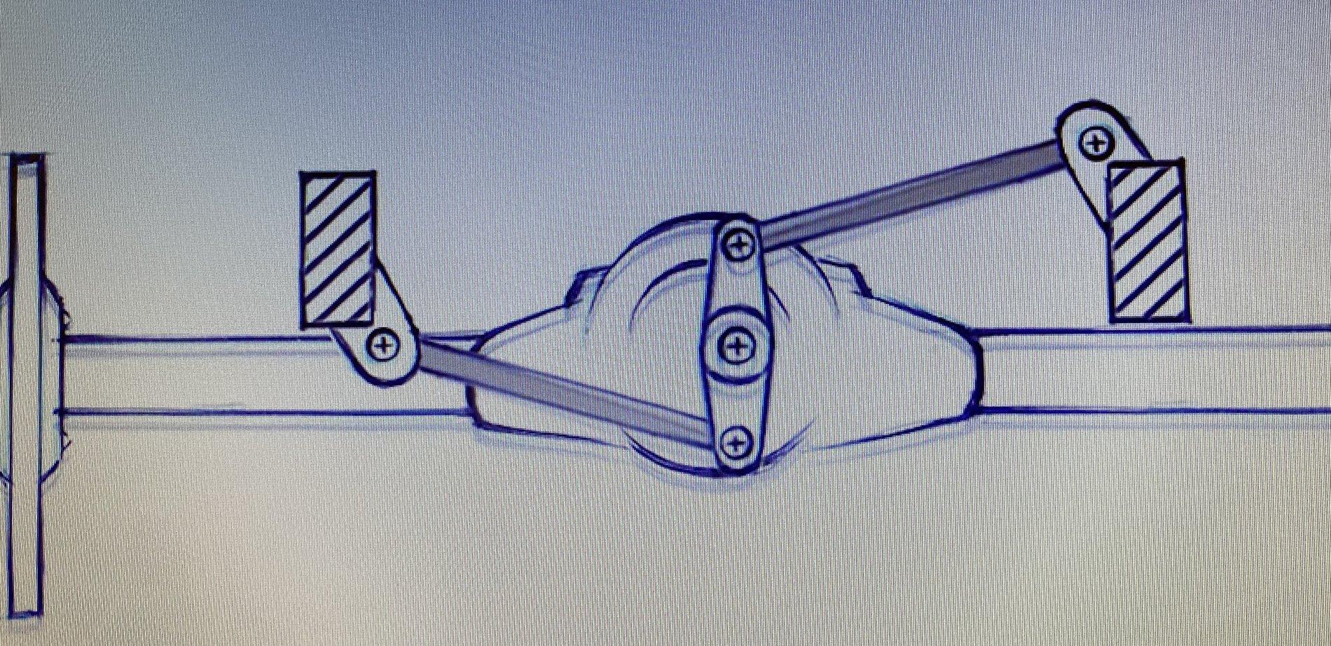

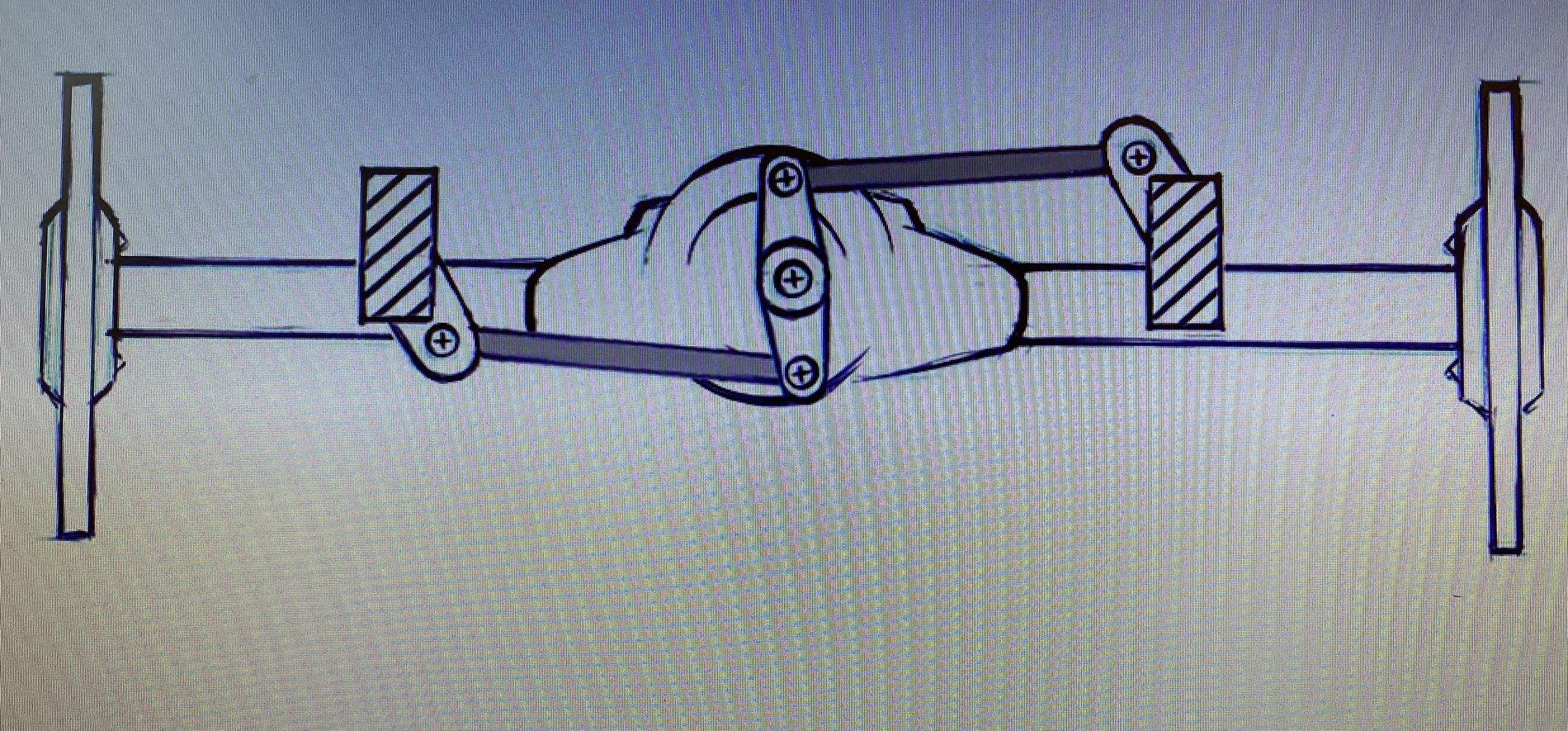

I'm just seeing lots of faults in the design of a lot of the kits out there.
I have built and set up many race cars and suspension dynamics are very important to me.
The only engineer I have talked to in the past that has shared my ideas on suspension dynamics were the guys from AEV.
It seems like a lot of the 'off the shelf' kits are designed for maximum brag numbers like articulation and travel that show up on a sheet of paper, but if the truck handles like crap, then whats the point?
I will probably get the arms from one place, get the springs from someone else and get the shocks from yet someone else.
I don't like what happens to all the angles when the truck gets raised. I would like to keep the original angles as much as possible while adding articulation and keep the joints from binding.
I mentioned in a another thread as well, that happens to the track rod (panhard is the correct name) - is crazy.
The axles are moving left and right as the suspension travels!
I believe (in my naive opinion) that this could be reduced greatly by placing more emphasis on correcting roll centers, instant centers and keeping the angles much closer to the factory angles while still getting the desired lift.
A very interesting take on the containment of lateral movement of the axle is the Watts linkage setup.
I'm not sure it could work for our setup but it sure would be cool!

Normal height
Jeep Gladiator 2.5 rough country leveling kit VS 2 inch mopar lift kit E8375AAC-1ABF-431F-AEC5-8E3DDC07EFBE
Compression
Jeep Gladiator 2.5 rough country leveling kit VS 2 inch mopar lift kit EBF4CD92-30F9-42BD-B933-6993F24A180D
And droop
Jeep Gladiator 2.5 rough country leveling kit VS 2 inch mopar lift kit 2943428E-E5C6-4FAB-9C07-CD4EEE22EB1B

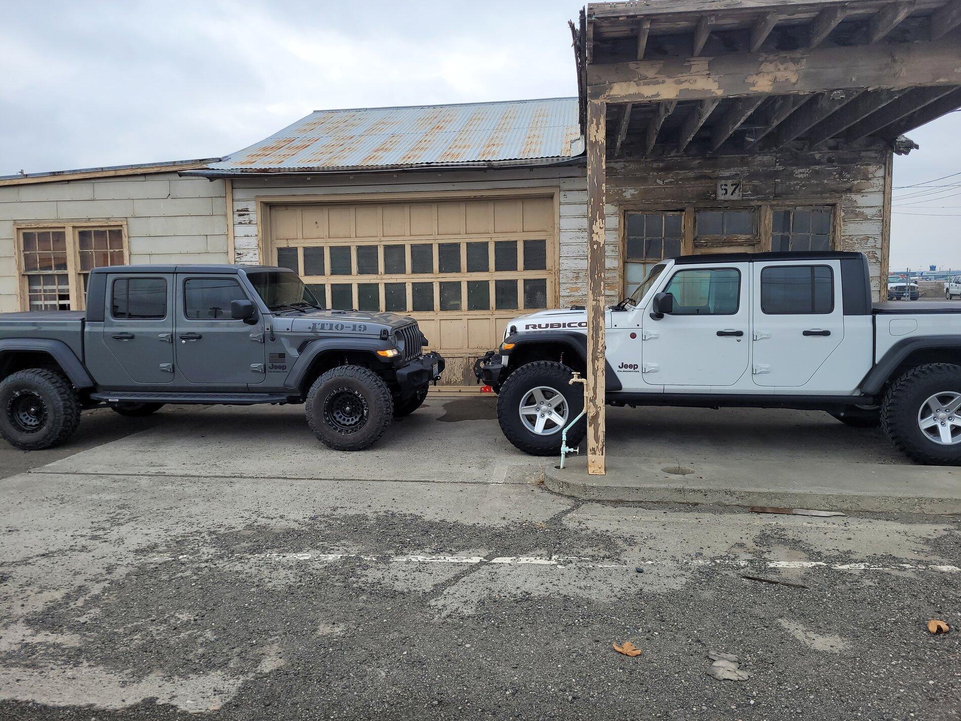

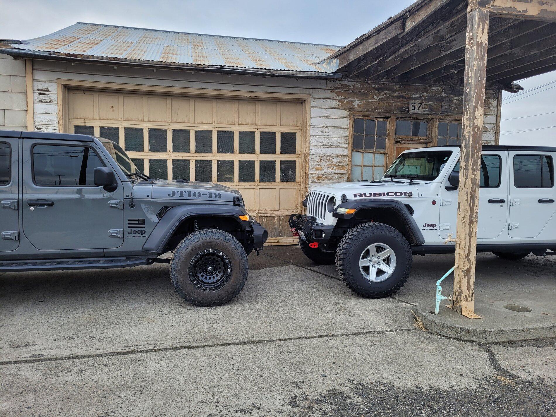

Bright White Rubicon with RC 2.5" front leveling kit ($129), .75" Daystar rear spacers ($39), and Mopar 2" lift lower front control arms ($60) on 37's vs Sting Gray Sport with Mopar 2" ($1250-$1700) on 35's. I am still deciding on going to a spring lift or not. So far, the spacer lift rides great on and off road. I sold the built TJ, and will only be doing mild trails these days. $228 vs $1250. ?
Jeep Gladiator 2.5 rough country leveling kit VS 2 inch mopar lift kit 2jt gas
Jeep Gladiator 2.5 rough country leveling kit VS 2 inch mopar lift kit jts jtr
