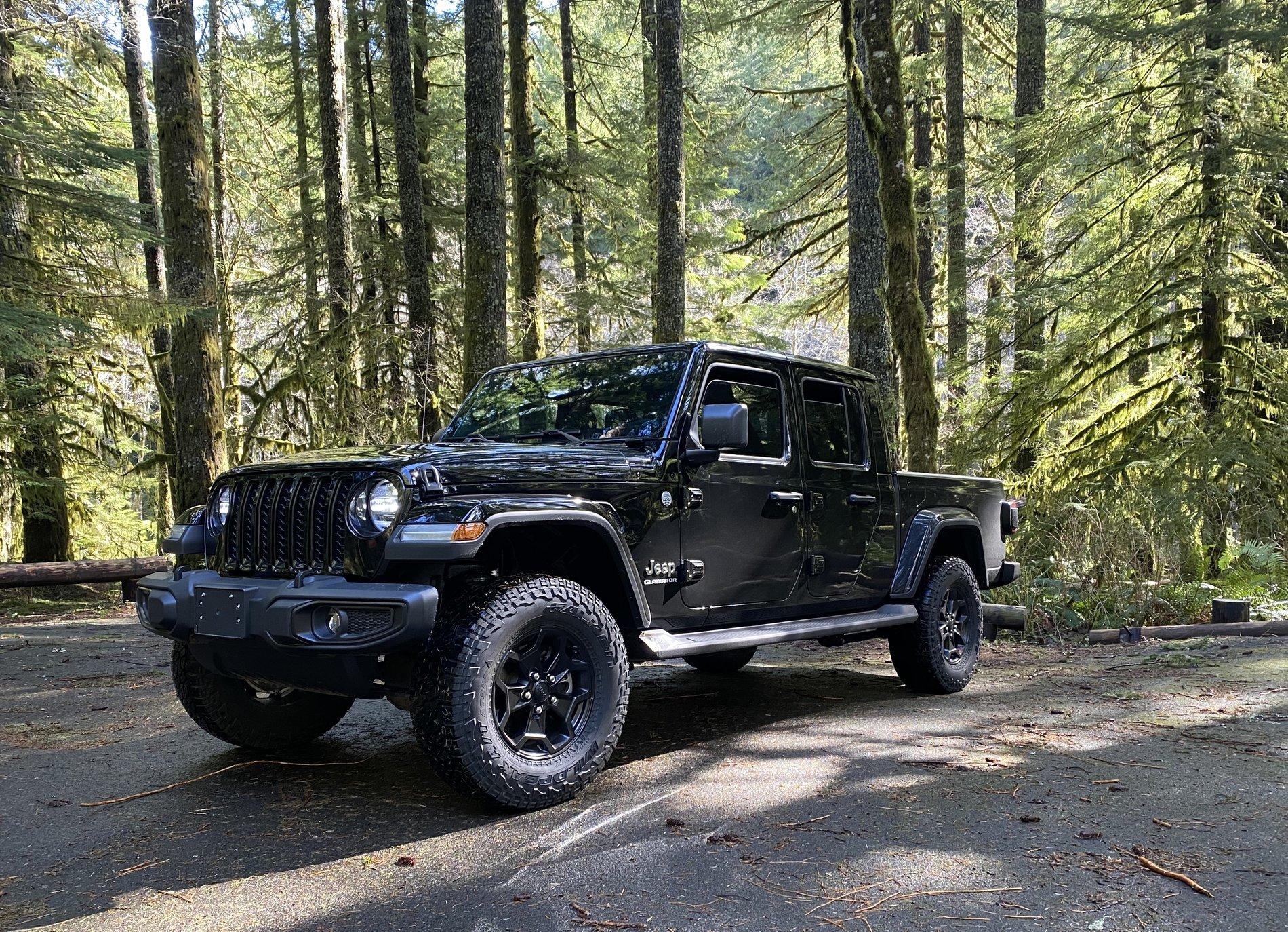

I have the Mopar 2" lift and mine doesn't pull to the left at all. I also have the same wheel / tire combo that was on it before the lift. The dealer had 18x9 American Racing with 295/70-18 Mastercraft MXT and I definitely gained. It handles better than stock, handles good enough for me offroad, and when I go on road trips.
Do you have a pic of your ride? Im about to do the same on same size tire
