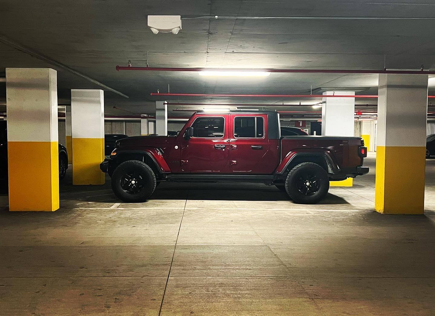

I would heavily consider installing something bigger than 1” in the rear. Here’s mine with the RC 2.5” spring kit and a 3/4” daystar puck in the back. Icon makes a 1-3/8” rear spacer which is what I have in the mail.
Jeep Gladiator JT Rough County 2.5” leveling kit D18FE01D-7A9F-4FEE-A749-76AC008F4DB3
Thank you. The picture says a lot. Please keep me posted on the 1-3/8” when you get it installed.
