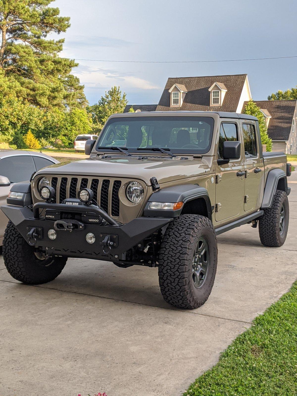

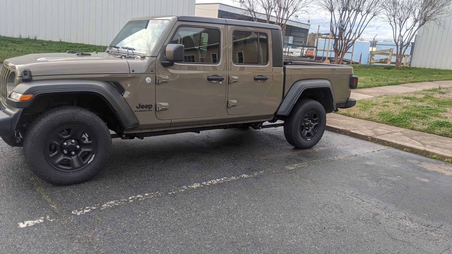

I did the Readylift 2.5" SST lift kit on mine and I love it. I'll say this, stay away from body lifts, they don't look good. I had a 1.25" one on my JKU and the gaps it leaves in the Front and rear around the bumpers looks terrible. I delt with it because I didn't want to go through the trouble of removing it but I told myself I'll never do it again. Just my 2 cents on it. Here's mine. Before and after.
Before
Jeep Gladiator Leveling kits and body lift kits MVIMG_20200213_170842
After
Jeep Gladiator Leveling kits and body lift kits 00000IMG_00000_BURST20200619193653437_COVER
Before
After
These 33 or 35?
