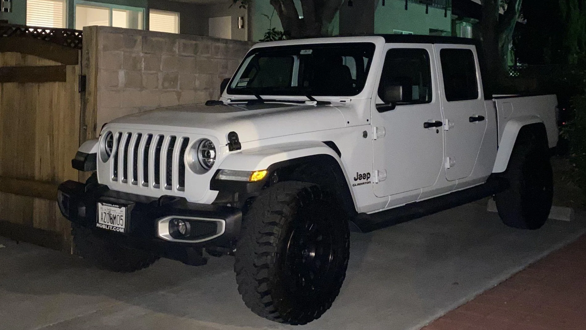

I did the Rough Country 2.5” leveling kit but for me it didn’t look right. I never really liked it (just my opinion). I’ve now installed a 1-1/2” leveling kit in the back and it looks almost perfectly aligned. So I would say the 1-1/2” front will get you as level as she will sit. I can’t believe this but I don’t have a side on view photo... this is the best I have that shows the alignment.

what is your tire offset there? What size tire?

The rims come with a -18 offset and those were 35's (35x12.50R17). I now run 37x13.50R17 on the same rims but with the 3" RockKrawler springs in the back.

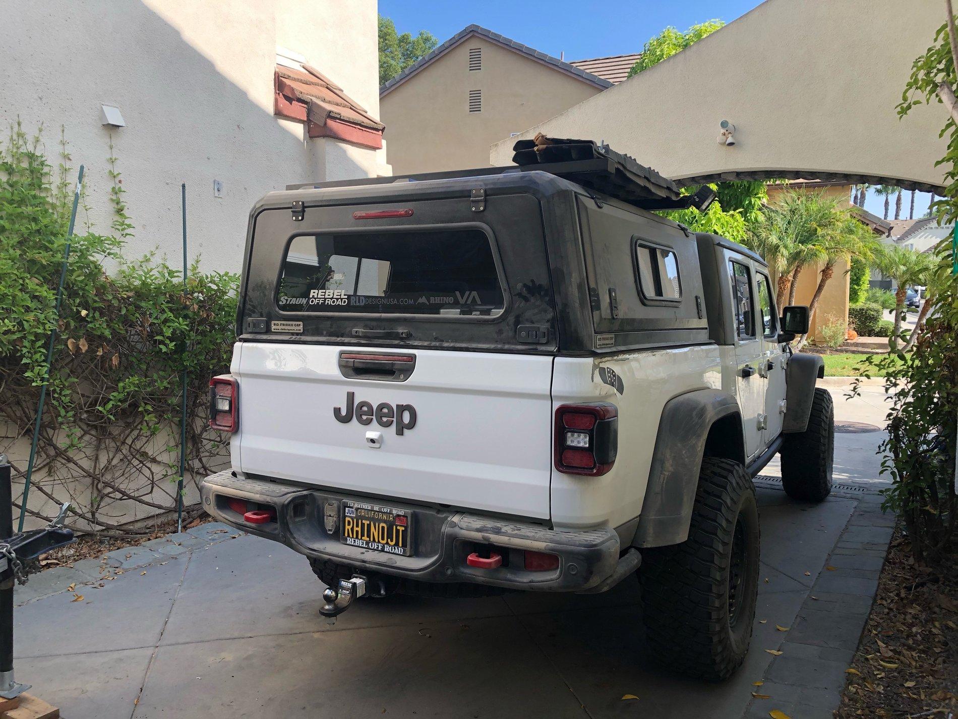

Hi Willemlock. thanks for your comment! Could you please provide the info of the back 1-1/2” leveling kit you bought? I'm planning to do the same.

Yep I got mine from Rusty’s Offroad. Back then they were the only ones who made it. They do still make it and very cost effective.

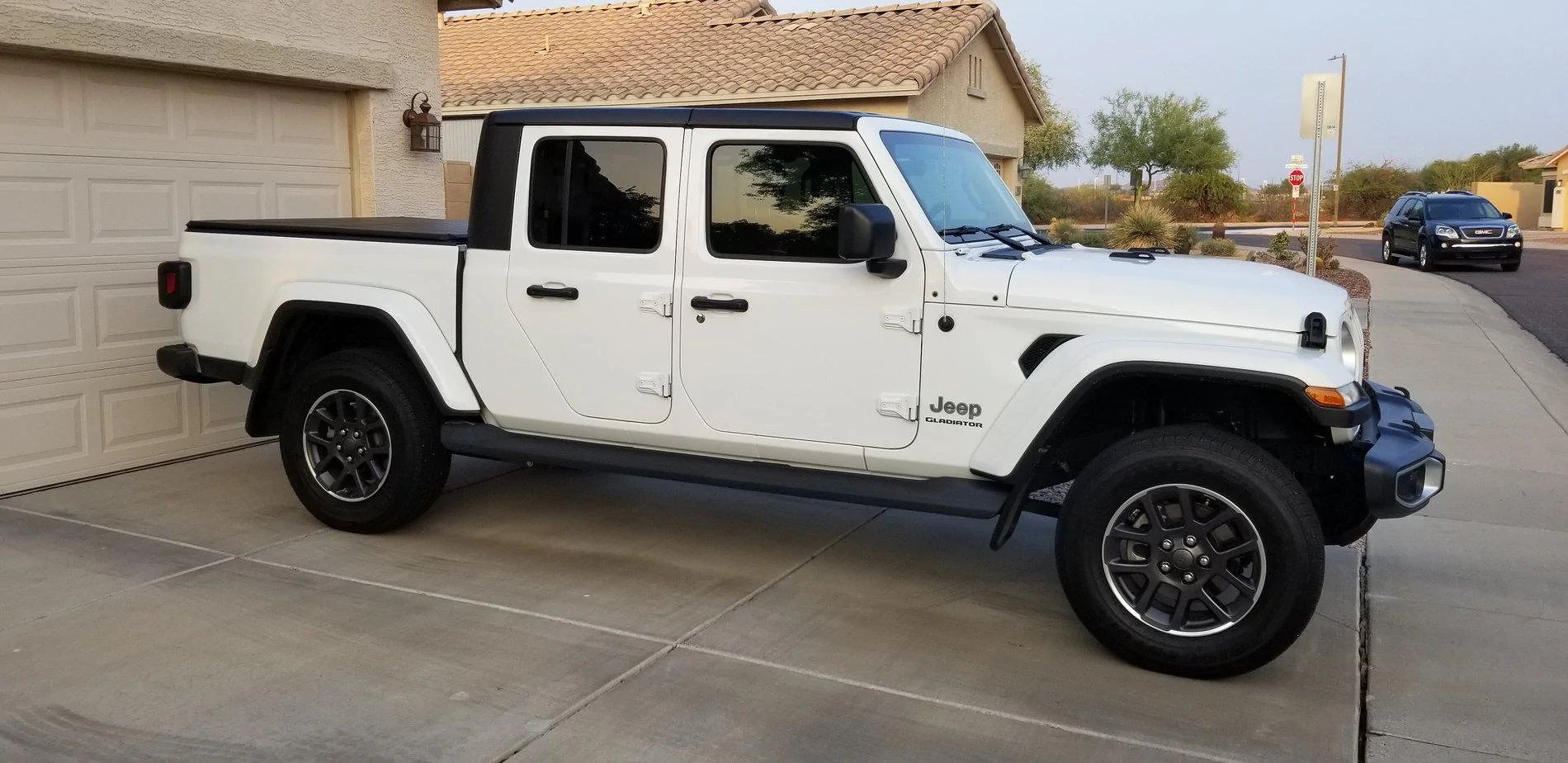

I put in the Rubicon Express JT7134E kit and it looks pretty darn level to me - I say this because depending where I park, sometimes the front looks slightly higher, sometimes the back, so it evens out (at least mentally). In all seriousness, I was recently in a Target parking lot that looked pretty level, and my JT looked as level as could be from what I could see.
First pic is with the kit installed and OEM tires; second is with Nitto Ridge Grapplers (285/75/18) installed.
