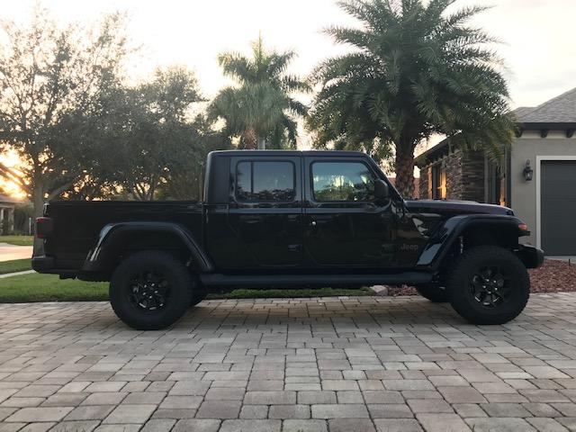

This is my Rubicon. I've installed the Daystar 1.5" leveling kit with an added on 3/4" rear spacer. Tires are 33s (285/70/17) Falken Wildpeak AT3s. Install time in my garage with floor Jack and hand tools was 3 hours.
Question for you all: should I go with 35s or does it look good as it sits currently?

I know you are not on level ground but even when i tilt the screen your front looks higher than the rear. Could be just me though. As far as looks, doesn't look bad but 35s will definitely fill in those wheel wells nicely.

I think 35’s look better
Go by the rocker area - looks like a very slight rake front being just a tiny bit lower than the rear to me..........
Assuming he is straight in that beautiful driveway you could compare the line along the grass with the rocker panel area and it looks like a very slight rake, front lower - at least to me (I can only imagine how nice the rest of the place looks based on this pic - puts mine to shame for sure)
