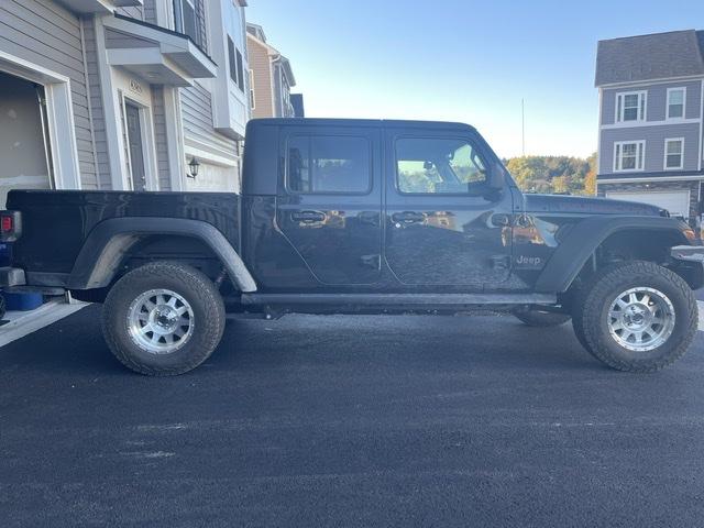

I’ve got the MC 2.5inch leveling kit. It’s great, BUT, unless you’re running a heavy front bumper/winch you’re going to be riding nose high. Mine is probably .75 to an inch nose high and will be getting either 1.5 inch rear springs or a spacer when I get back in 6 weeks. The picture I added below is on a slanted driveway but yeah you can still see it. Front fender heigh is around 43 rear fender is just about 42 on the stock falken AT tires
