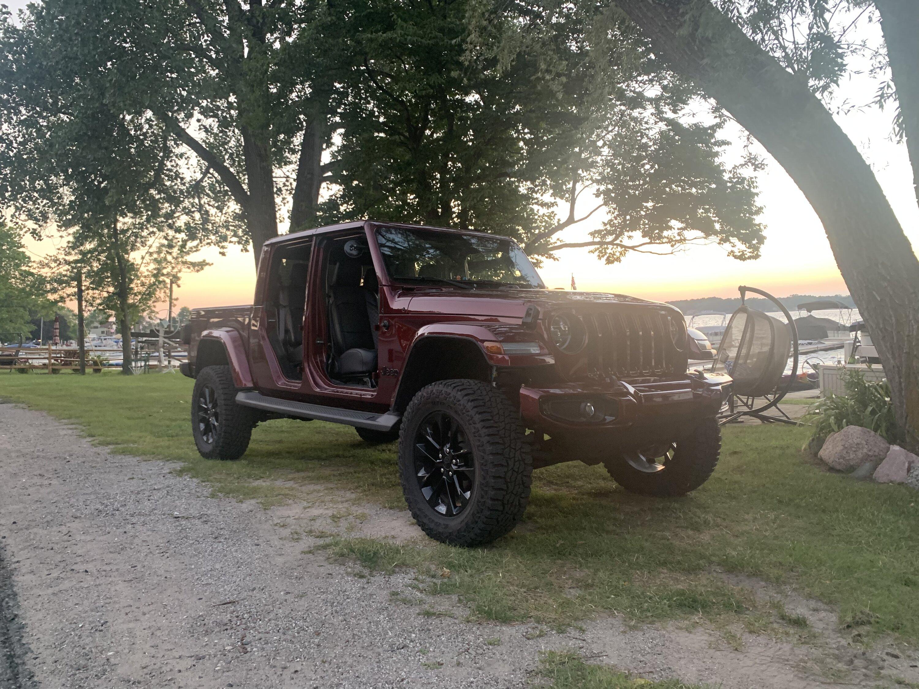

Hello! Sorry to revive an old thread!
I am contemplating the 2.5" lift kit for my Max Tow. I saw that 2.5" doesn't need LCA drop brackets or even a new driveshaft, however, 4" lift would probably require them. Since the Clayton 2.5" is closer to 4" on a Sport, would you say I will need to get a new driveshaft? And break lines and all the stuff associated with a regular 4" lift
Do you have a steel bumper and winch?
