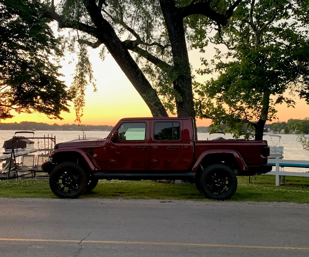

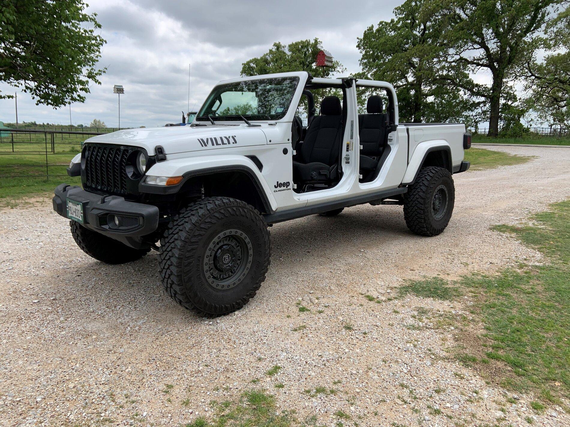

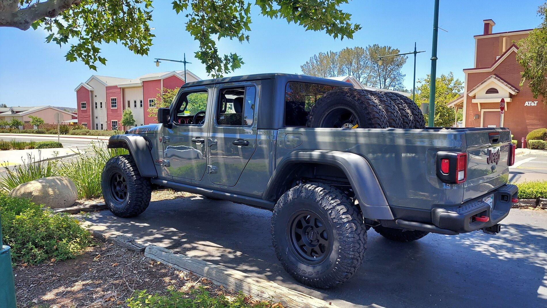

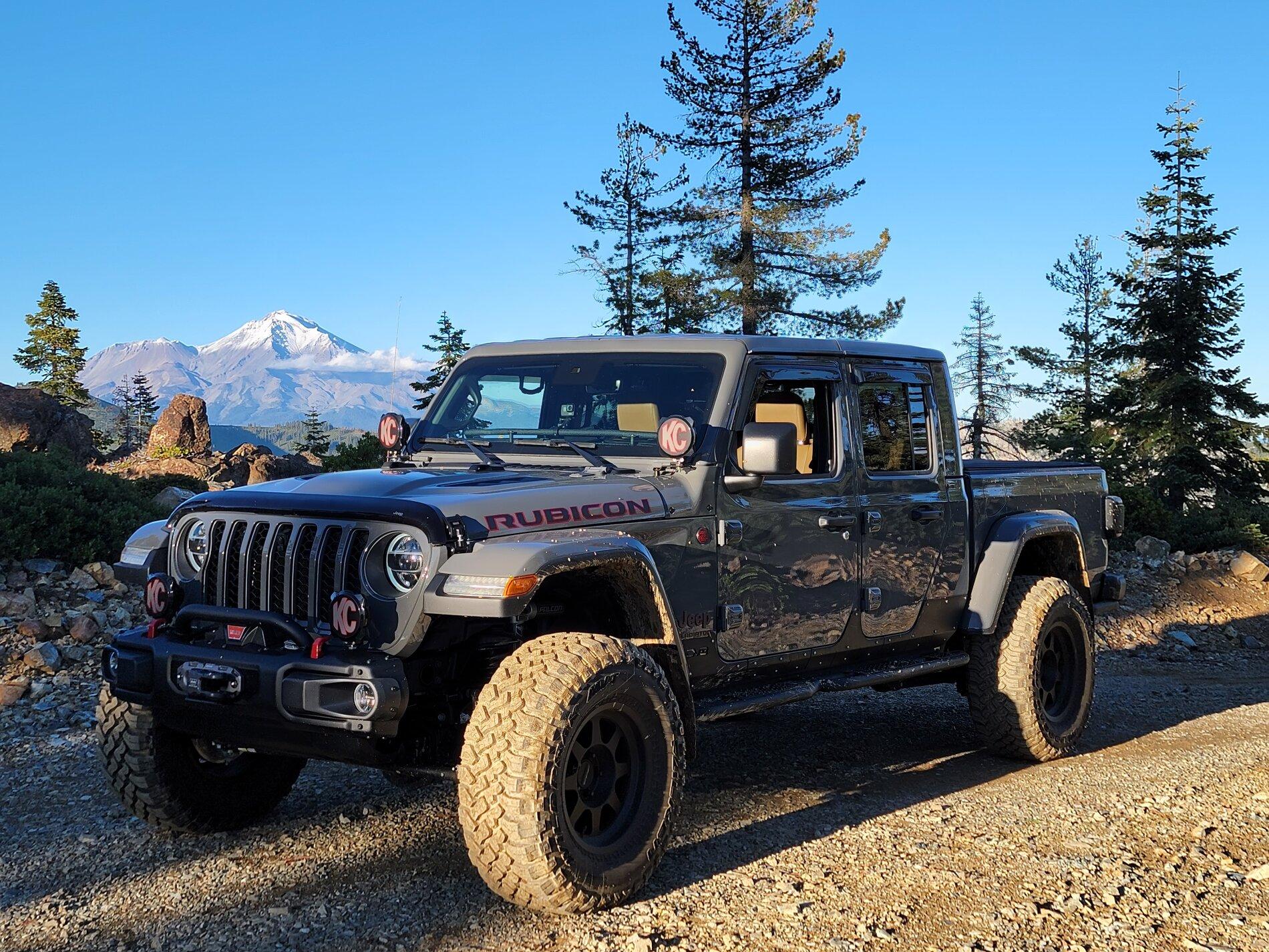

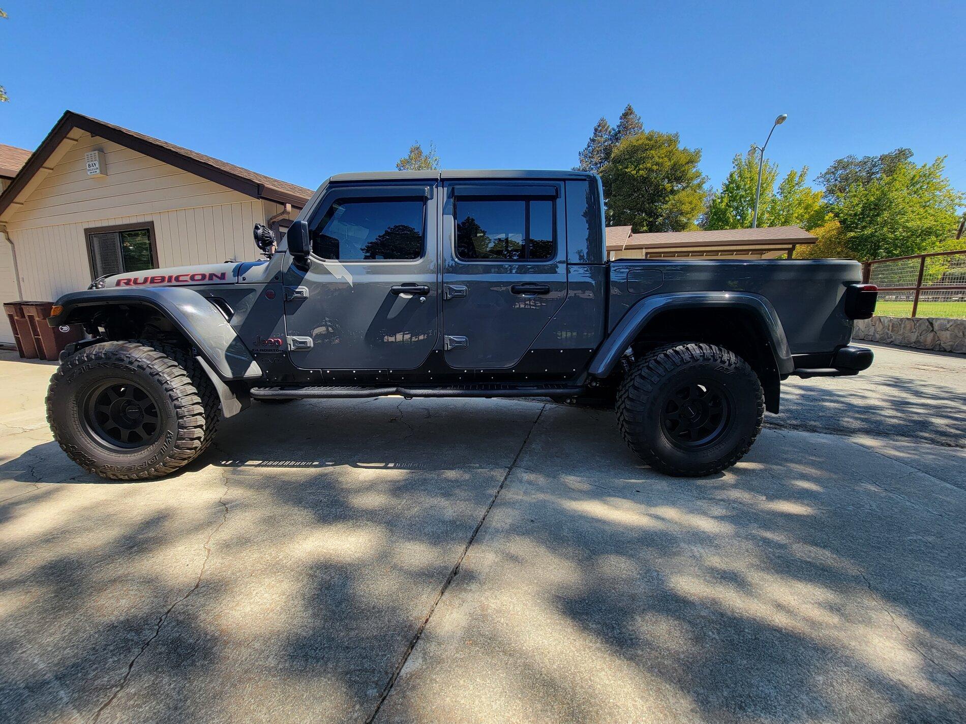

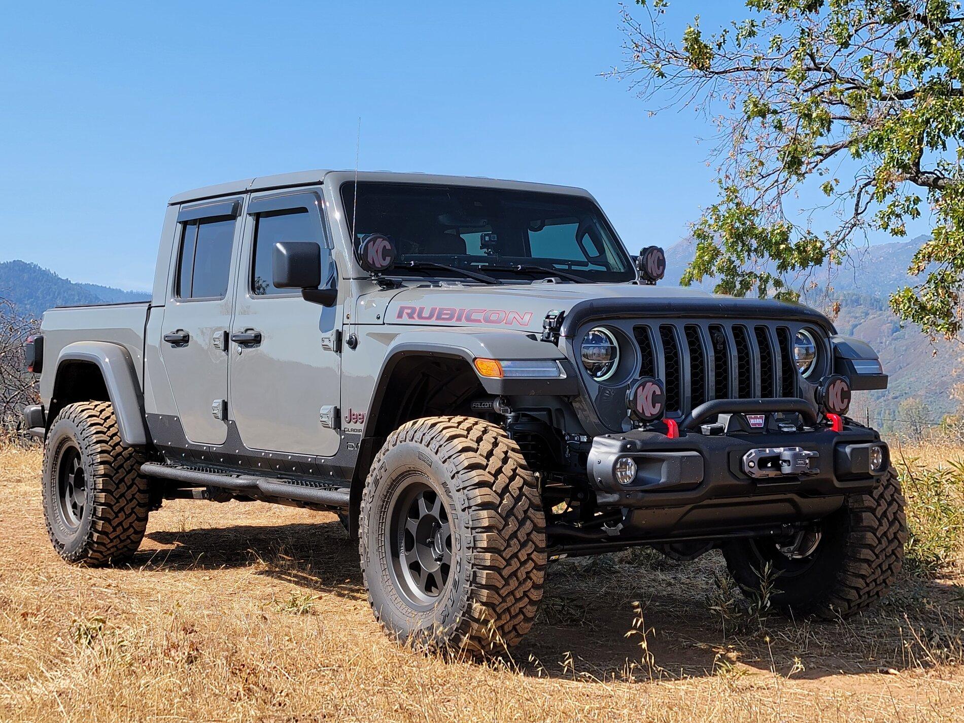

Looking at these pictures, I don't think I will do a spacer in the front, at least for now. If/when I decide to, what is the preferred spacer, or are they all relatively equal?
Did the same. No spacer in the front. I think it is fine.

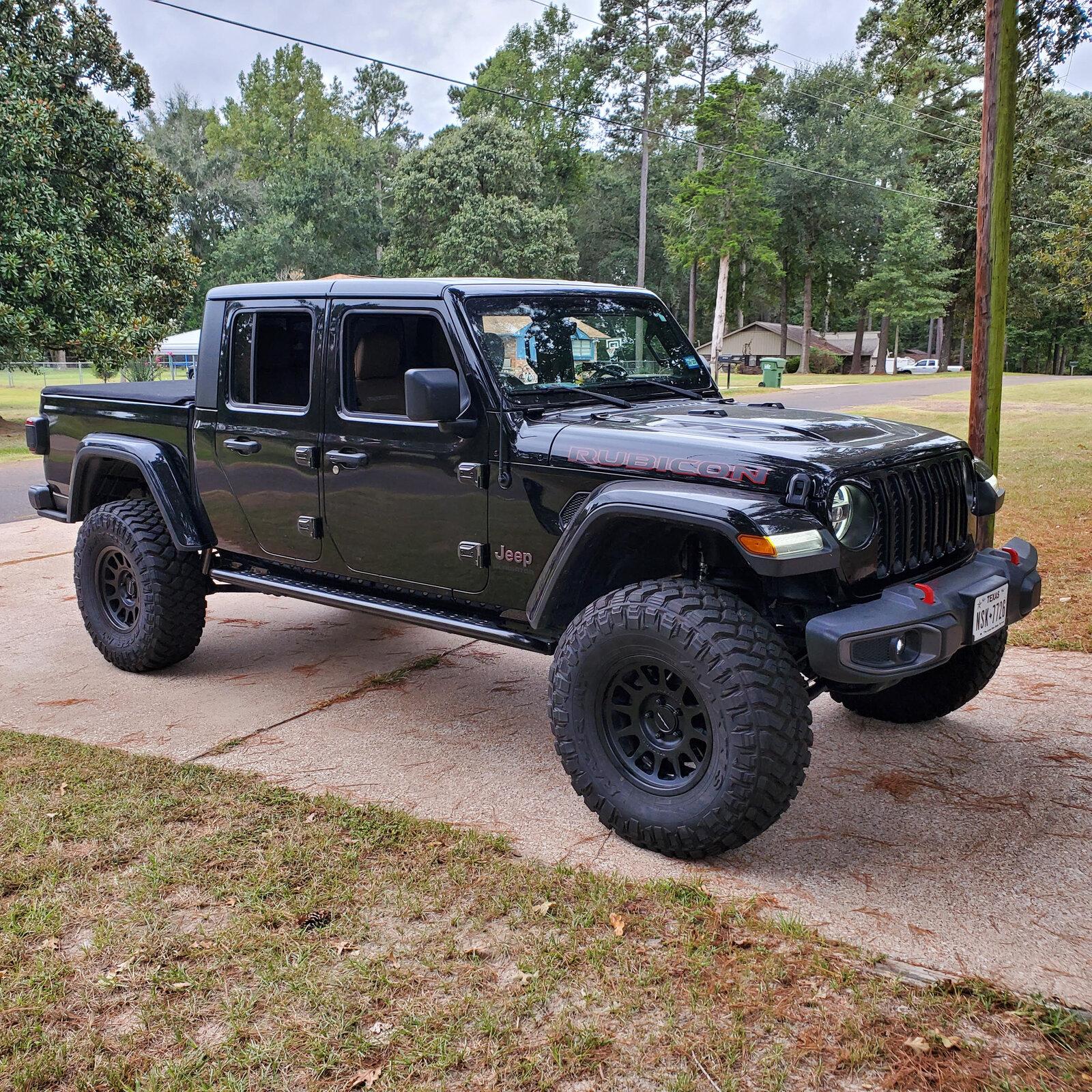

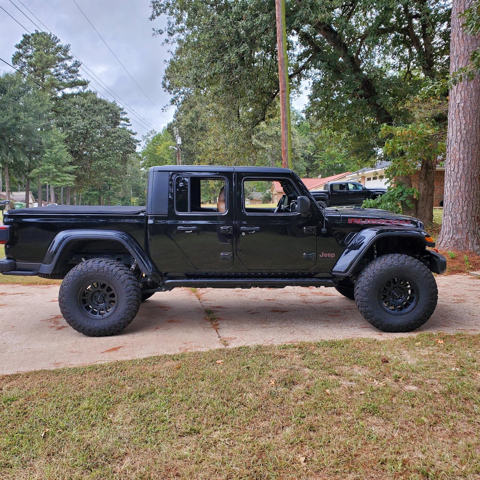

It seems like the Rubicon model sits level with this kit but the other trims have a lot of rake? What spacer has anyone tried?
I wouldn't say it's a lot of rake with other trims.

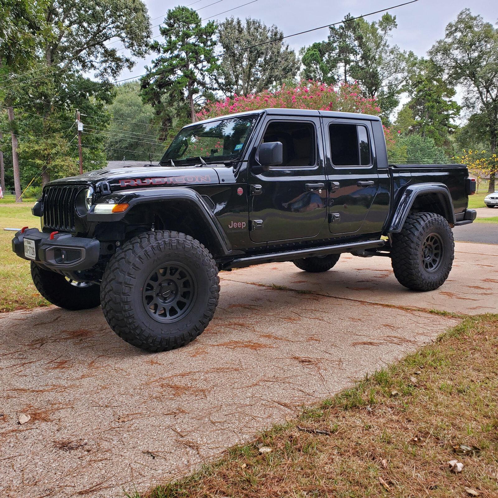

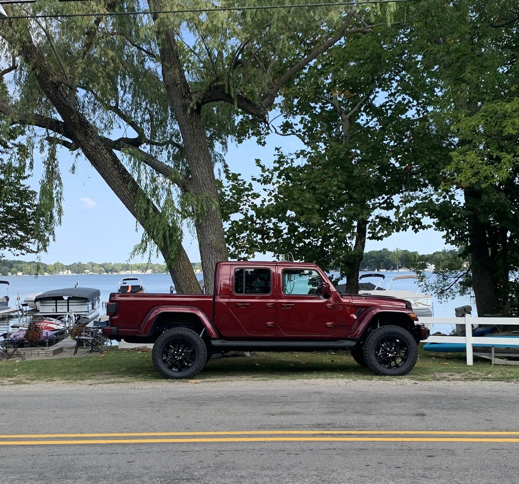

Here's mine:
Jeep Gladiator Clayton 2.5” Rake Gladiator Fall colors
Jeep Gladiator Clayton 2.5” Rake Gladiator side profile #3
It might just be an optical illusion since the Rubi/Moj fenders sit higher than the other trims.
Accurate measurements should be done on the chassis itself for rake, rather than fenders (especially since there are tons of aftermarket fenders).
I wouldn't even bother measuring since it's just for looks.
If you're unsure how much spacer to add, jack up the front until you get the look you want. Then measure how much room you added between the coil perches.

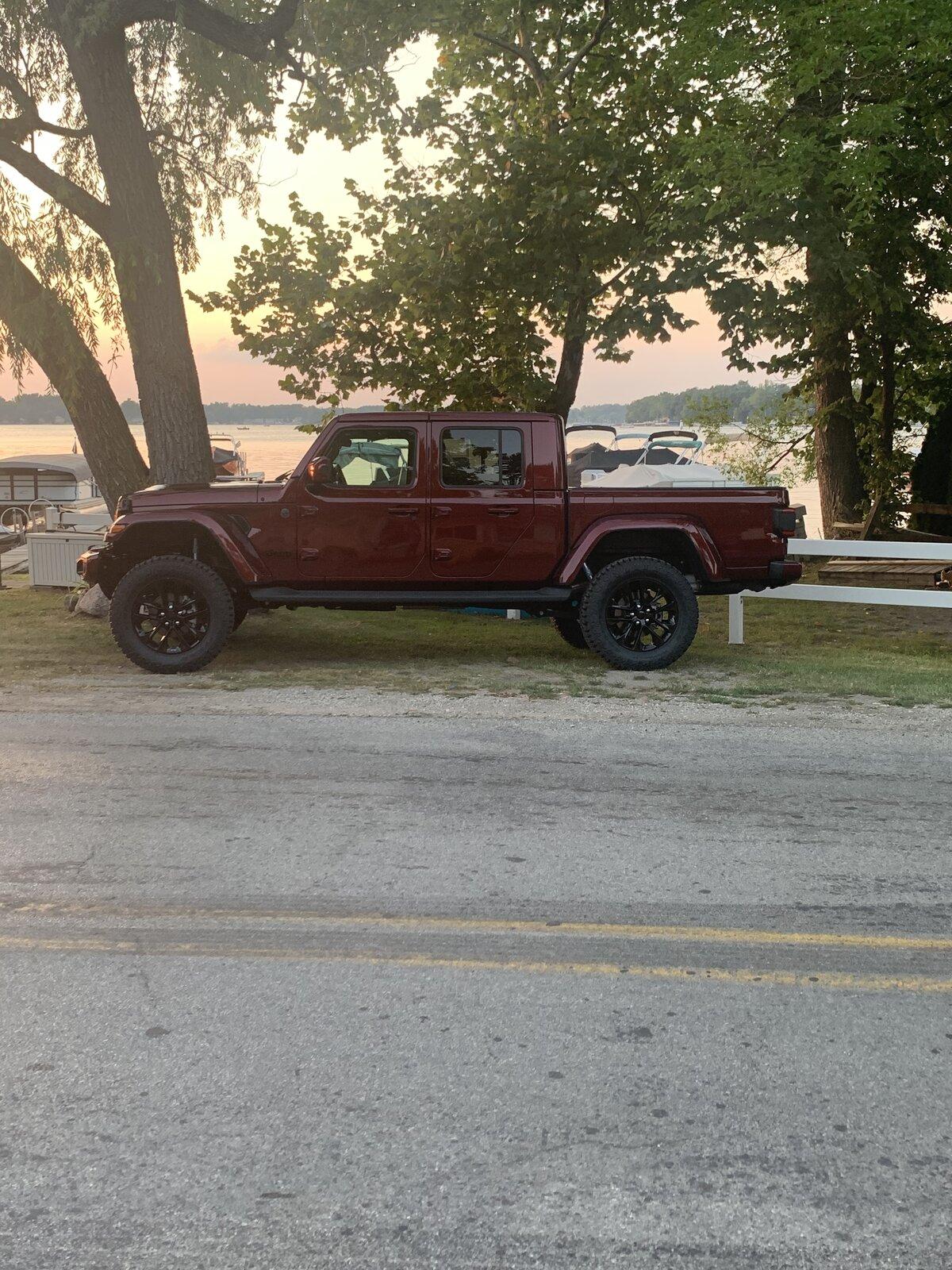

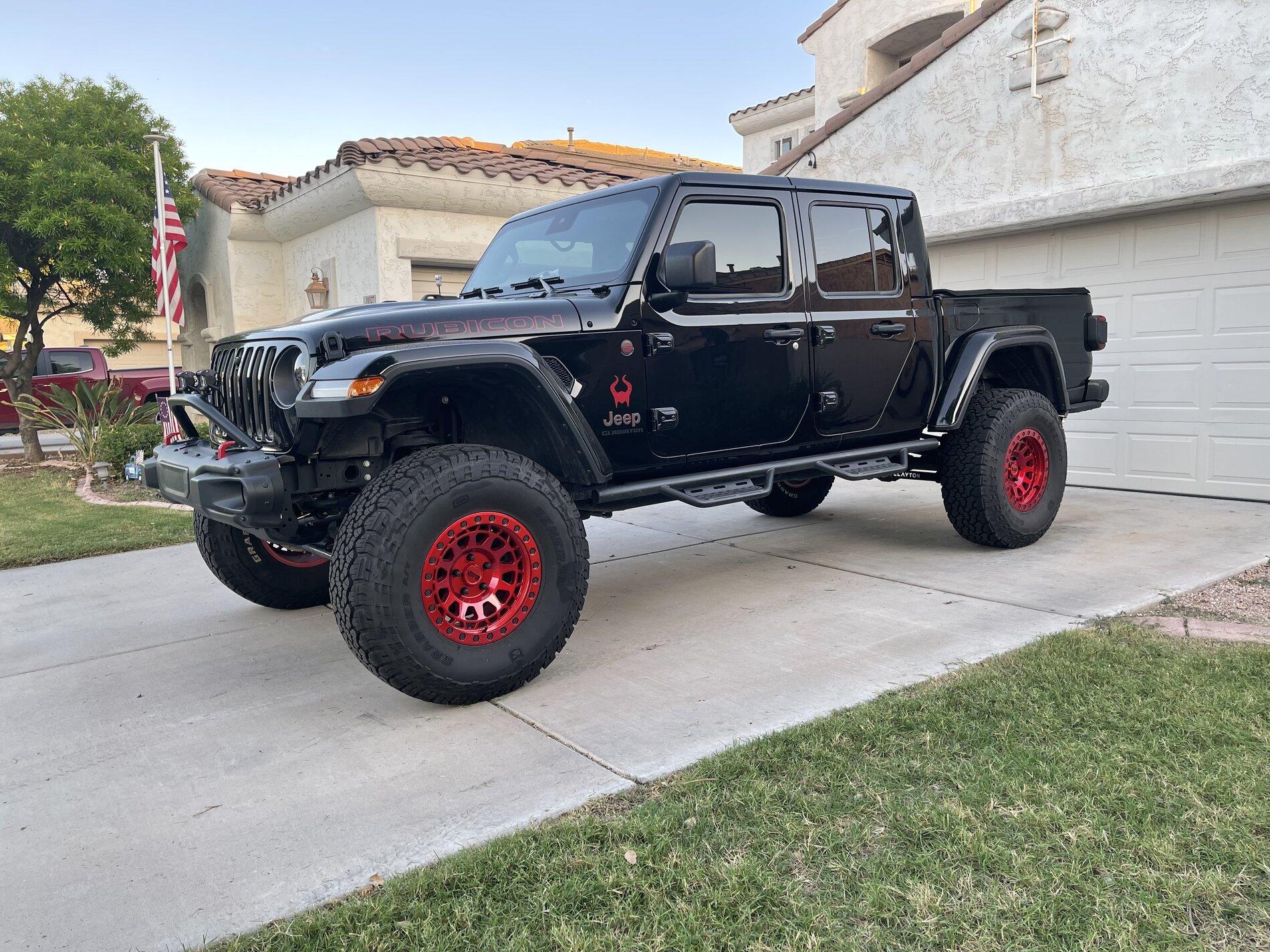

Good point. Mine looks closer to the one above in red. I just like a more level look like the wranglers have. Really don’t wanna spend 300-500 just to level it
Jeep Gladiator Clayton 2.5” Rake IMG_9237
Wheelin98TJ
Ryan
Jul 27, 2021
3,908
4,633
Devils Lake, MI
2021 Jeep Gladiator
Bean Counter
You shouldn't have to spend that much.
You just need a set of $50 coil spacers and some labor.
