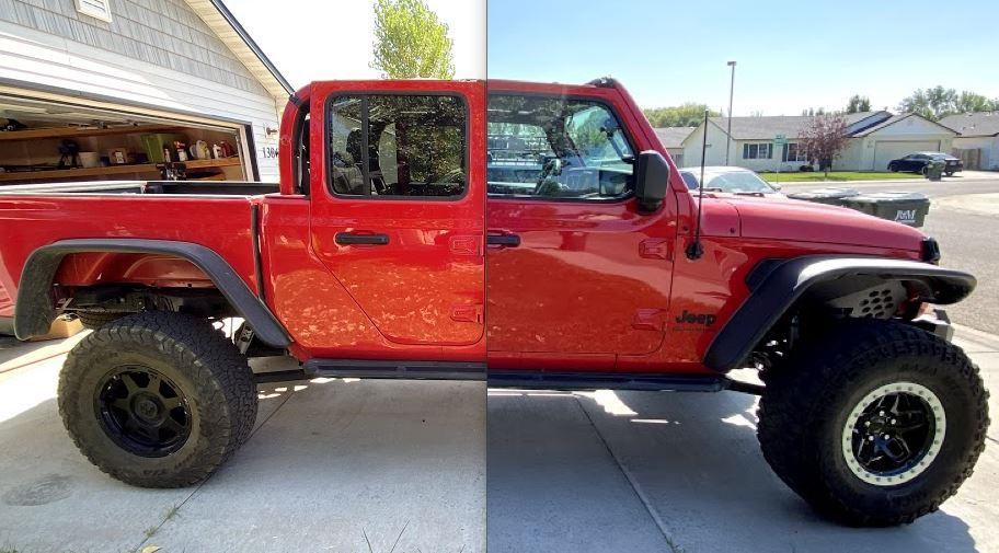

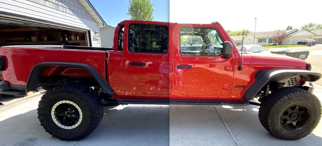

My Clayton lift 2.5” netted me almost 4“ of lift. I posted specific pics with measurements before and after in a thread here somewhere. My JT rides fantastic. Much better than a friends with a mopar lift and spacers. You do get what you pay for.

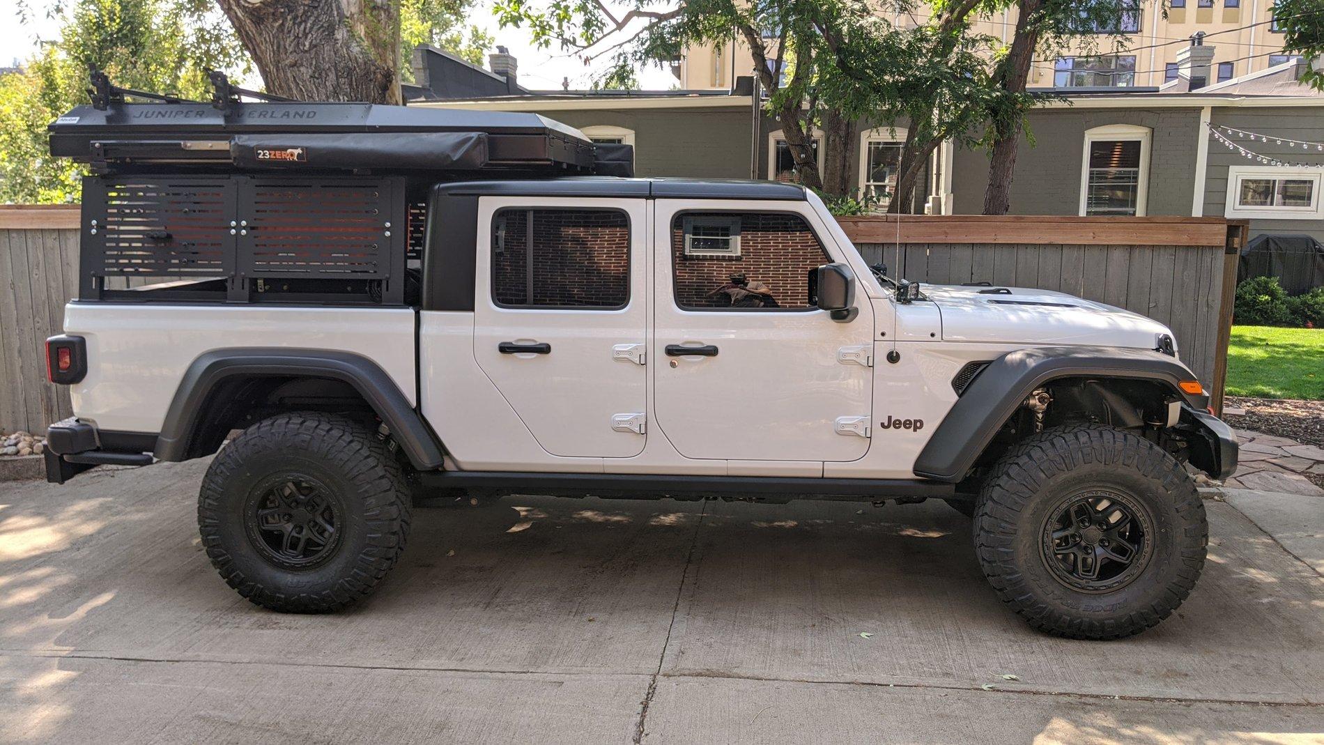

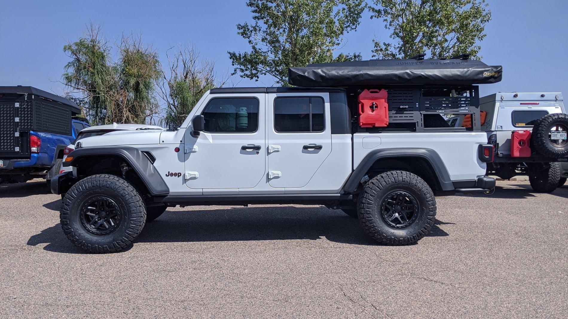

Clayton definitely over delivers on their lift numbers. 37"s will absolutely fit a Rubicon. I have Clayton 2.5" front springs and 3.5" rear springs (due to 600lb + constant load) and I netted a full 3" lift at all four corners. I'm actually hoping a bumper and winch will bring down the front a little bit.
