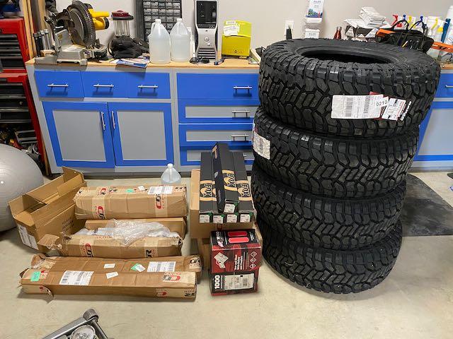

Excuse the garage... I am itching to have a lift party at my place soon.
Awww the memories... I still have most of those same box's in a big ol pile in my garage.. Mine are empty though..
You will love the lift with the Fox shocks. Its been fantastic to me thus far.
Oh yes... My wife hates that I keep boxes for EVERYTHING.
I had to make friends with my UPS guy.. And I can barely walk around my garage now because of all the old box's I need to break down & take to the dump as well as extra tires.

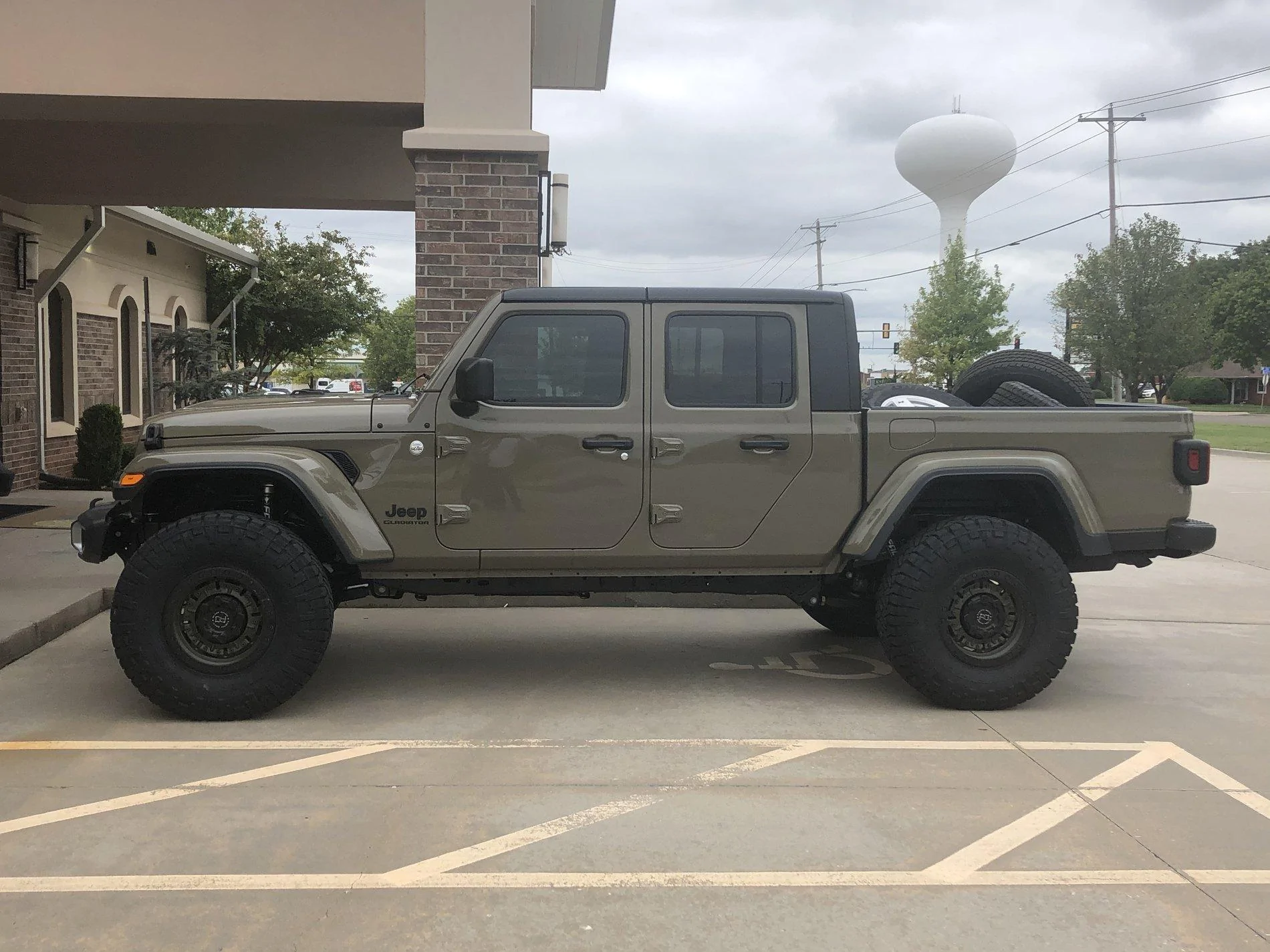

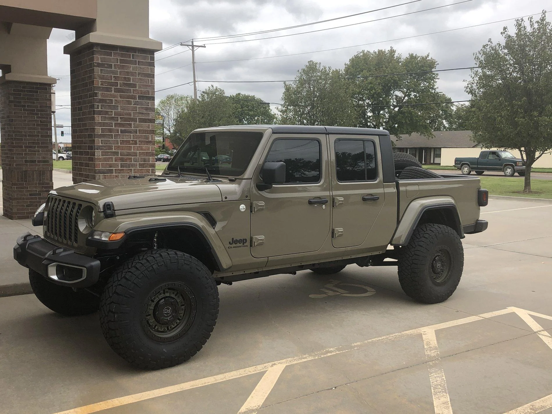

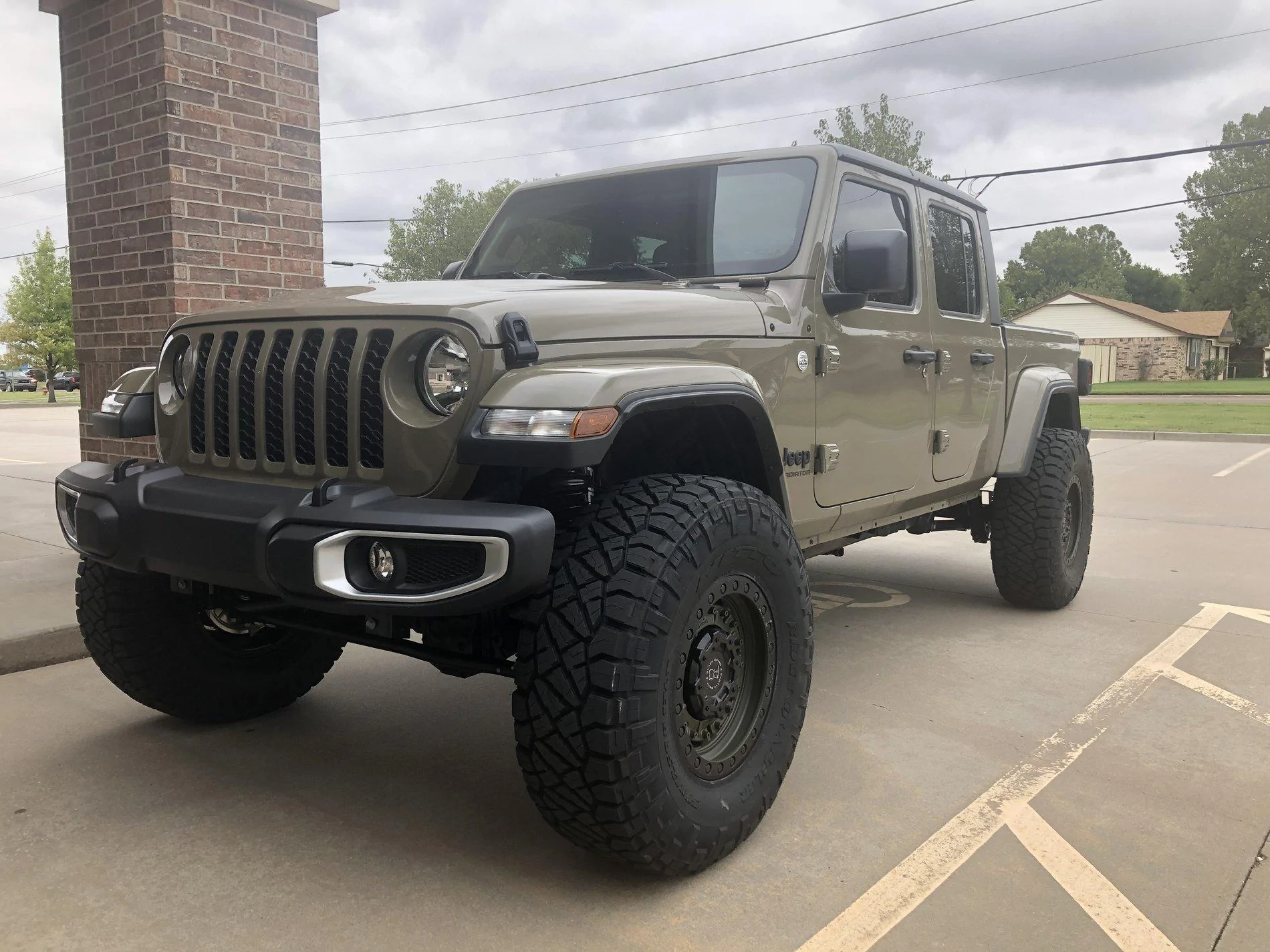

So the Clayton Offroad 2.5" Overland Plus kit is tits! The fit and finish is fantastic. My shop installed it and it was their first one. Owner commented that the kit was very well designed, included everything and was an easy install for such a detailed kit. His only criticism was the length of the rear sway bar connectors. I agree they are long but to work with the factory swaybar they have to be. He commented that he would suggest removing the swaybar altogether unless I planned on a lot of overlanding. Meh, for now I am fine with it and will leave it installed. If I ever feel the rear swaybar is a limiting factor its like a half dozen bolts and its gone. The jeep rides actually better than stock. Part of it is no doubt 10" of side wall on the 37" Ridge Grapplers but the COR springs and Falcon shocks really smooth out the ride. The highway expansion joints were noticably less jarring. Even my wife commented on how nicely it rode, and she had her mind set on it would ride like crap from the moment I told her I was having it lifted! She was pleasantly surprised.
With the 2.5" kit and my 37x12.50x17 ridge grapplers on 9.5" wheels my overall height is 78.5" at the highest point on my hard top. The height on the front fenders (center of the wheel) went from 35.625" to 42.375" an increase of 6.75". The rear fender (center of the wheel) went from 37.75" to 43. 875", an increase of 6.125". So the lift took out 5/8" of rake, just as Clayton advertised, and makes the Jeep look better without reducing payload of towing capacity. The 2.5" advertised lift on my Sport Max Tow netted 4.06" on the front and 3.43" on the rear. Its a good thing I stayed with the 2.5" kit, as I also considered the 3.5" kit, but after speaking with the guys at Clayton Offroad and hearing their assurance that their kit was a legit 2.5"+ and not going to fall short like many do when installed, I trusted their word and expertise and now I can still fit my JT thru my standard height garage door. Overall I could not be happier. My JT looks fantastic and gets a lot of attention rolling down the road. I need to get it offroad but am confident it will perform just as well there too. I have no affiliation with Clayton, paid full price for the kit and give them my strongest recommendation.

78.5 with 37s? Hmm. I could do 3" and 37s then as I have 80.5 on the garage. I could remove a 1x4 if need be.
