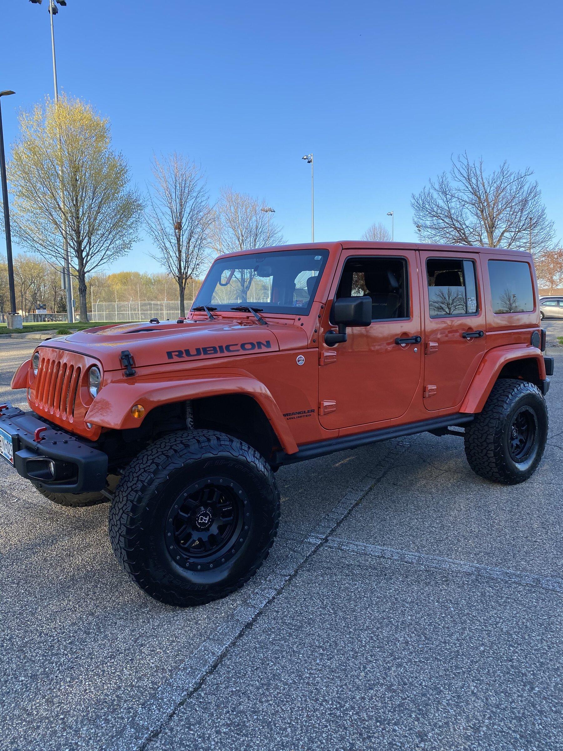

Just ordered a 2022 JTRD. Trading in the 2015 JKU. Been doing a lot of research on what lifts will be best with the extra weight of the diesel and I’ve narrowed it down to these two. Haven’t seen too many reviews out there as the AEV diesel kit seems pretty new. Im interested in hearing reviews from both kits. I understand with the Clayton you’ll need to add a spacer up front to level out. Do the Clayton springs seem too soft with the diesel? Are people happy with the diesel AEV springs? What shocks are people happy with? Appreciate all the help!
