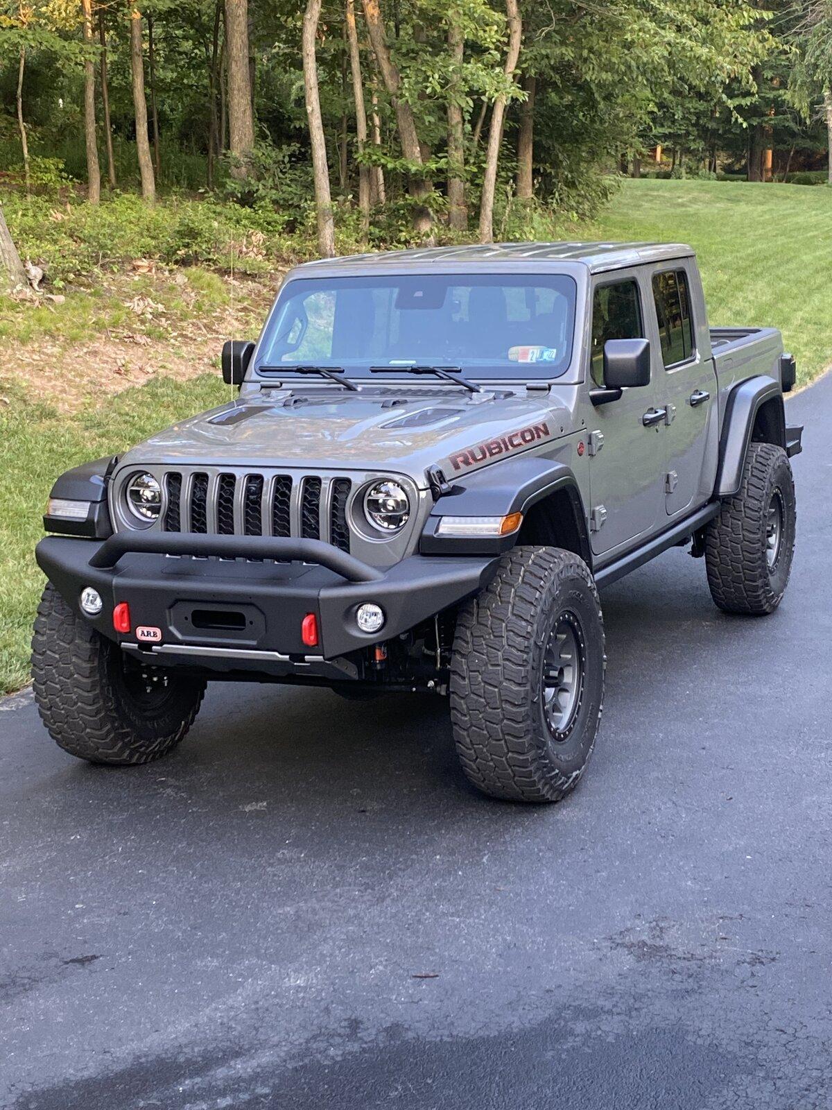

thanks man - appreciate the compliment.

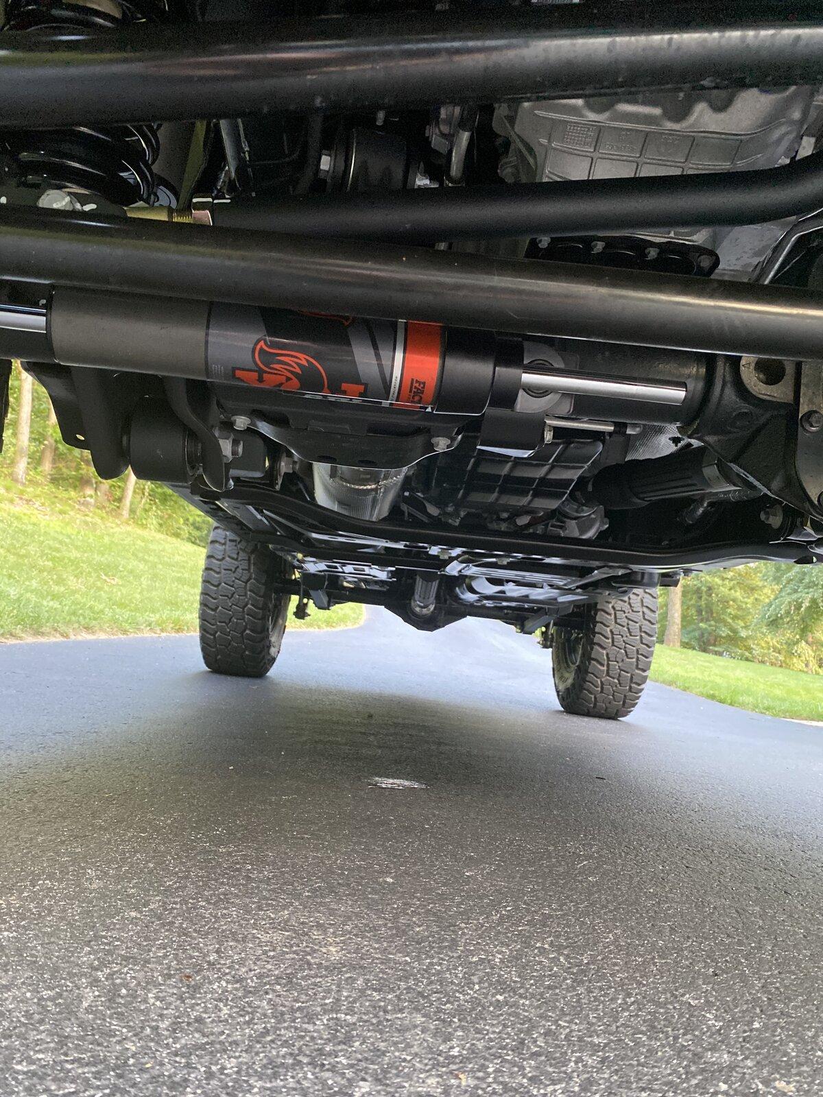

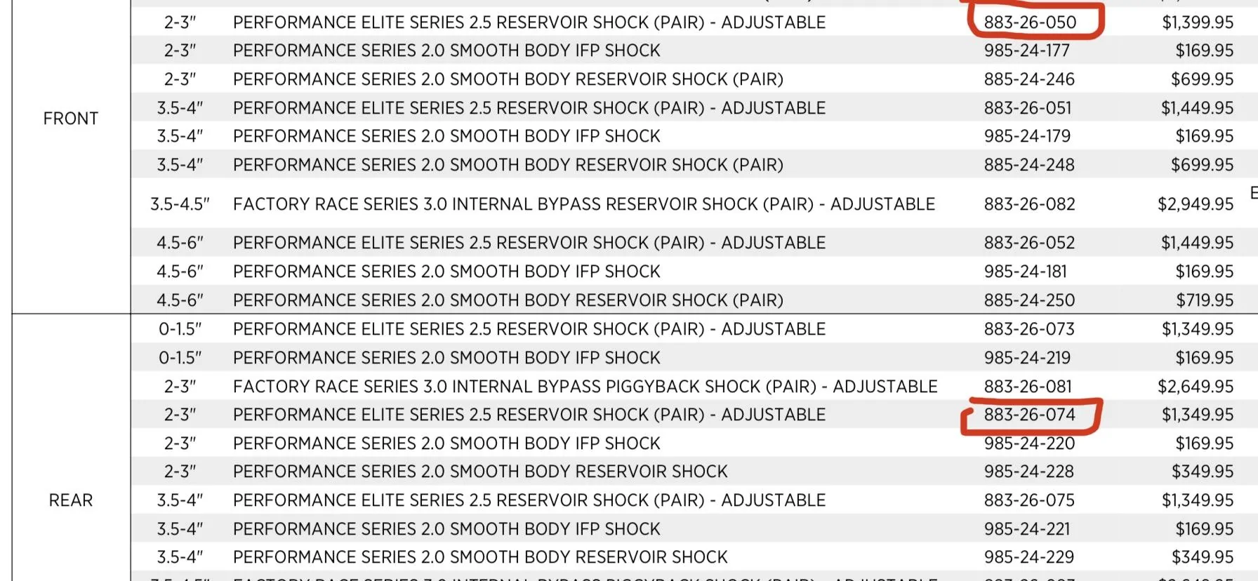

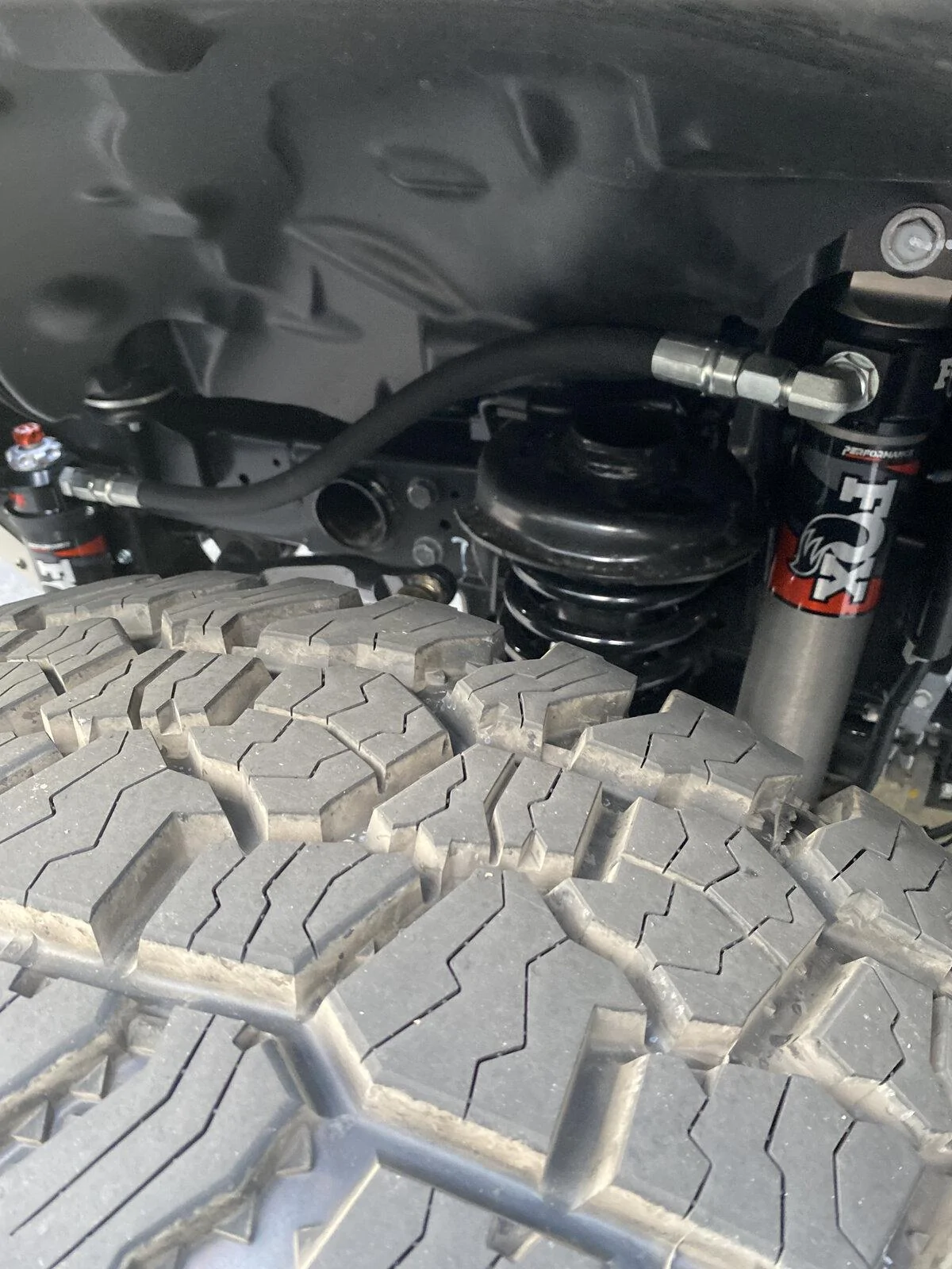

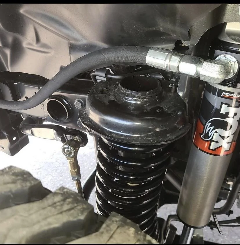

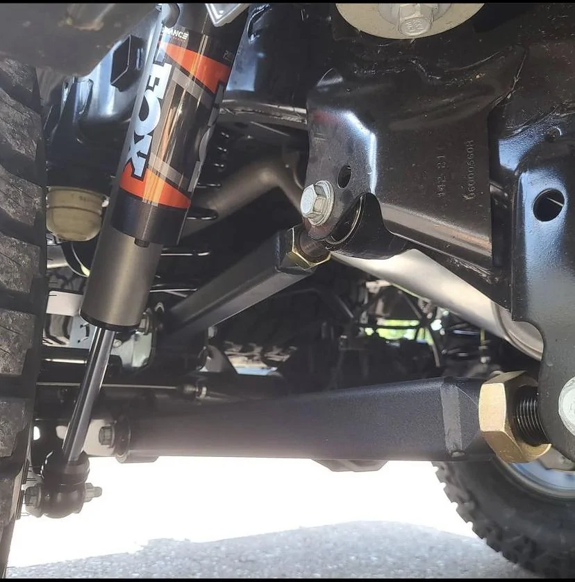

I have the Fox Perf Elite 2.5 Reservoir Adj. Shocks. They pair really well with the Clayton kit. The Falcons were $1,700 for all four. But, the diesel version of that shock was not in stock anywhere. Teraflex wouldn’t even give an estimate when they would be available. So, I got the Fox 2.5 and happy that I did. All four are $2,750 but I really like the quality and the ride

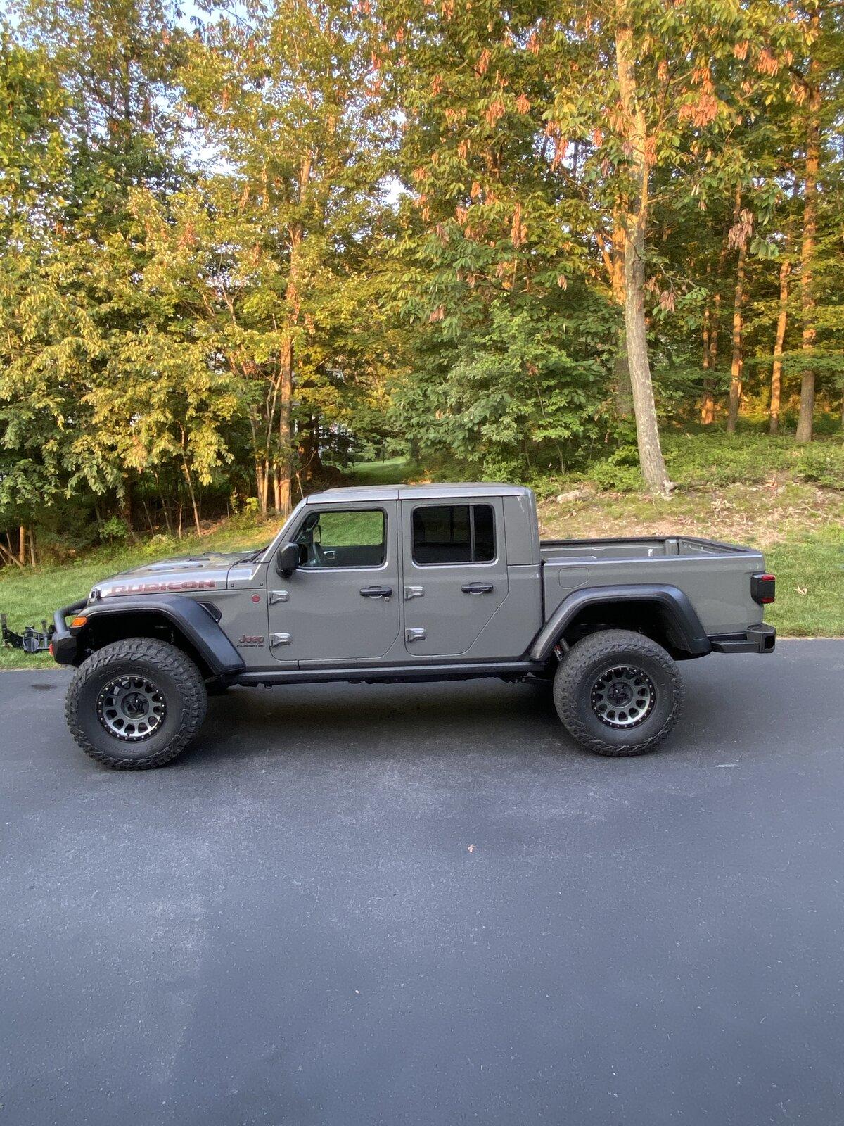

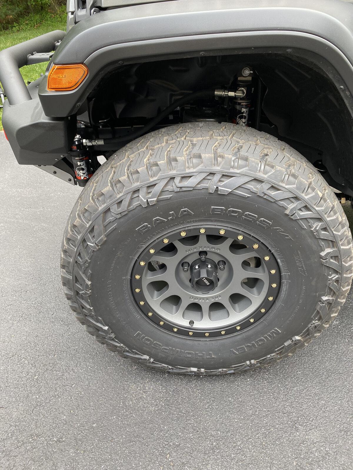

height to the top of roof is 77”

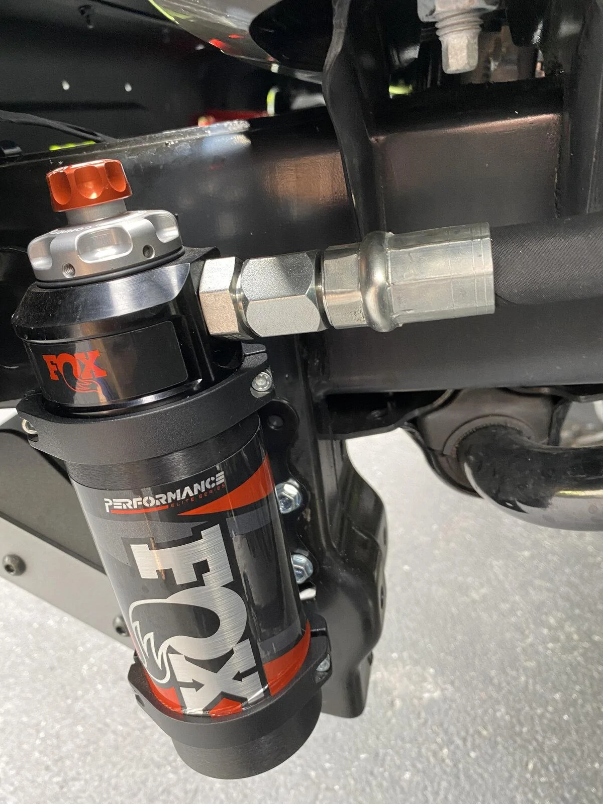

Nope. Not rated for diesel at all. They are rated by the amount of lift (range given by Fox is 2-3”).
yes, they independently adjustable for both low speed and high speed at each corner. In fact, I could barely find any information about how to tune these damn things. Google, YouTube, this forum, even Fox’s own website - nuthin!! So, I called and got some great information.
you can adjust all in about 2-mins with no tools while you’re in a parking lot!
On Road: High = 3 / Low = 6
Off Road: High = 6 / Low = 3
