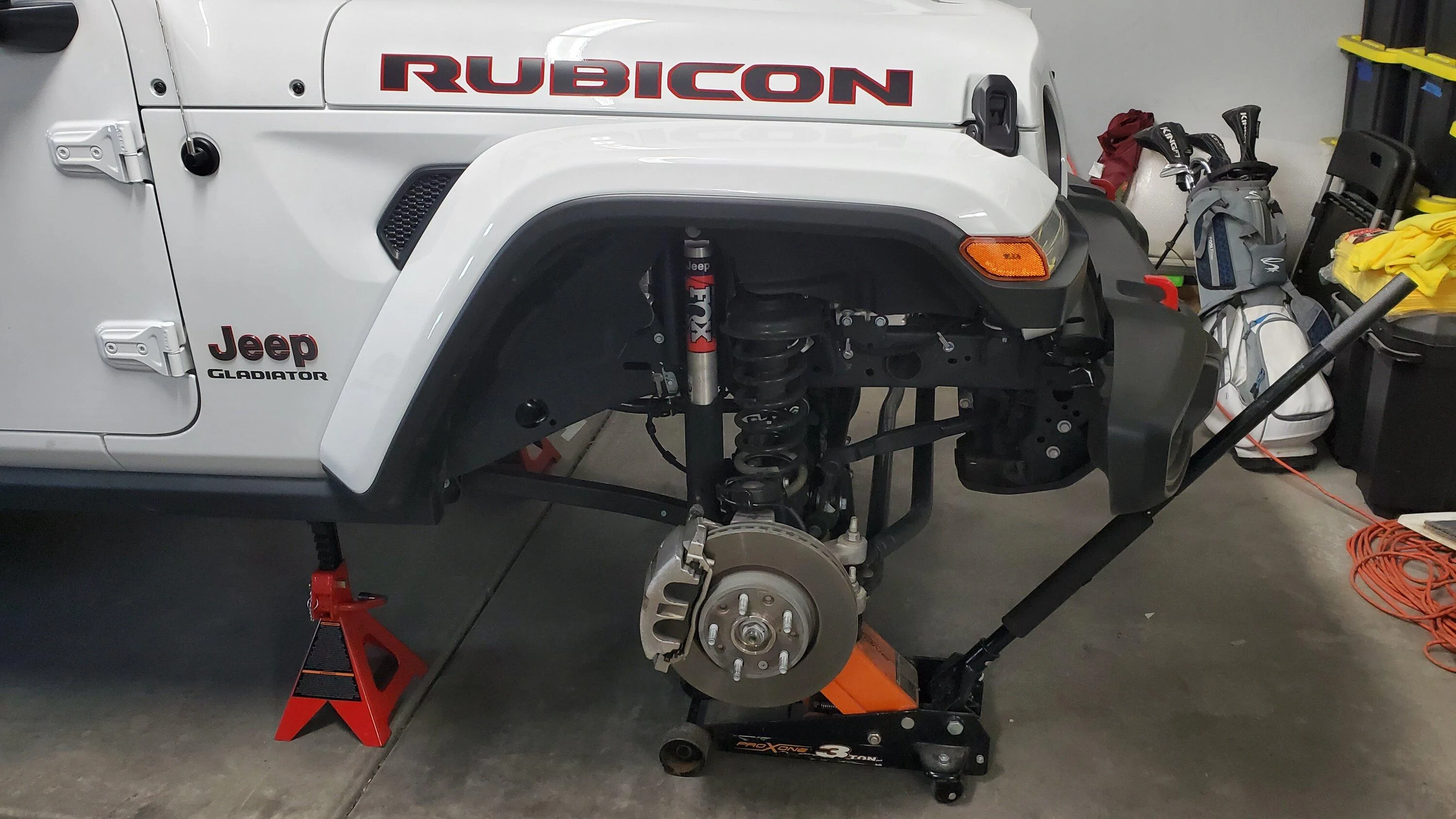

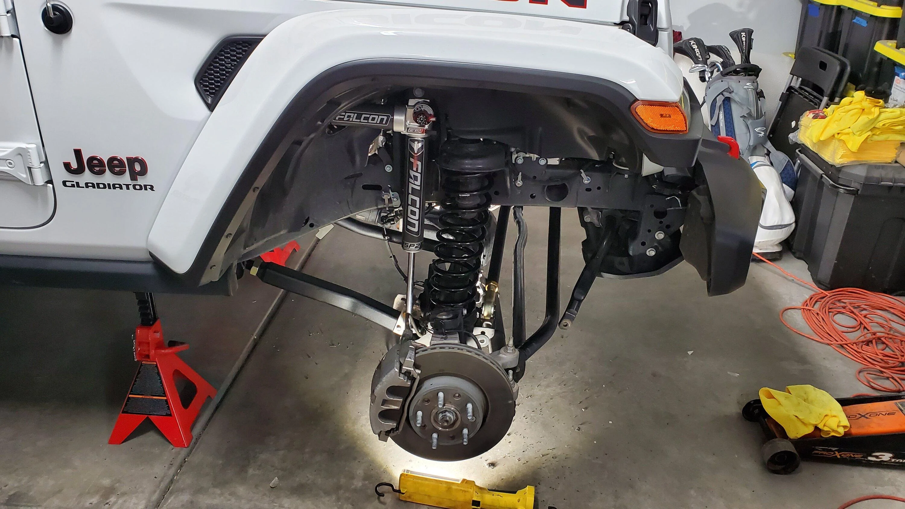

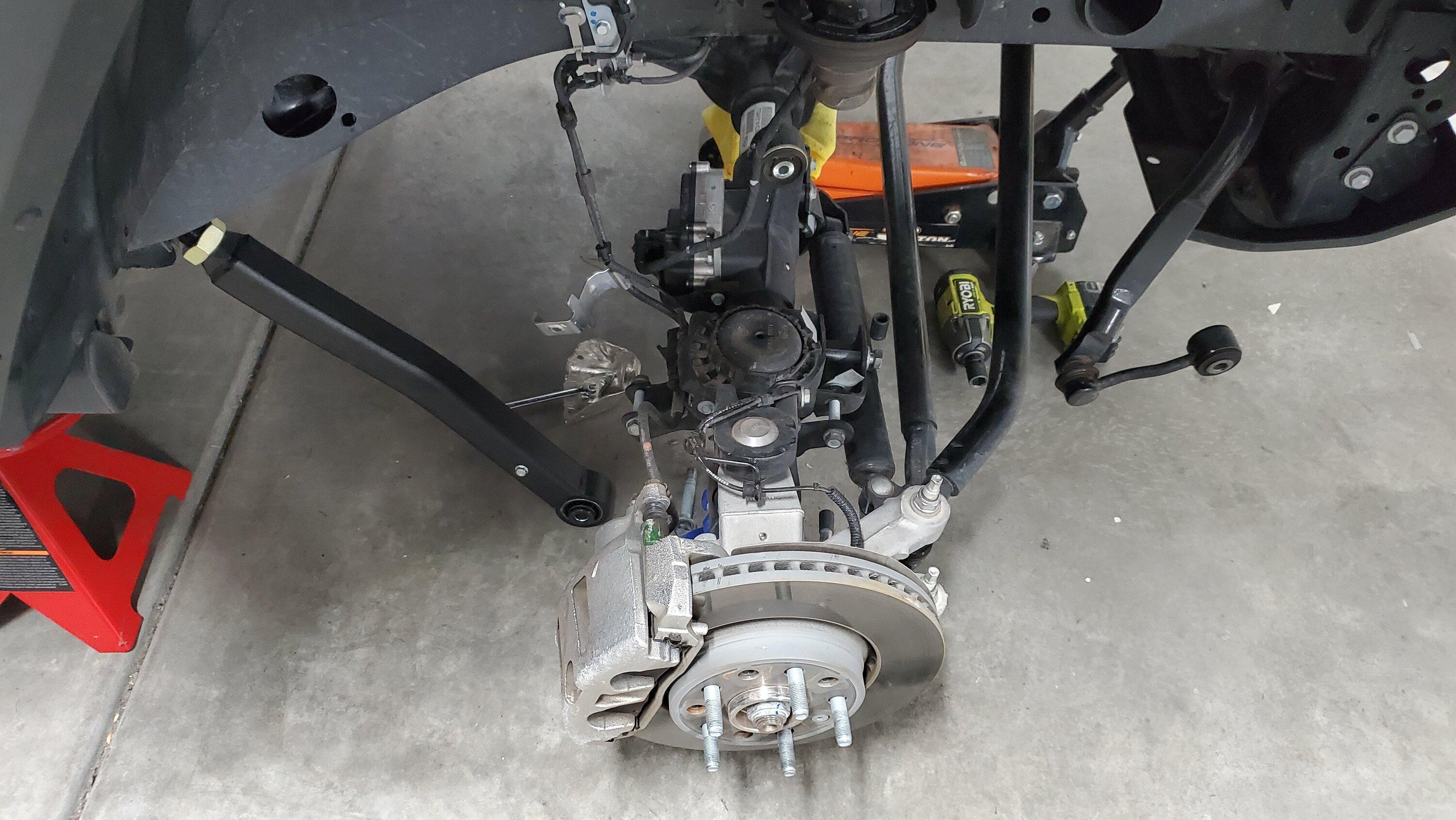

So I just started my 3.5" Overland + install a couple of nights ago (just putting in a couple of hours each night and taking my time). I'm currently doing the install with tow large jack stands and one small one as well as the jack. I've put in numerous lifts in the past and haven't really run into many issues with this one. I will say though that the instructions could be a bit better. Pictures instead of diagrams would go a long ways towards making this install fool proof.
Check your front bump stop hole fitment prior to drilling. They mention drilling it out in the instructions, but mine fit without needing to. Also, for the front control arm extension brackets, I did have to drill those out a bit to fit and that wasn't discussed in the instructions.
Not sure what shocks you decided to go with, but with the Falcon 3.3s, they were tough to get into the lower shock mounts and line up with both sides of the bolt. Took some effort to get them there with the jack. Also, I didn't see it in the instructions, but you will need to use the new front lower shock bolts that are provided. They should be packed with the lower control arms.
If I recall correctly, you will mostly use an 10mm, 14mm, 18mm, 19mm, 21mm, and a 22mm socket/wrench. The lower control arm inside frame nut size is a 24mm. A battery powered impact gun was a great item to have to break loose the factory torqued nuts.
Oh, you will also need an large allen wrench for the bump stops. I believe it was an 8mm one. Do not mount the bump stops before putting on your springs. You will put the bump stop inside the springs when putting them on. You can secure the bump stop inside the spring with string or a zip tie. You might be able to get it up there by just holding it in with your hand as well. I don't have a pic of that but JK Gears and Gadgets did it the same way.

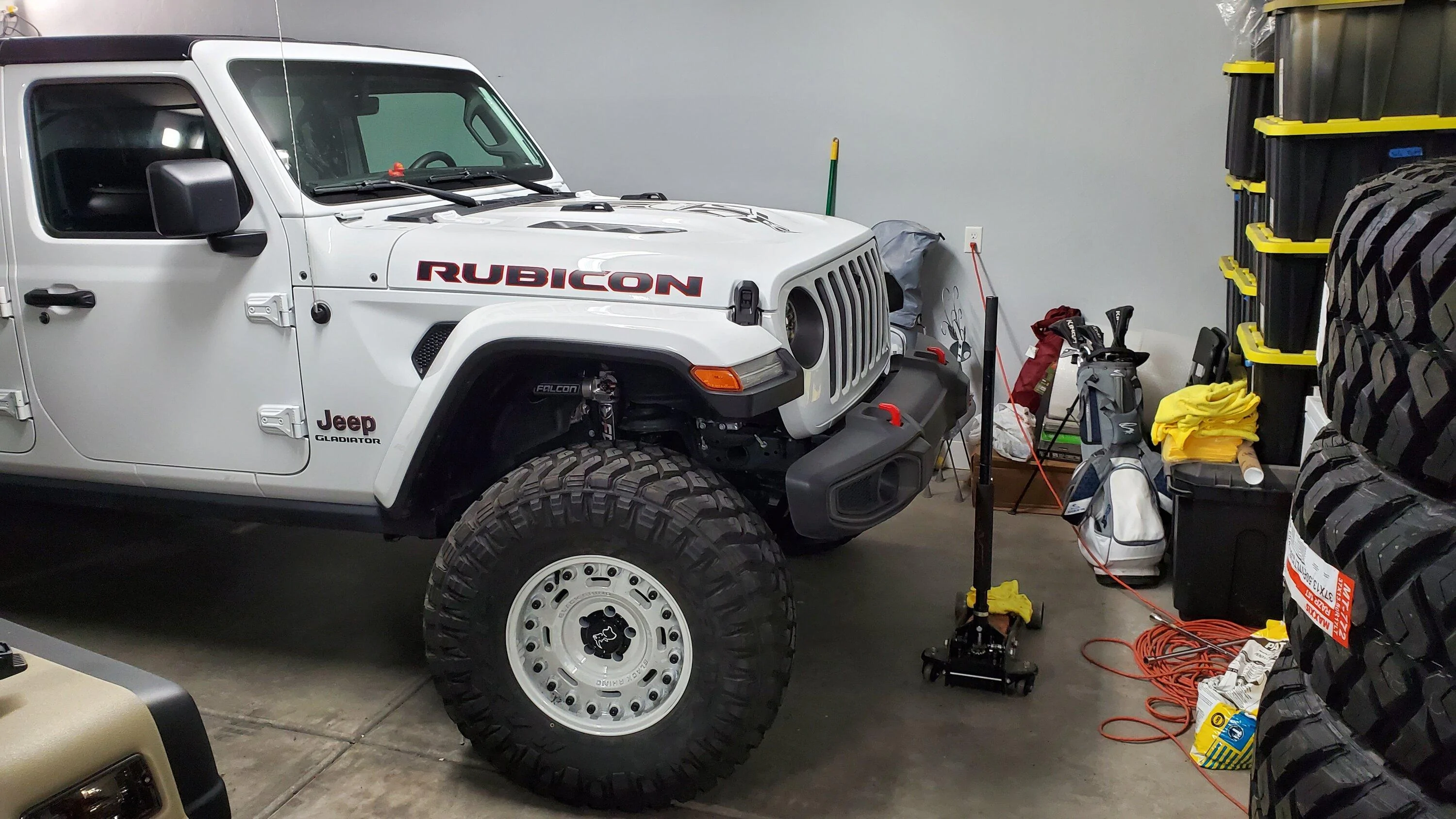

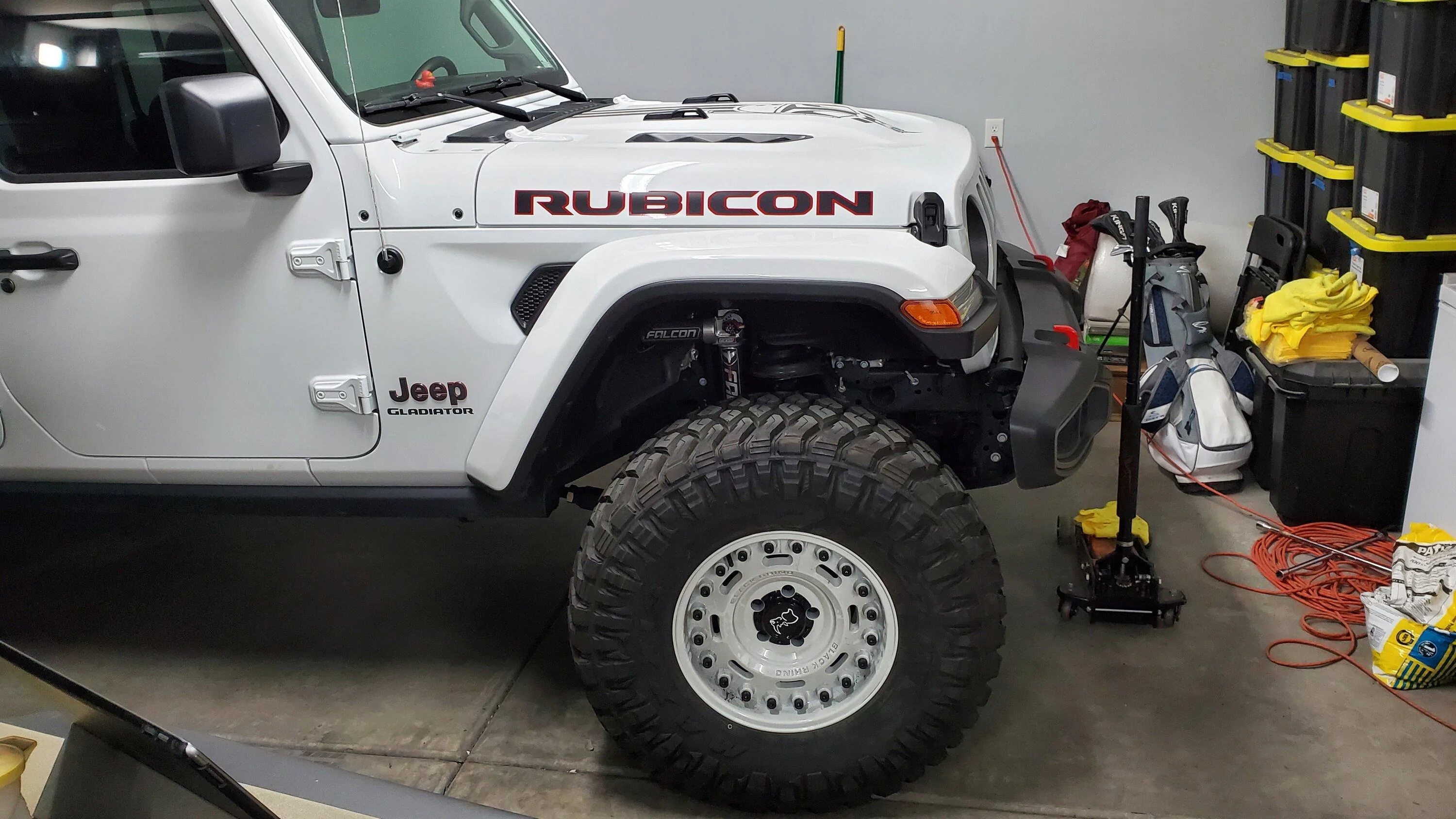

Wow, thats a hefty upgrade. I did go with the same Falcons as you so I appreciate that tip as well. I know you said you took your time, did you do everything solo? How much total time do you extimate it took you. How long have you had the lift on? How bad was your alignment off? How does it ride now? What size tires and wheel specs? I got some Nitto Ridge Grapplers 37 x 12.50 on Method 17 x 8.5 with 0 offset. Can you post a pic of finished product? Any before/after pics? Damn I'm asking alot.
I've done everything solo so far. Front took me maybe 3.5 hours so far. I still need to measure and cut the sway bar links and torque everything down. I've only worked on the front so far, starting the rear tonight so don't have any info on alignment or how it rides just yet. Wheels are Black Rhino Axle 17x9.5 5x5" -18mm and tires are Maxxis RAZR M/T 37x13.50. I've got a before pic, but not an after pic yet ;) From the before to current though, you can tell there is quite a bit of added front wheel gap.
