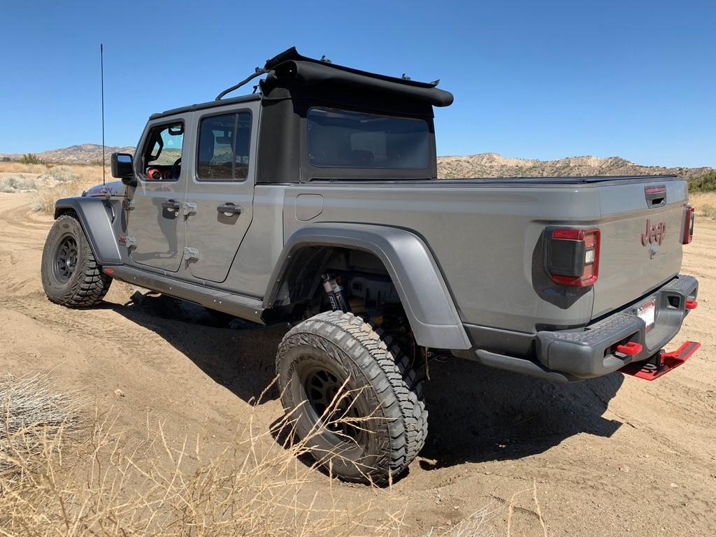

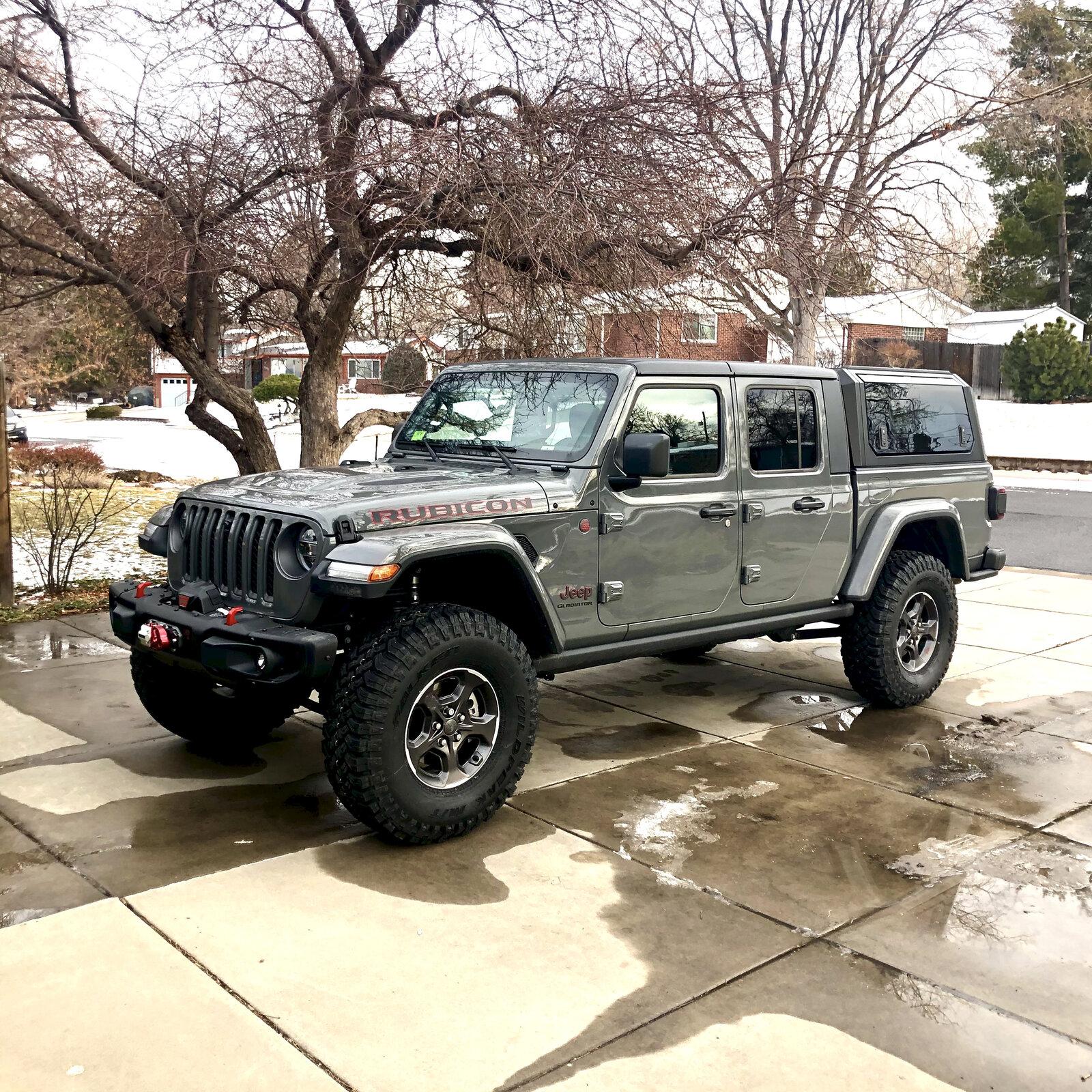

Clayton 2.5 measures more like 3 with 37 Nittos. Has falcon shocks now and I think it rides better than stock.
Awesome! This is exactly what I wanted to hear and see. Looks great!

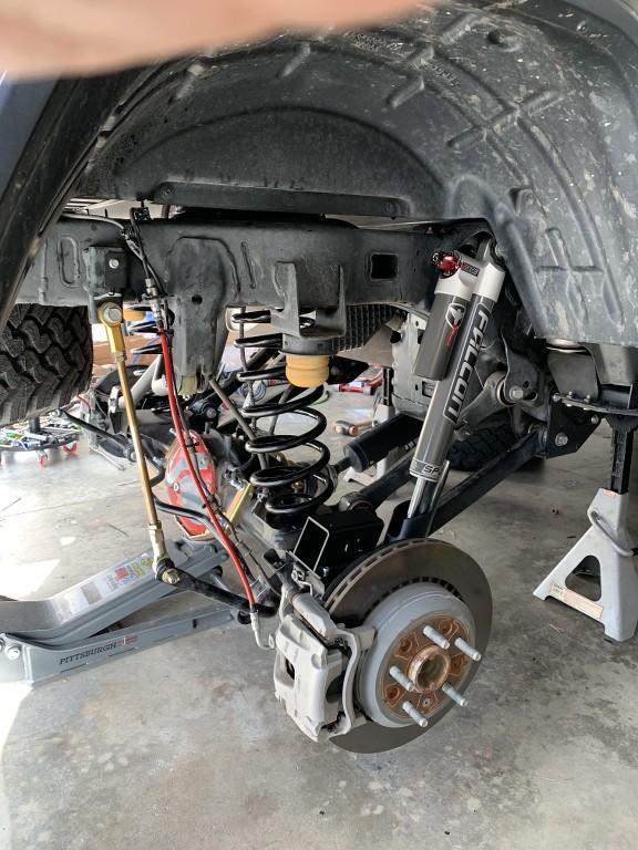

Anyone with the Overland 2.5 have length issues with the rear brake and wheel sensor wires? Just finished installing and while up on lift the rear brake lines were uncomfortably tight and I couldn't connect the wheel speed sensor wires until I put truck on its wheels. I know this is only when rear is unsupported, but will it be an issue at full flex? More importantly, did I install something wrong?

I have the 3.5" Overland plus kit and I put in the new longer brake lines from Clayton (red). If you loosen the anti-lock sensor wire mounts on top of the frame, you can get as much slack as the Clayton lengthened brake lines. Here is a pic where I got as much slack as the brake lines, then, zip tied them to the brake line at the same mount points as the stock brake line.
So, your only real problem is the length of the brake lines. If your shocks are long enough to let you tighten the brake lines at full droop, then, tell Clayton to send you the brake line extensions. The anti-lock sensor lines should not be a problem to lengthen once you pull out the wire mounts.

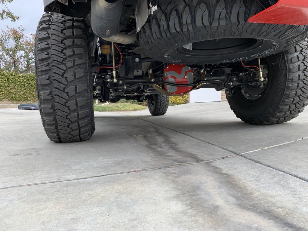

Here is another pic at rest... You can see the anti-lock sensor line slack is just as much as the new Clayton brake lines. They are zip tied together in this pic also.

Awesome. I figured I'd order the lengthened brake lines. Didn't know what to do with wiring. I'll look for the wire mounts.

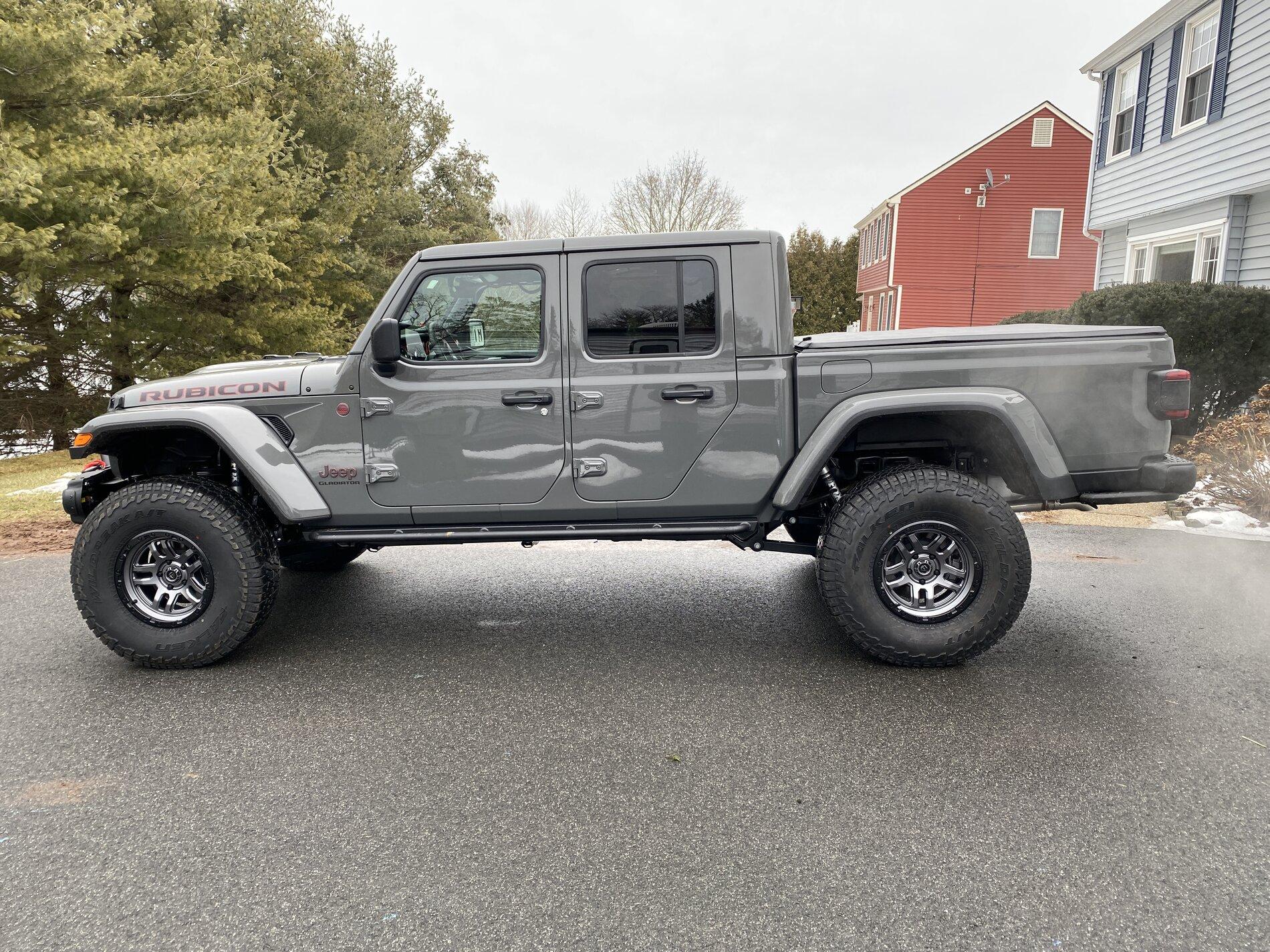

Clayton 2.5" Overland Plus with Falcon SP2 3.3 shocks
