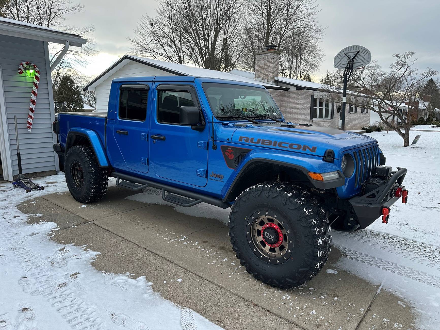

Hello everyone! My son and I will be installing the Clayton 3.5 Overland plus lift on my 2023 Gladiator Rubicon in a couple of weeks. I know there is a plethora of knowledge here, so I figured that I would ask if anyone has any advice or tips, or tricks they might pass on before I attempt. I put a 2.5 Skyjacker level kit on it and have installed a 4-inch lift on my TJ, so I do have basic knowledge of how to do this, but I want to see what everyone has to say. Also will be adding the Fox 2.0 shocks and Fox 2.0 TS Steering Stabilizer. Thanks and Semper FI!
