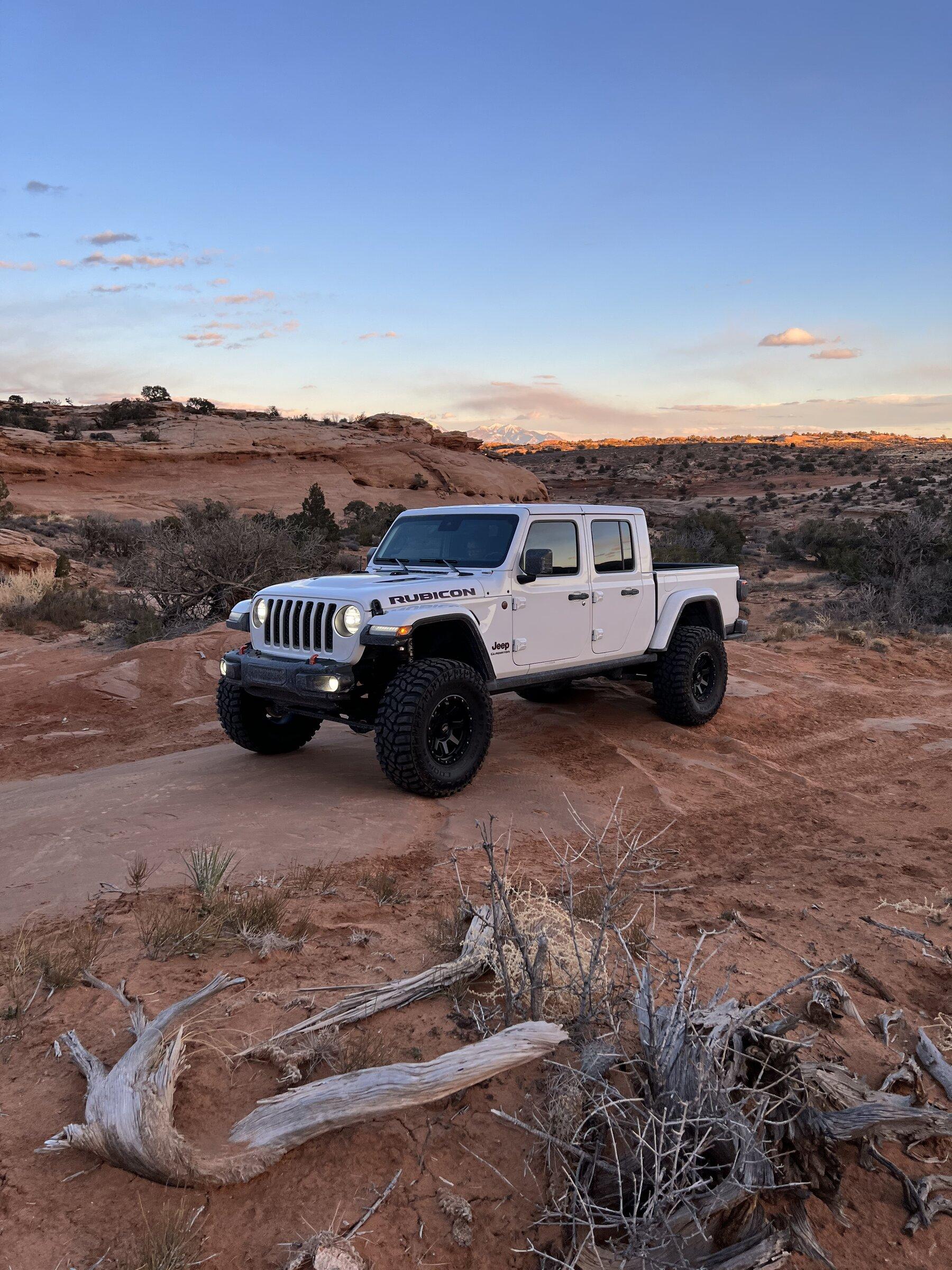

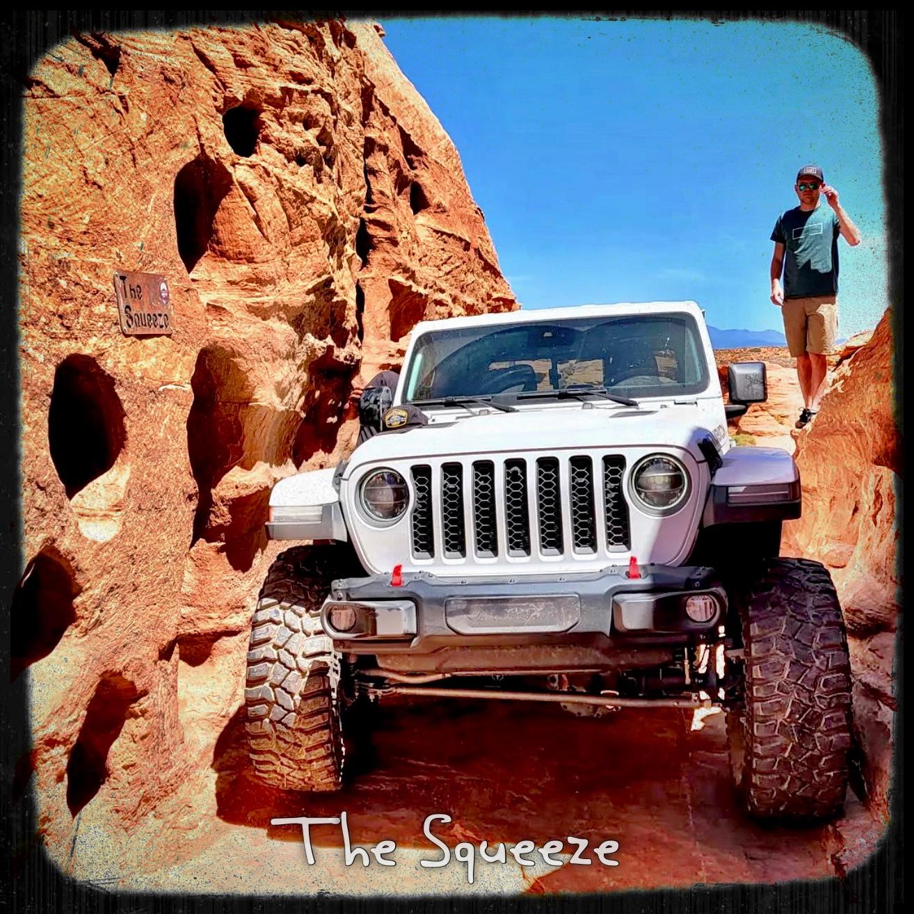

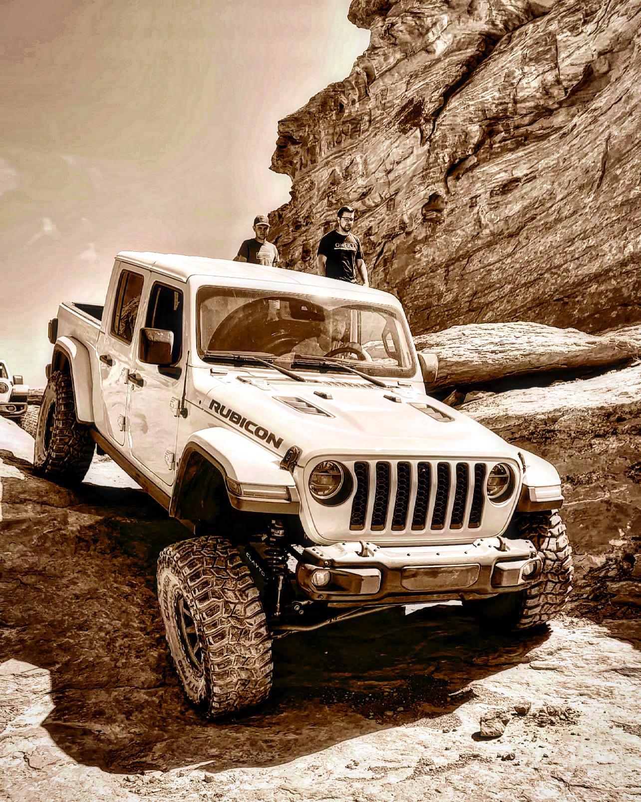

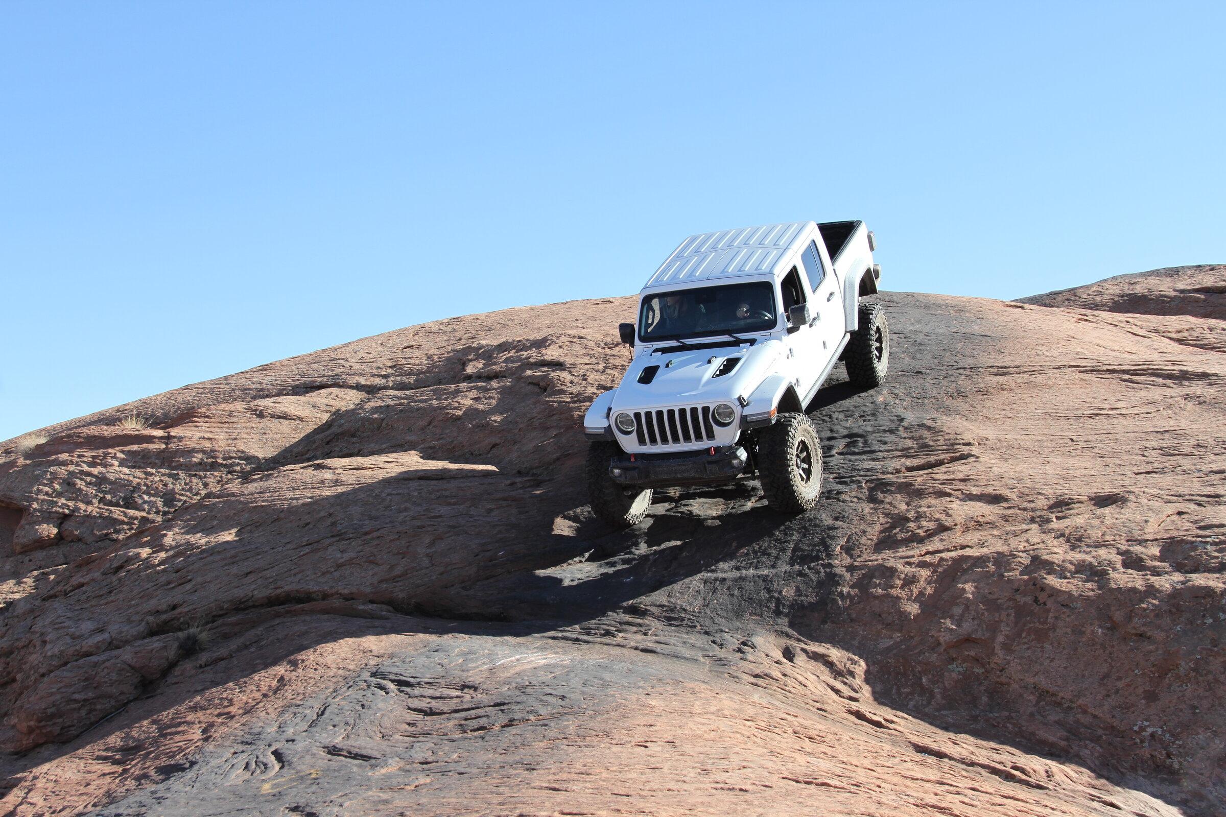

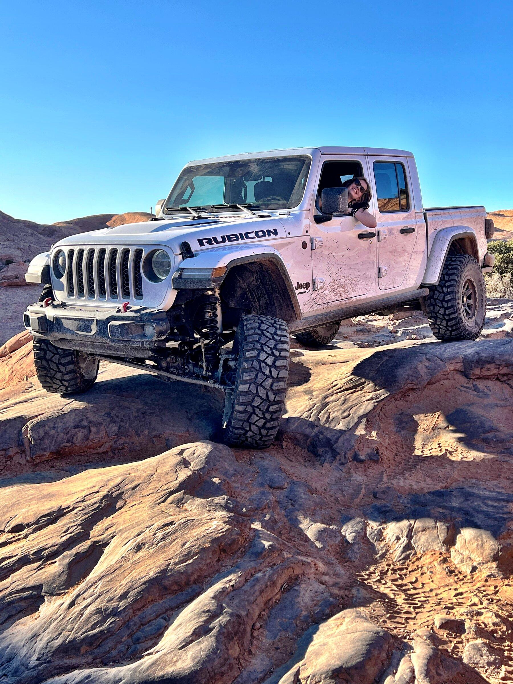

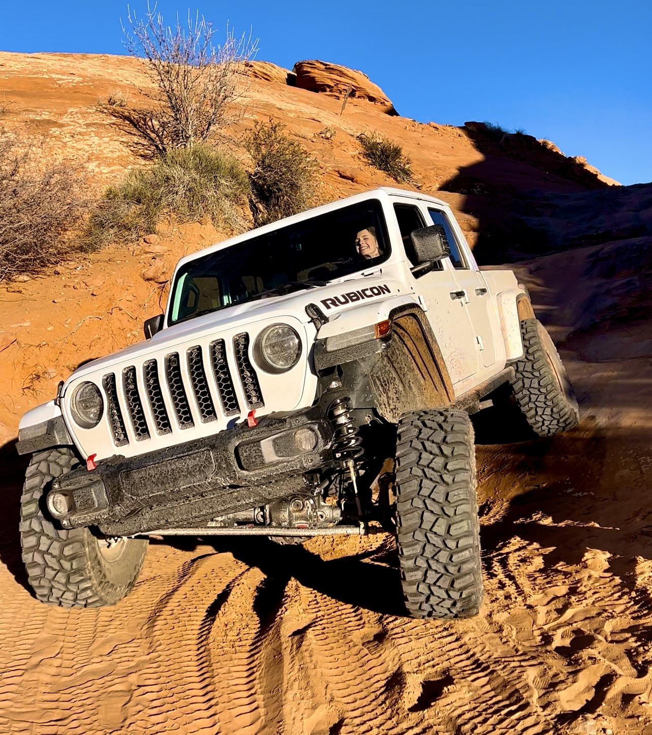

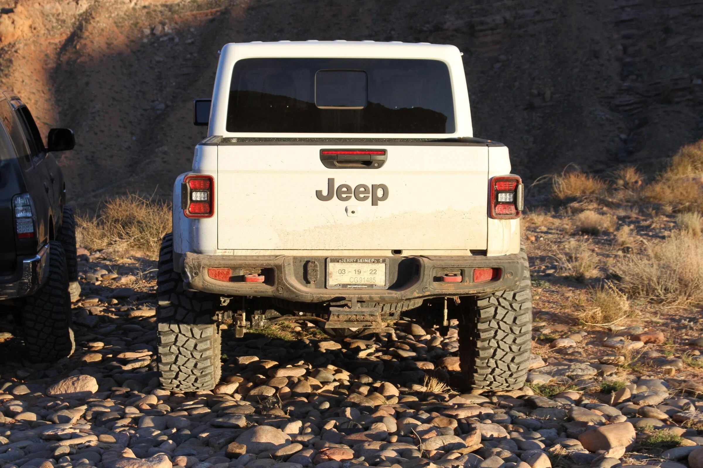

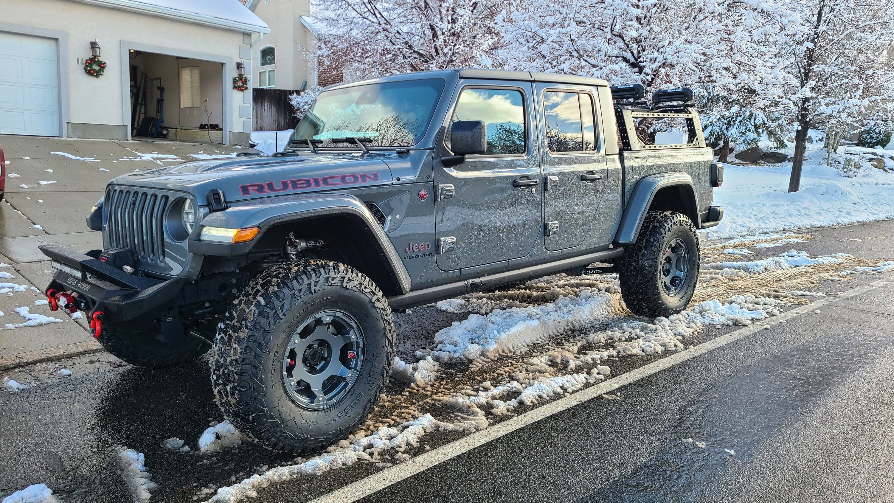

I’m running the Clayton 3.5 overland plus kit on my 2021 JT Rubicon. Cooper discoverer STT Pro 37x13.5 17’s tires. Rock trix 17x9 +12 et, or 5.5 BS wheels. I’ve ran multiple trails in Moab and Sand Hollow with zero rubbing at all. It’s an awesome kit! I just wish my Falcon’s weren’t on back order…
Truck looks great! Which Falcon shocks did you order? Most Falcons showed up last week :)

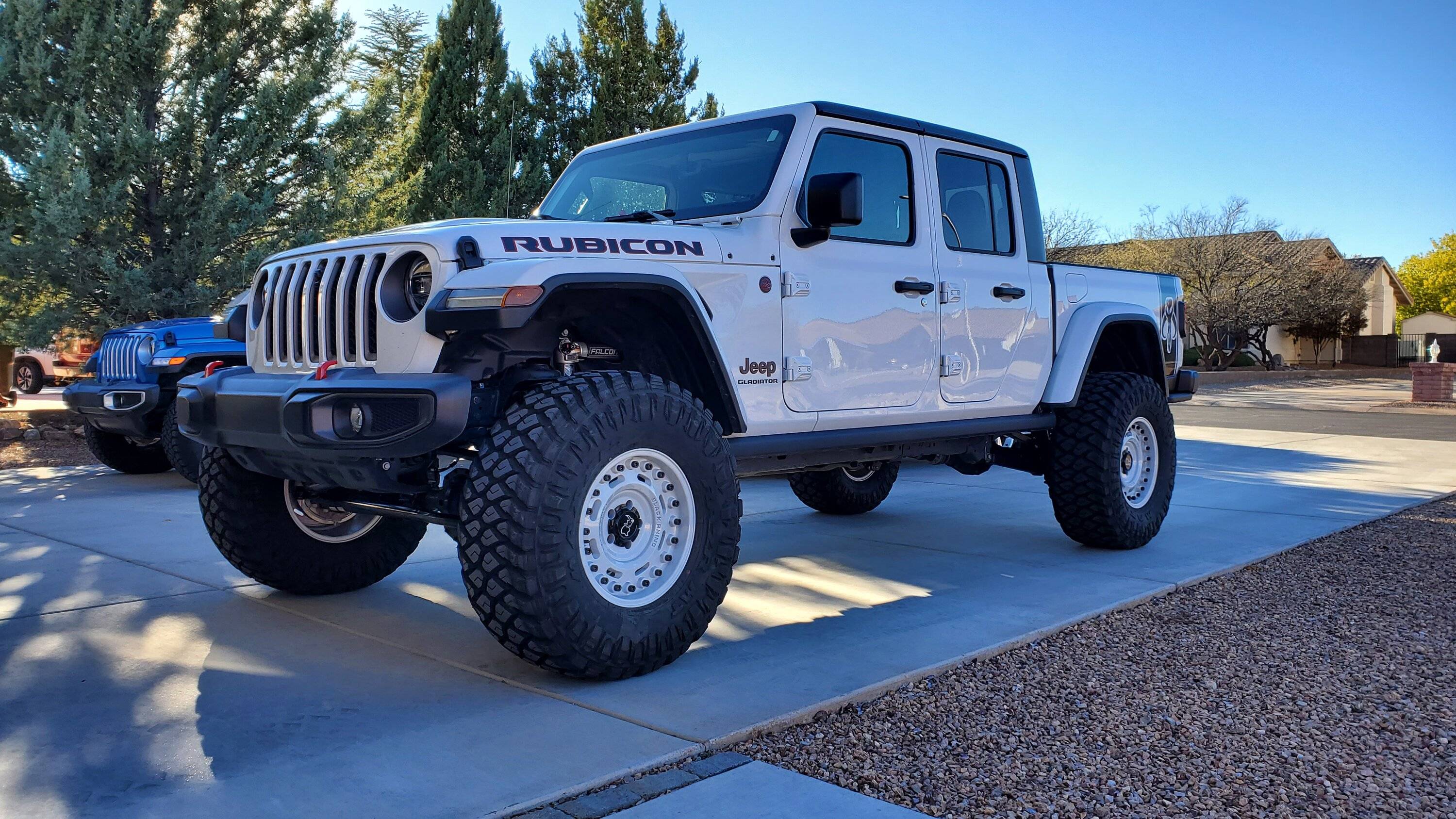

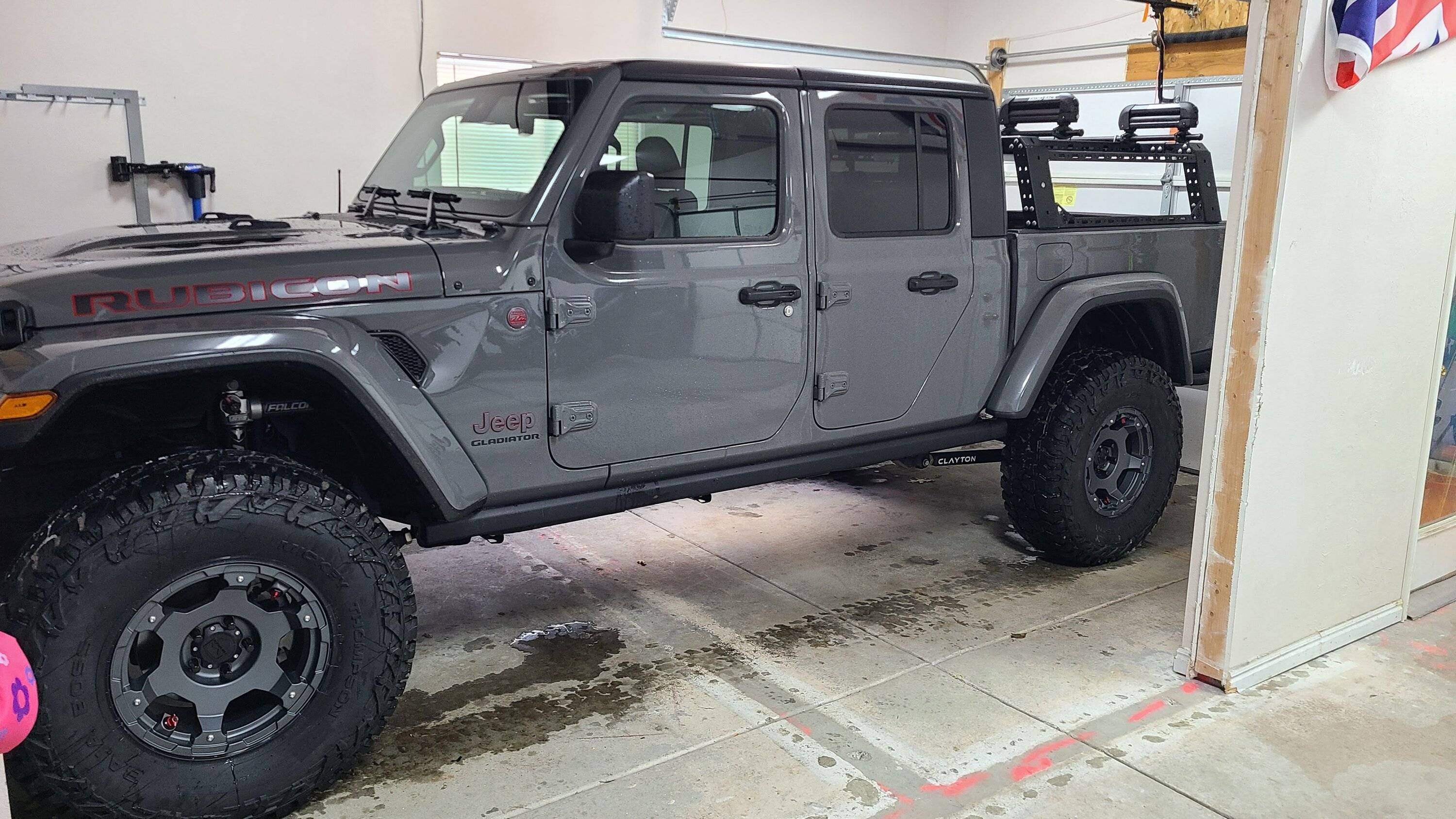

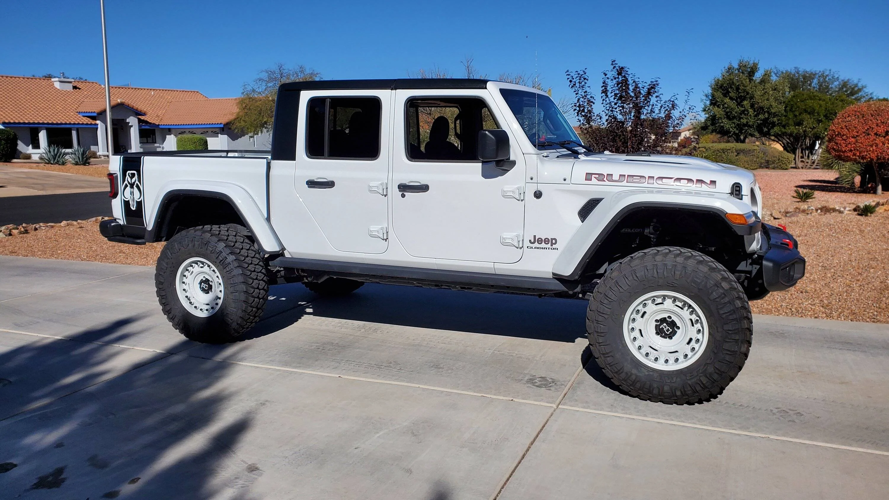

I just wanted to show off my 2.5 Overland+ that I finished Tuesday. The 2.5 definitely sits higher than I thought it would. I was concerned that I should go to the 3.5 as the 2.5 wouldn't be tall enough. As mentioned previously, the 2.5 is probably closer to a 3/3.5 inch lift. It will be perfect to keep weight lower but give more ground clearance and enable the 37s. Sorry, I didn't take before and after measurements. It's in getting aligned right now but so far I am really happy I went with the 2.5.

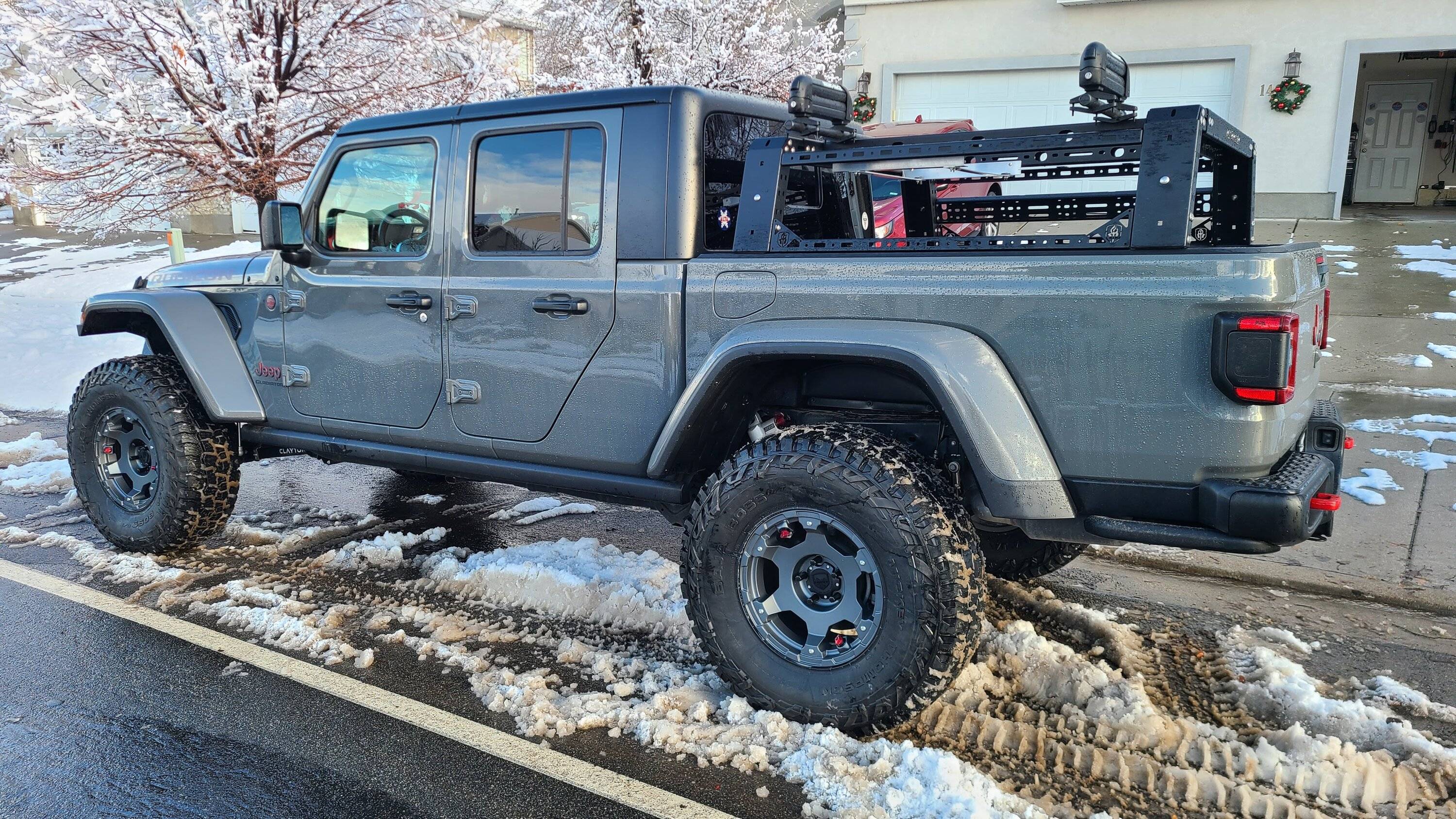

Got the 2.5 Clayton lift with the heavier rear springs it clears 37 inch sst pros just fine. I believe Clayton rates their lifts under full load so 2.5 inches of lift is when it’s loaded, you will have close to 3.5 without much weight in it.
Looks great! Our kits do tend to sit about 1/2" taller than advertised, and this if of course when measuring from the rear, as the front end is where some of the factory rake is removed so more height is gained.
We actually don't design the heights based on added weight, it's just that our kits are designed to be about 1/2" taller than advertised. For example, the 2.5" kit is really closer to 3" when measuring from the rear, if you measure from the front, you'll measure about 3.5" because that's where we removed about 1" of factory rake. Hope this helps clarify!

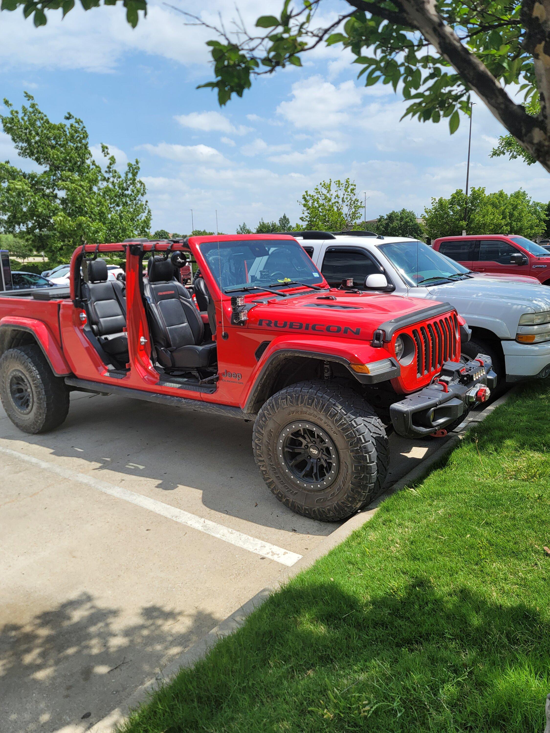

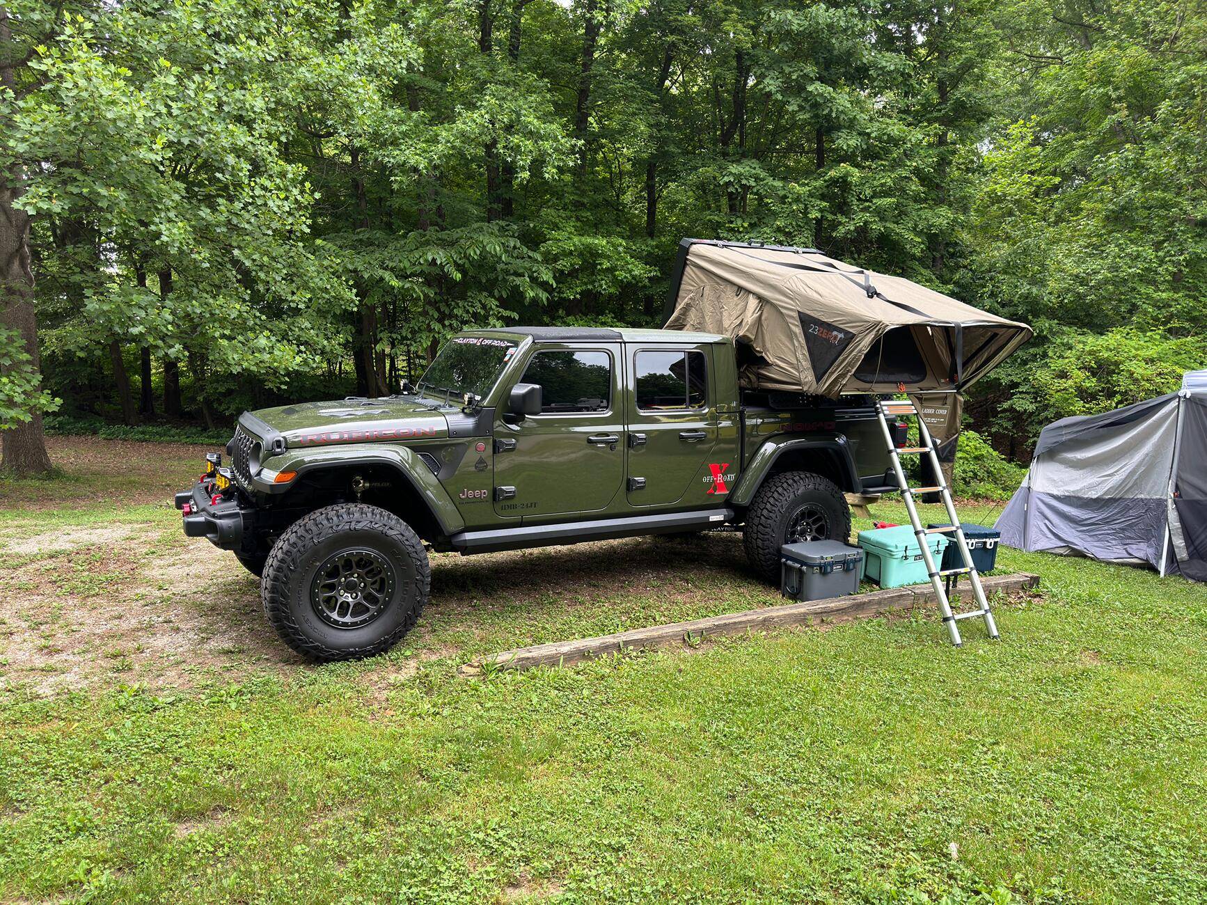

Hello Clayton @claytonoffroad. I was I believe the first ā€˜24 Gladiator to install your 3.5 ā€œ Overland lift. The shop took pics and videos for you. My question is, I have a kind of knocking sound when I hit bumps and it’s something within the suspension, but I canā€˜t figure it out. I’ve crawled all over it, checked torque specs, but haven’t seen anything out of the ordinary. It drives fine; it’s just that annoying knocking sound. Any ideas?

My setup…..
